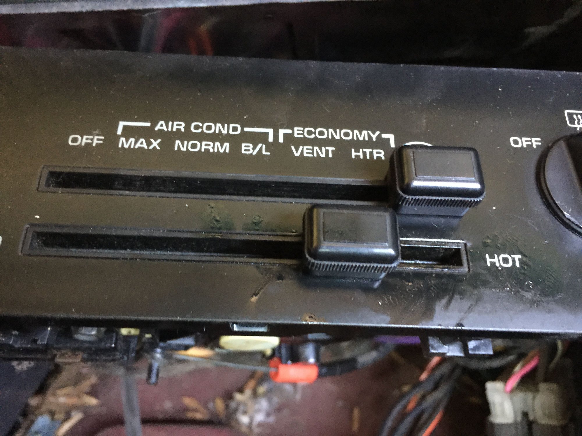

So my climate control slider is stuck on my '85. It's on heat. I don't necessarily need AC, but I'd like to stop it from venting heat into the cab for now (I'll actually fix it later). Can someone help me accomplish this? Is it an easy job to just close the heater door?

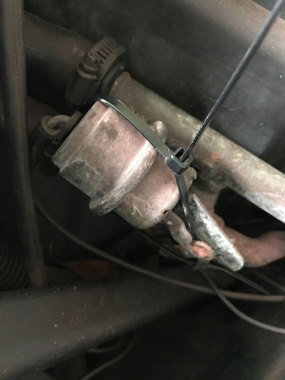

What about this? This valve redirects the coolant from the heater core, right? So if I zip tie it, it will not have the hot coolant running through the heater core, right? Or am I crazy?
This is a temp fix obviously. I need to REALLY fix the climate control soon. It just might be a week or two before I can actually tear apart the dash to actually fix it.

So, from everything I've read, the Heater Control Valve in a 1985 ONLY controls the flow of coolant into the heater core, right? And it's controlled by vacuum? So if I 'fake' the vacuum by holding it closed with a zip tie, I'm not going to break anything, right? Coolant simply won't flow into the heater core?
Just wanting to check before I destroy something...

Just an update-closing this valve accomplished nothing for me. Looks like I'm going to be fixing the HVAC soon...

It sounds like you've actually got MANUAL AC when you mention "slider". That's a cable operated function that could either be repaired or defeated.
Is your AC manual?
There's a select rotary switch also that could effect function.

it is manual HVAC. His car is a 1985 and there was no C 68 option in 1985.

If that vacuum solenoid is pulled all the way, that should shut off the flow of coolant to the heater core.

My manual AC slider is completely stuck. I'm going to have to take stuff apart to figure out where the hold up is. I'm guessing either the cable is shot or the heater door is stuck open. At least I know my heat works! Lol. I'm guessing(hoping) the AC will work once I get the slider unstuck.

You're probably right. I think there are multiple issues. The valve isn't working right-even zip tied closed there is still heat flowing. The controls are also stuck, so something is going wrong there as well. As always with this car, I don't think there is a simple answer.

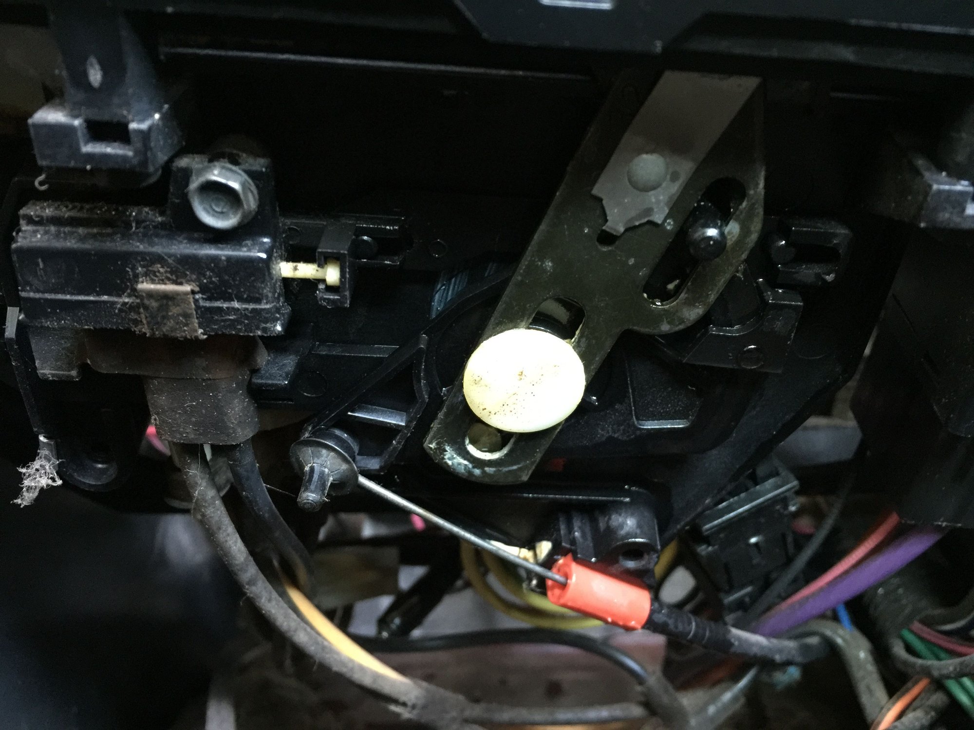

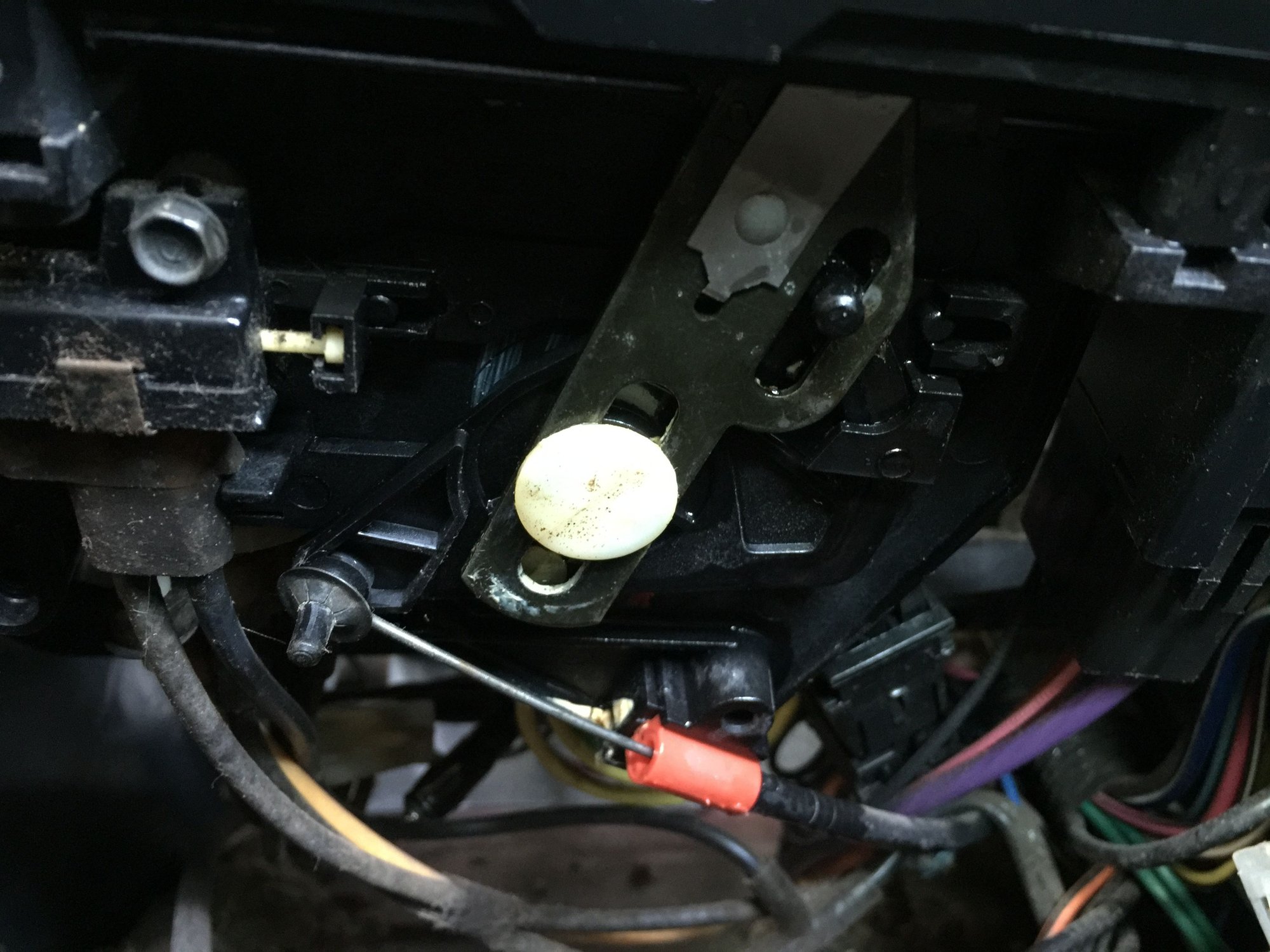

I took the control unit out of the dash finally. It's still well and truly stuck. I sprayed some WD 40 on everything, no different. It doesn't look rusted. Something is just stuck. I don't even think it's the cable-it looks ok to me and doesn't feel like the issue. Attaching pics-anyone have any idea?

im sure you have done this but havr you tried pulling the and moving the canle by hand?
also, from doing my heater core i remember the blend door. maybe the hinge down at the blend door is rusted.
you could remove the heater box cover from inside and check.
have you checked if the lever is rusted in the hvac control box?

i tried moving the cable by hand-hard to grip it though so not sure that is conclusive.
The blend door is what I'm afraid of. From hearing everyone talk it will be a PITA. I was hoping it was something simple with the controls. It really feels like the lever itself is jammed, but I could be mistaken.
The blend door door is next on my list if the controls aren't the issue.
What do you mean would be rusted in the control box? Is that what I sent pictures of? If so it looks pretty clean actually. A little gunk but nothing I'd expect to cause it to freeze up.
On on the bottom it looks like there is a small box with a vac line going to it. There's a plastic arm coming out of that box that I can't tell but might be blocking the slider from moving. They at least seem to be connected. Could that be it?

Took the whole thing apart. The linkage cable appears to have been the issue. I can move the blend door manually. Anyone know where I can get a new linkage cable?
