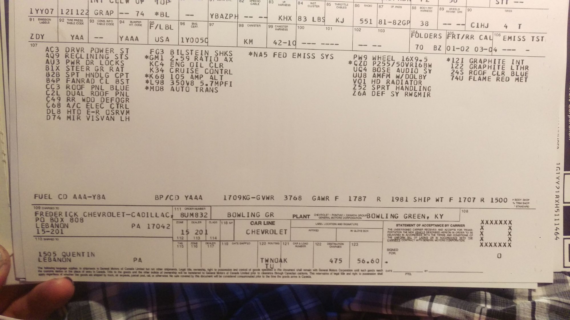

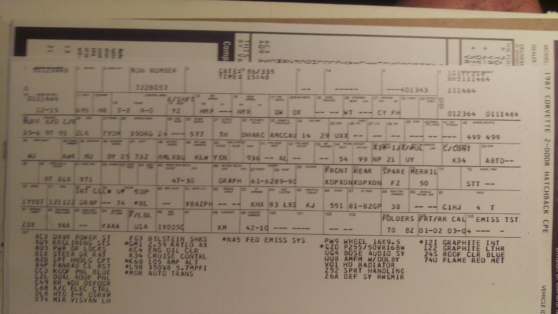

1987 Corvette Z52 option with FG3 option see my build sheet and window sticker.... Looking for matching oem shocks BILSTEIN SHOCKS... thank you

bilstein hd is what u r after.

Thanks got the HD...
