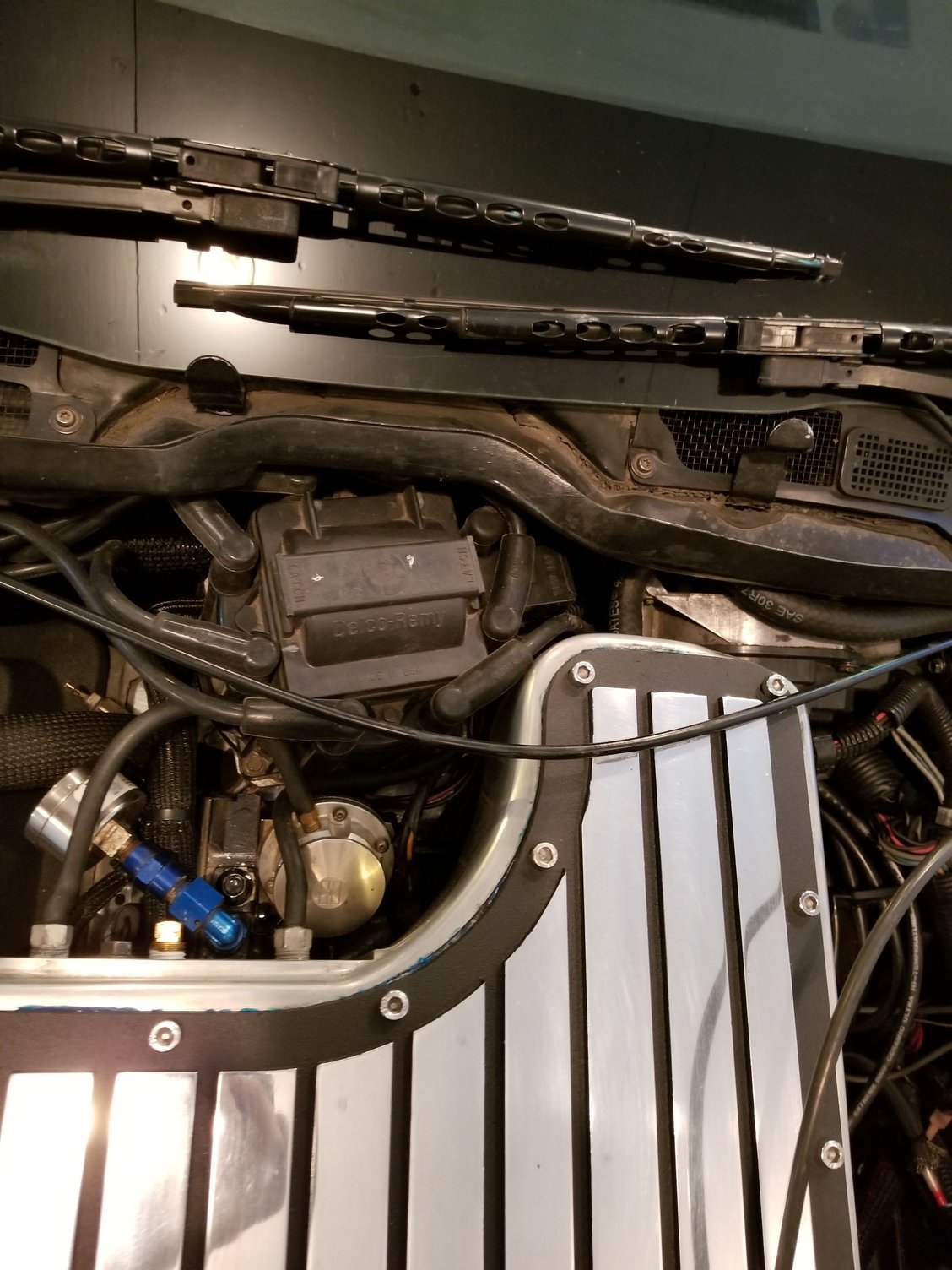

Also, they dont look at all like what I expected so I wonder if this has the right cap on it? It currently has a black plug in the back and then maybe these two on the front?
Looks like five wires total?
Theyve all been spliced which throws off the colors but the rear ones are brown and yellow into the factory plug.

+1 to "de-bubbaing" as much as you can. It'll definitely save you headaches later on. As to what that distributer wiring should look like I'll let somebody with a pre-oopti car chime in

taylor send a msg over to dmittz and ask him for a pic of the distributor instaled with respect to the super ram.
i should have twigged on this before but maybe the PO couldnt get the dizzy facing the stock direction and had to rotate it 180deg. which then meant he had to extend the harness to get that extra couple inches.

I think the plug on the cap would hit the back of the plenum so I think you are right. One of the wires was just electrical taped together lol. came right apart. Strange thing is I cant get it to run even using jumpers.
I need to find the coil wiring diagram.

I JUST realized looking at your distributor pictures your distributor is out 180degrees. That is proabbly why the harness was extended by the previous owner.
If you refer to my pictures above, you'll see I am using the stock distributor, and it still fits ok behind the super ram in the correct orientation.
I installed the runners and plenum with the distributor already in place, I did have to take the cap off of it to get the one plenum bolt tightened down but other than that I had no issues using it in the stock orientation.

Are these the only plugs into the coil from the harness?

Those aren't correct for your "coil in cap" HEI. Those look to be for a TBI etc that used a remote coil.
I ain't never used one of these but it might be ideal particularly with you rewiring some of your car. Originally there would have been a single spade for coil and another for the tach lead. This looks to be a "one and done".
http://www.jegs.com/i/Accel/110/170072/10002/-1
Here's OE if you actually wanted to do singles. You can do singles for less locally I'd think and i just added the link for the "image" to compare.
http://www.jegs.com/i/JEGS-Performan...10552/10002/-1

12v and a tach lead... guess its enough to not let the car start?

i'm not sure if I have ever seen this, but I would suggest going with the OEM set up with two separate plugs in the event that one of them alone needs to be removed for some sort of diagnoses in the future.
