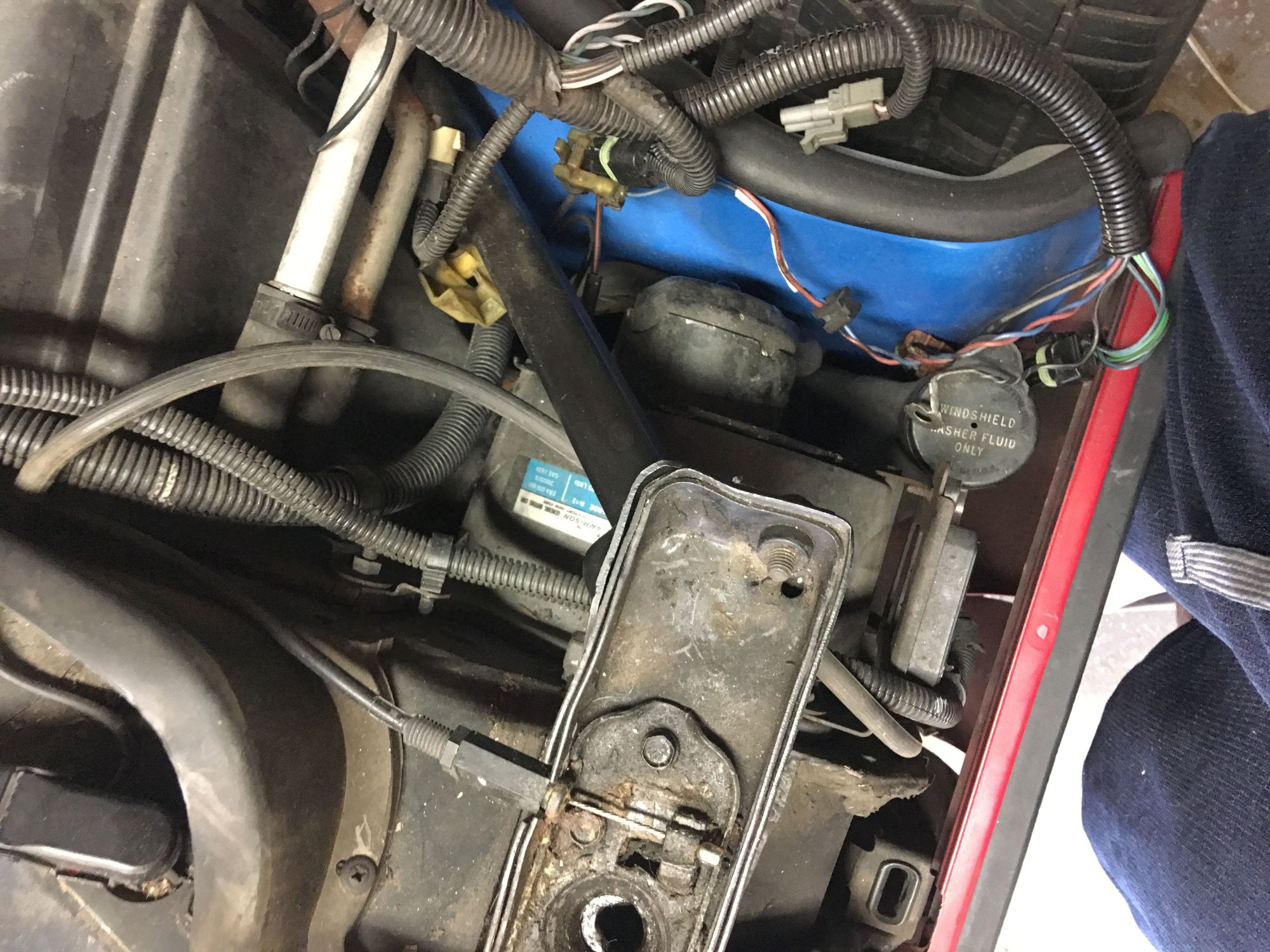

Posts: 47
Valves a lil loose
Valve hitting pushing up on metal
All these tabs are being hit by the rockers

Posts: 47
Low and behold these garbage valve covers caused the valves not to open properly now time to put everything together😁

Posts: 47
I put them on upside down my bad . I know this engine inside and out simple mistake. Anybody know how to use this fuel regulator.
These valve covers weren't garbage before they were used wrong. Were these valve covers installed upside down? Who put these roller rockers on this engine without checking clearances? Have you found any bent pushrods? There's no way the valve covers would cause the valves not to open properly, unless you've got a bunch of bent pushrods! Being on only one side of the engine leads me to suspect the upside-down valve cover and bent pushrods. You CAN'T blame "garbage valve covers"!
Bent pushrods will cause loose valves. You need help from someone who knows engines. Are you having fun yet?
