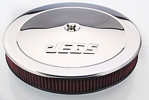

I'll see how it runs without the rebuild. But plan on rebuilding carb anyways. As for the air filter what do you suggest in terms of a better one seems I will have to cut a hole in the hood either way

Taylor Allen's Avatar
Taylor Allen
Joined: May 2017
Posts: 64
From: Cleveland Ohio
anything like a standard drop base air cleaner? available at nearly any autozone, etc
http://www.jegs.com/p/JEGS-Performan...51908/10002/-1
AAAAHHH? Why?
Unless your goal is to modify the hood, there is no reason to cut a hole in the hood.
The 80 and 81s used a carb set up as you have, so the clearance is allready accounted for. The air cleaner in your photo is not (not) even remotely compatible.
Get something like Taylor suggests and put the Saws-all back in the box.
