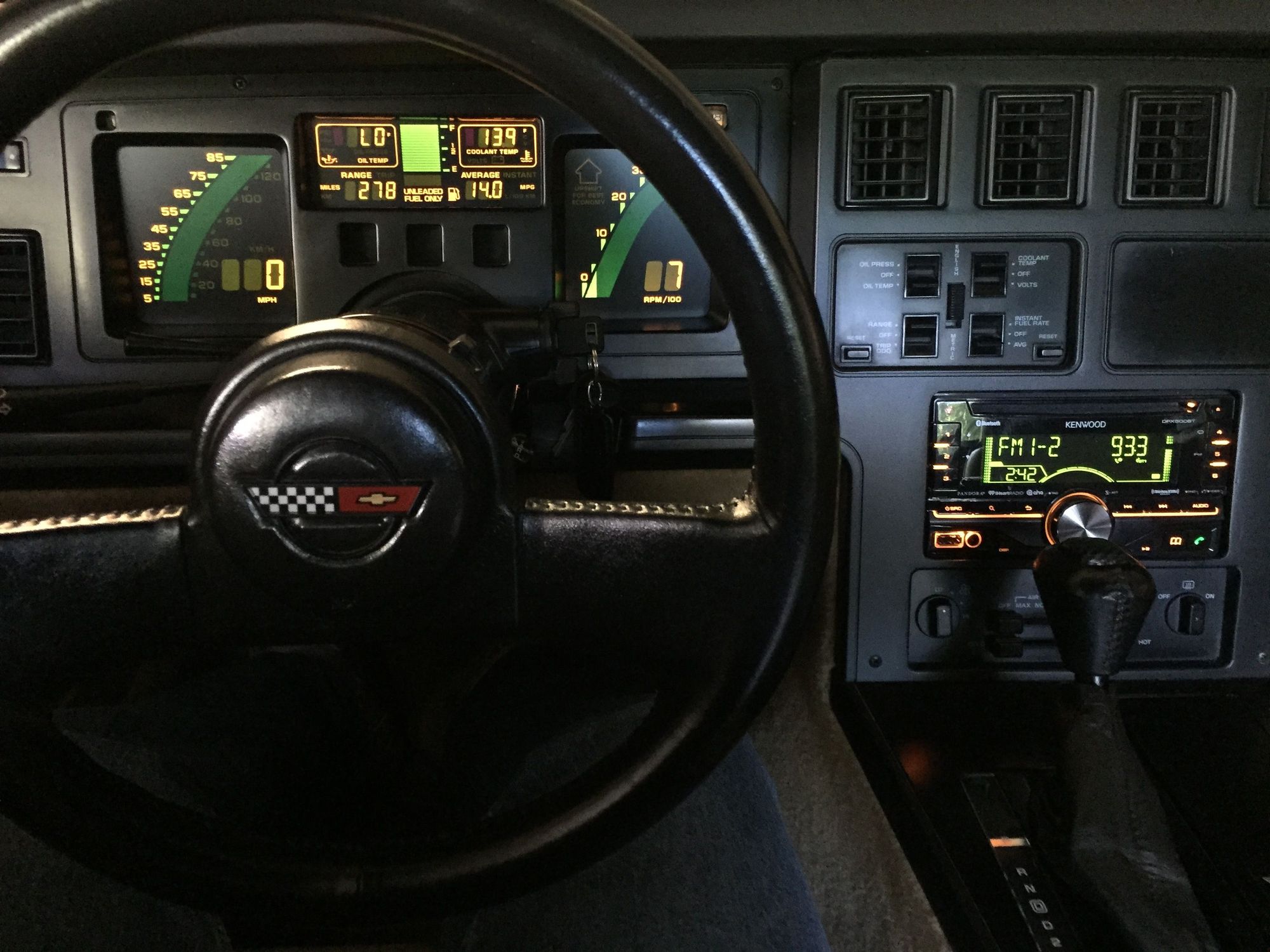

If the early C4 in your avatar picture is what you have the cutout for the radio is 1.5 din. You can put a double din in with modification.

The bezel you can buy. There's a vendor on here that used to make them. I think the name is double d mods?? That or my mind is in the gutter. Lol. I cut mine then filled and shaped it with a poly filler. The other piece that needs modification is the inner bracket inside the dash behind the radio. It's formed to fit the 1.5 din so you need to trim it so that the double din headunit will fit inside. For easy wiring I purchased the metra wiring harness so that the headunit would just plug into the factory harness. Be warned, space to cram the wiring is tight. Overall it wasn't that bad of a project but the fit and finish aspect of it is the time consuming part of it.

WOW! That looks amazing. The color of the display matches the dash gauges.

If I didn't know C4's I would have said that was the stock stereo (almost), good job on the install!
