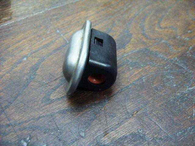

What is the pulsator made of? Rubber or something that you slip over the ends. If it gets loose from age, where does the fuel from the pump go? Back to the tank so you won't notice anything BUT you lose fuel pressure. If you use some sort of fuel hose, it might not work since it may not be designed to be submerged. So it holds fuel inside the hose but outside can attack the rubber.

It was metal like the original. It did seem kinda loose though now that I think of it. I'm gonna order the Racetronix stock upgrade with the Walbro pump, looks to have everything I need but I think I may order this also from corvettemods.

It would look like the what was in the picture below. It goes between the pipe on the pump assembly and the pump outlet.

Yep, that's a pulsator, exactly what I replaced. You think replacing it with a section of submersible hose would be better? Many seem to do it.
