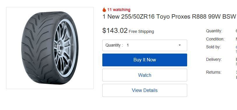

I love the Toyo 888 and they grip good in the rain but great on dry. They make the
Nascar tire sound a little around 39=40mph but nothing aver 40.
