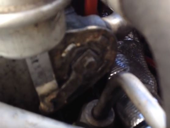

Found out yesterday that the lever arm that is screwed into the valve is very rusty. So I lubed it. Then the screw came out due to the rust had eaten away at the mounting hole. So now the lever arm needs to be remounted so it can work.
Another day in paradise.

I attached the lever arm to the solenoid and to the valve. Everything works fine. But NOW I see that the valve is leaking where the arm attaches, thus this is what caused the rust to form in first place.
Is there any fix for this or do I have to find a new valve?

Belairbrian and Whalepirot have identified the right part, but there are alternatives for this expensive part. Some have successfully rebuilt their heater valve by carefully extracting the core out of their original valve, and installing the core from p/n 74800. I was planning to do this mod, but when I figured out how the 74800 valve works, I found that I could use the entire valve as-is, to replace my original valve! Here's a link to my procedure. The hoses are even the correct sizes!
https://www.corvetteforum.com/forums...ter-valve.html
