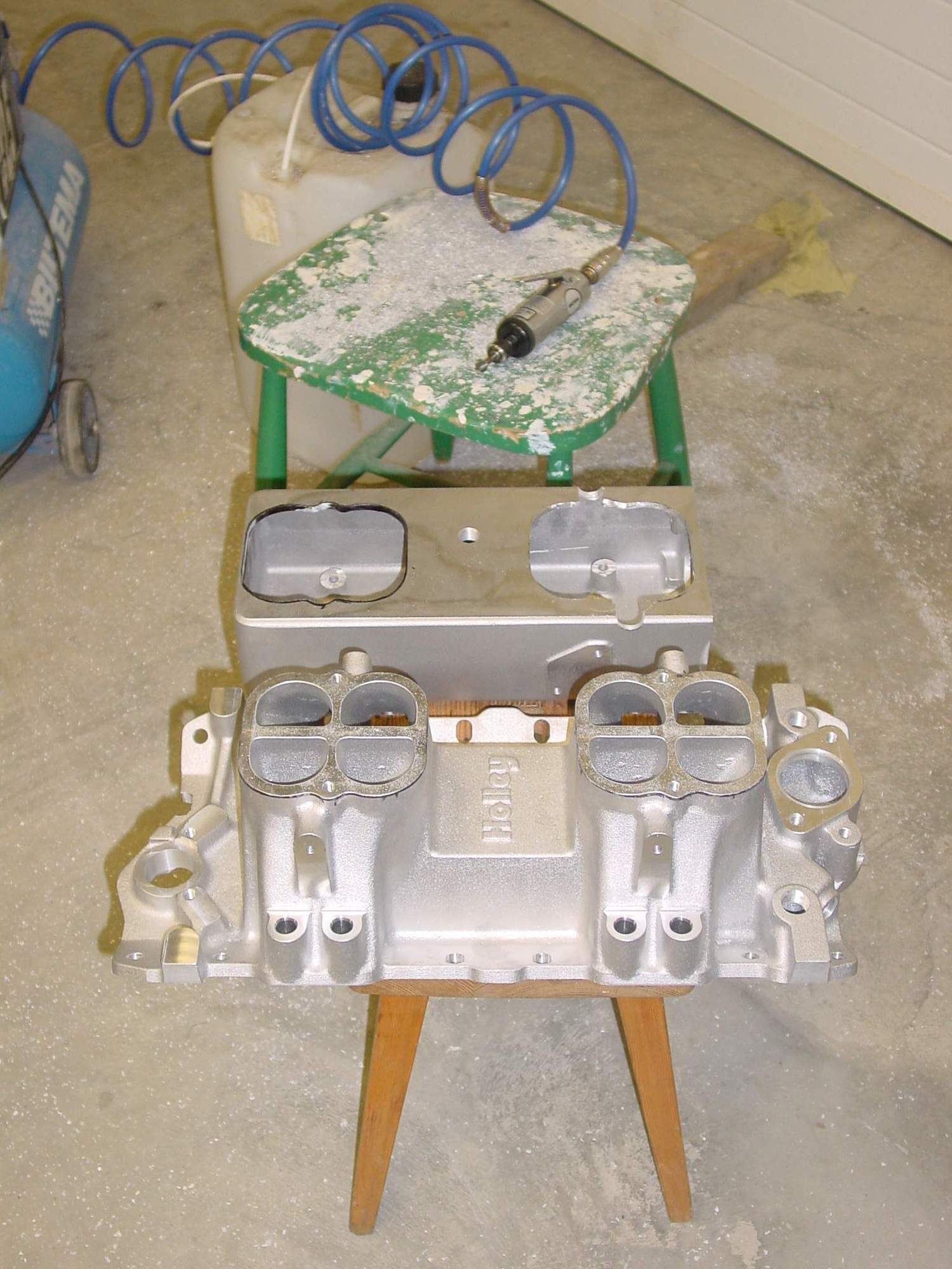

The OP may add to this but there was a company (USM) making modified HSRs several years ago. Member "Bjankuski" owns one IIRC.
At the time they started business, there was a group purchase proposed. I don't remember if anyone (else) tried/bought one, but here is a link to that thread (in case, there's discussion of the design).
https://www.corvetteforum.com/forums...m-l98-lt1.html
I also Googled "USM HSR intake images" to see if pics still exist from the defunct website....or at least from someone who's modified an HSR. Here are a couple of the images I found:
Considering the ingenuity of people willing to "make" their own intakes, the options for making an HSR fit aren't likely to be limited to one method. Having SAID that, if you "chop" the plenum and make it shallower, you'll affect "air supply" to the runners. (Lingenfelter understood this when designed the Super Ram.)
In the pics, you'll see USM (and others) cut open the bottom of the plenum (using a trace outline of the top of the base). Then they chop off the runner "extensions" (extending up from the base) at an angle. Finally, they weld the two pieces resulting in a plenum that angles downward toward the front of the intake.
With the plenum "floor" angled, you might wonder if better penetration of air is achieved in front runners. ("Ram Air" style intakes typically have more air "rammed" into the rear runners.) You also have to wonder how reversion is affected.
The HSR is considered somewhat more desired than a miniram because it's runners are closer to an LSx intake. (Yes, people recognize there's some advantage in capturing reversion -- especially if it can be done at an "ideal" tq/hp peak where power roll-off doesn't "waste" rpm limitation of the engine.) With varying runner lengths, rear cylinders will "peak" a bit lower than the fronts...but they also tend to get more air anyway. The result might not be "bad". Plus, some builders LIKE the idea of varying how individual cylinders perform.
Hopefully, this information adds inside into what the OP is attempting to accomplish.
Edit: If you have the welding skills/shop, you COULD buy a CHEAPER HSR and chop it EQUALLY front/rear. Basically, you'd have a miniram for less money. Also...I probably could have found more pictures were it not for photobucket. (We can't diss them enough!!! )

I have the USM modified HSR but never got around to fitting it, can post pictures if required.
Just need to find it in my shed somewhere.
