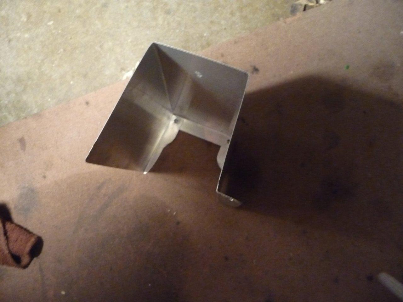

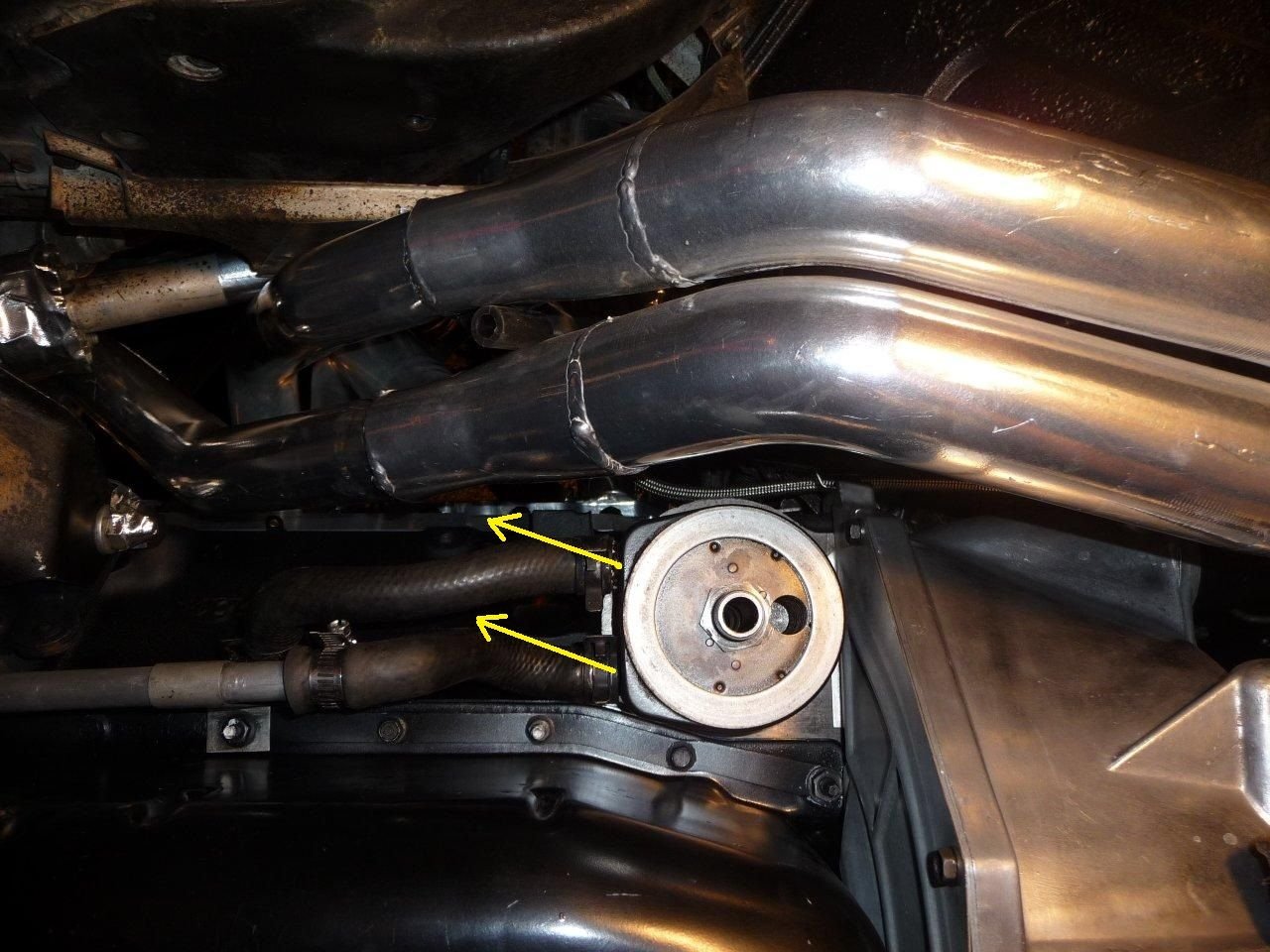

I agree the cooler lines can be shifted. In this picture, the arrows represent how the lines USED to be pointing. It's been 7 yrs so I can't remember the details but I am thinking a "stop" had to be removed? And, the result required HOLDING the cooler tank in the desired position while tightening? Wish I could remember....

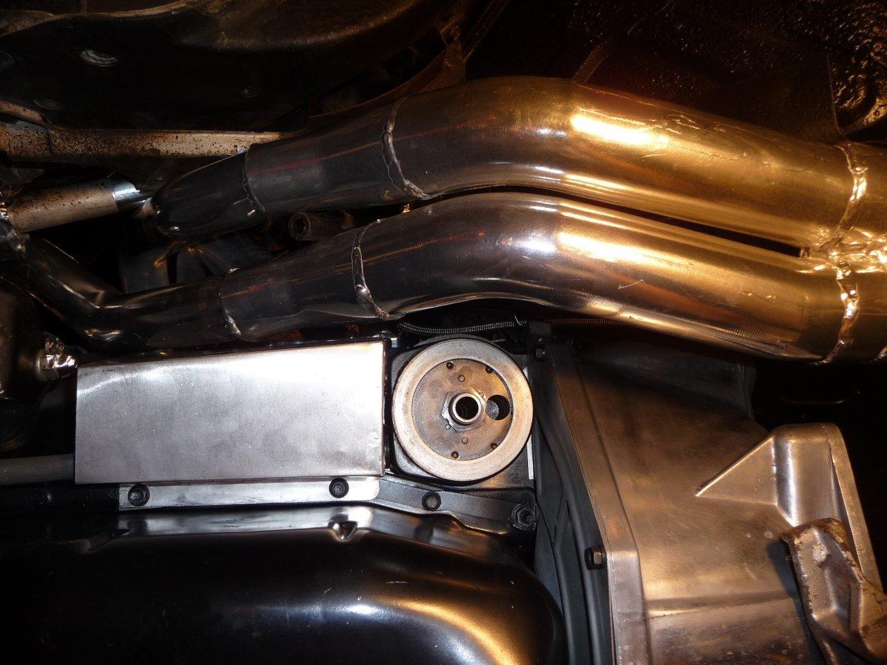

I really like the idea of using a spark plug wire "sock" to insulate it from heat. I went so far as to make a shield. With alum snips, pop rivet, and a bench vise, I make this....
When installed, it looks like this. I should have taken a f/r view because there IS room for air to flow (front-to-rear) THRU the box so it doesn't act like an oven (and hold hot air in). PLUS...I put heat reflective tape on the side panel nearest the header. It creates a "partition" of heat reflection between the header and oil cooler.
FWIW, it looks like you have more space than I did too...so the boot/sock idea may be all that you need. Plus, rotating the "base" to redirect the hoses is free. If you can't tell (by the pic), I mounted it to the oil pan rail using two "studs".
Also...on the bottom and mounting sides of the box, I suppose I could have drilled lots of holes to make sure heat didn't "collect" inside the box. I don't race so my exhaust temps probably don't get as high. That said, it's been their for 7 years w/o a problem.
