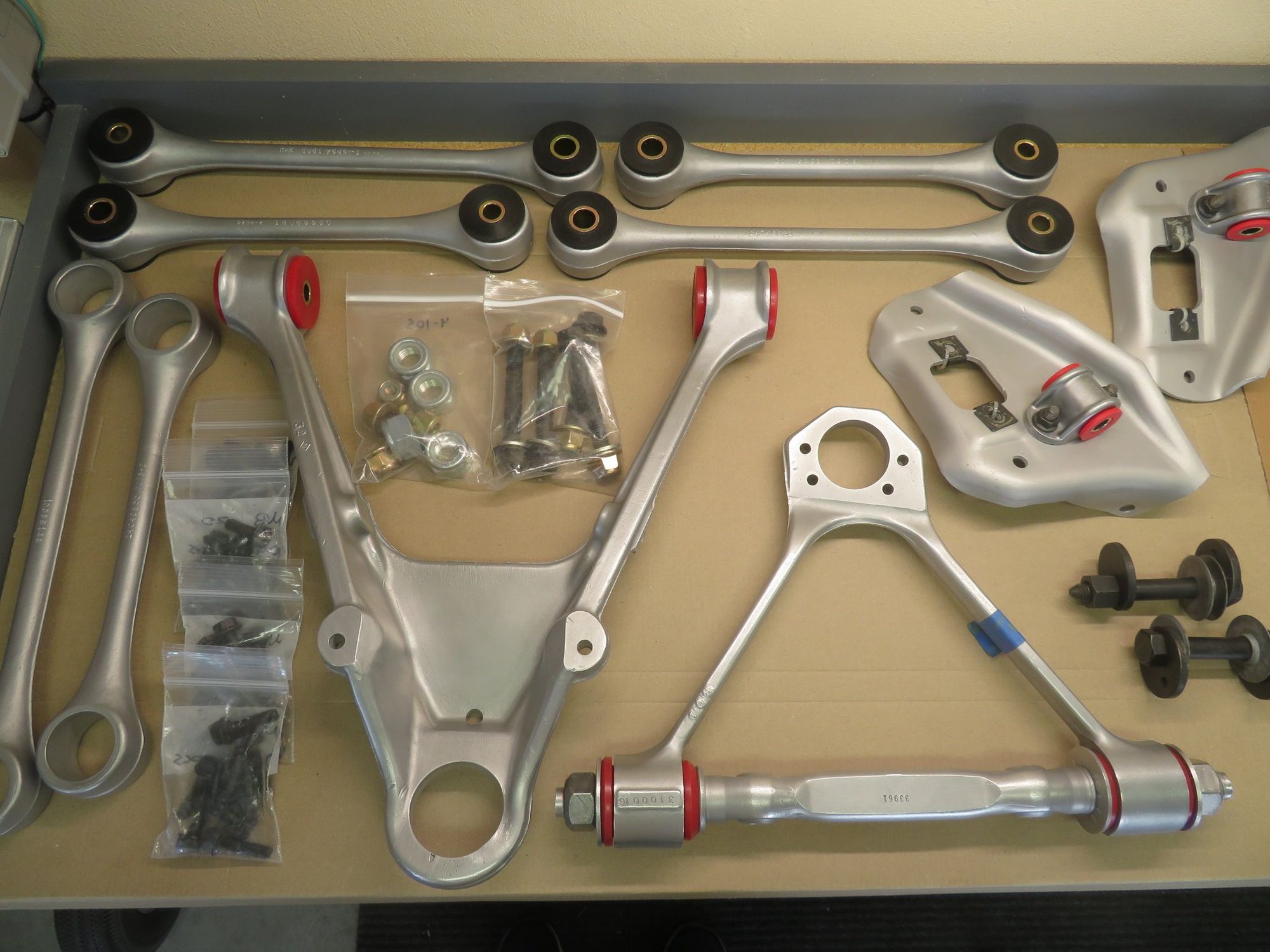

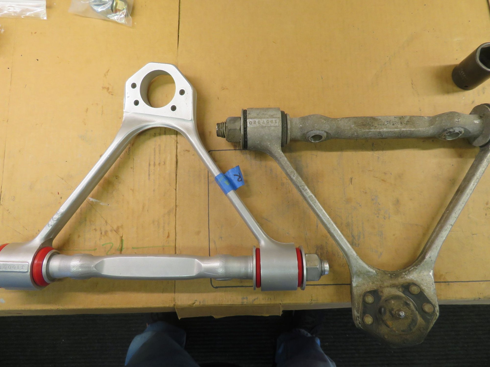

here's a project I've been wanting to do for several years now - finally got around to starting it...
took a couple days to press out the bushing and ball joints. some say you can do it without a press, but it gave my 20 ton a workout. any of you guys want these - FREE, just pay S&H -
some "work in progress" shots - i'm about half way through the piece/part rebuild. I bought just about everything from an on-line salvage yard and fleabay - mostly 87 parts - a few 84. I opted to go this route since I'll have less down time on my 85 -
below - the lower control arm on the right is freshly bead blasted, the upper on the left is lightly polished and sealed, using wenol compound with 0000 steelwool -
as I said, about half way - figure i'll start the actual rebuild on the front end in a couple weeks. in case anyone wants to know why I have red and black bushings, well, i didn't buy a complete master kit, but took advantage of online pricing and sales on individual kits. i saved over $80, and for $80, i wouldn't give a rats-**** if they were pink and blue -

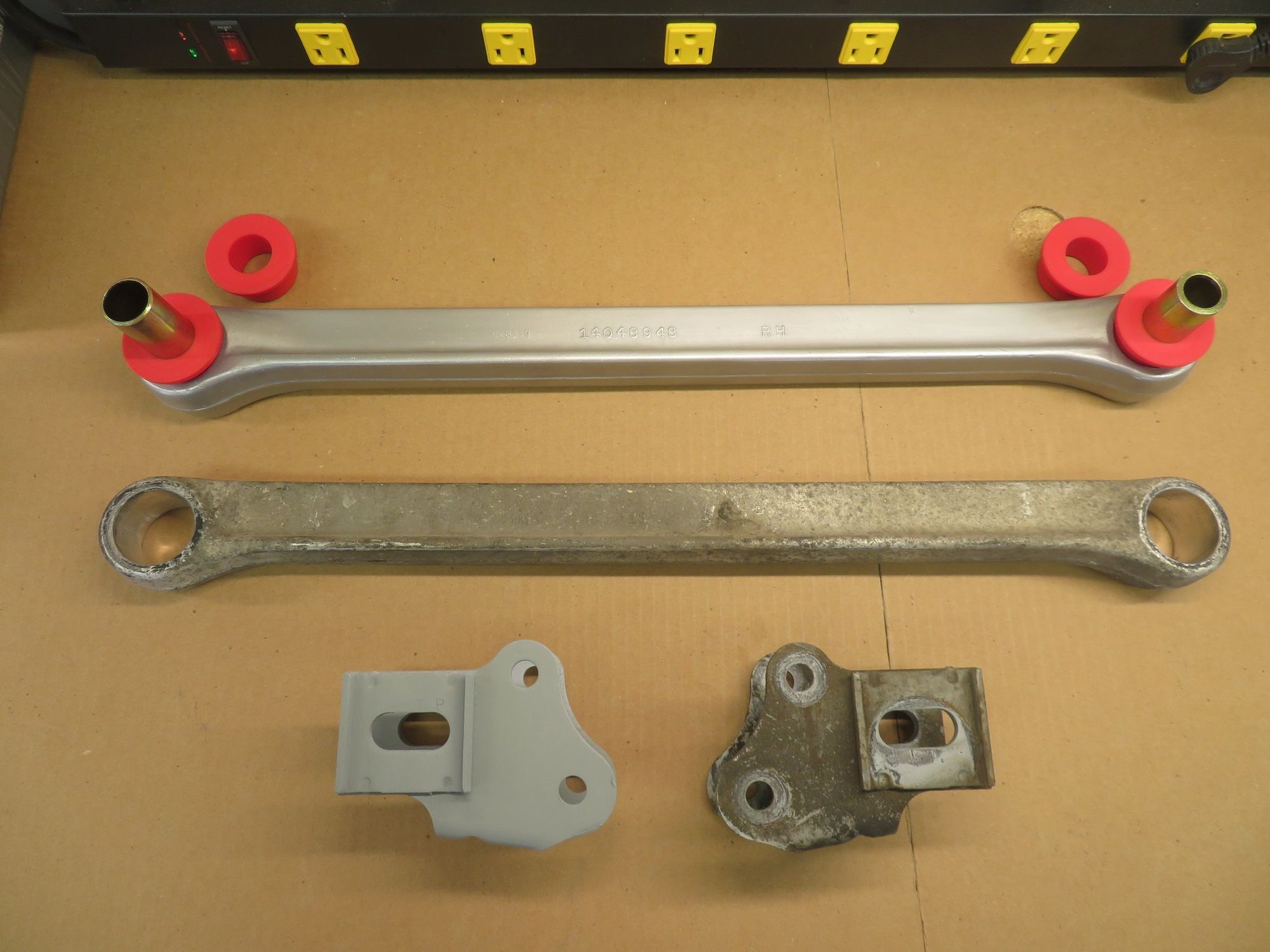

on the rear control arms, remove one or both (rubber) flanges from the original bushings. here's a pic I found on-line -
I found using a utility knife a bit cumbersome. I had an old fish filleting knife that worked like a champ. had to keep sharpening it, but it seemed to work better than the utility knife.
once the flanges are removed, the bushings press out without much effort. as Kubs posted, I imagine a large c-clamp would work, or maybe a two-jaw bearing puller. the new bushing are two piece, and go in with little effort. at best, maybe a bench vice for the center sleeve.
