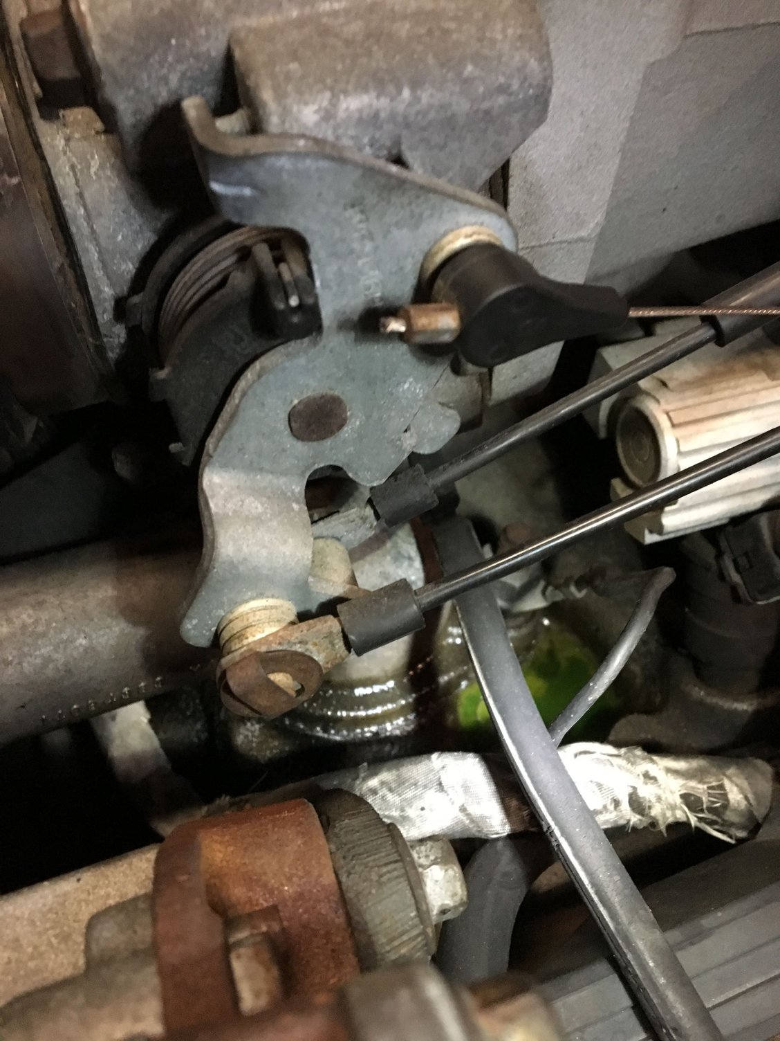

It’s about 25 degrees outside and I hadn’t started my stock ‘85 L98 in couple days. I go to turn it over. Fires right up and then dies! Turned it over again same thing. Second time I gave it a little throttle for about 5 seconds, but as soon as I let off it shuts off.

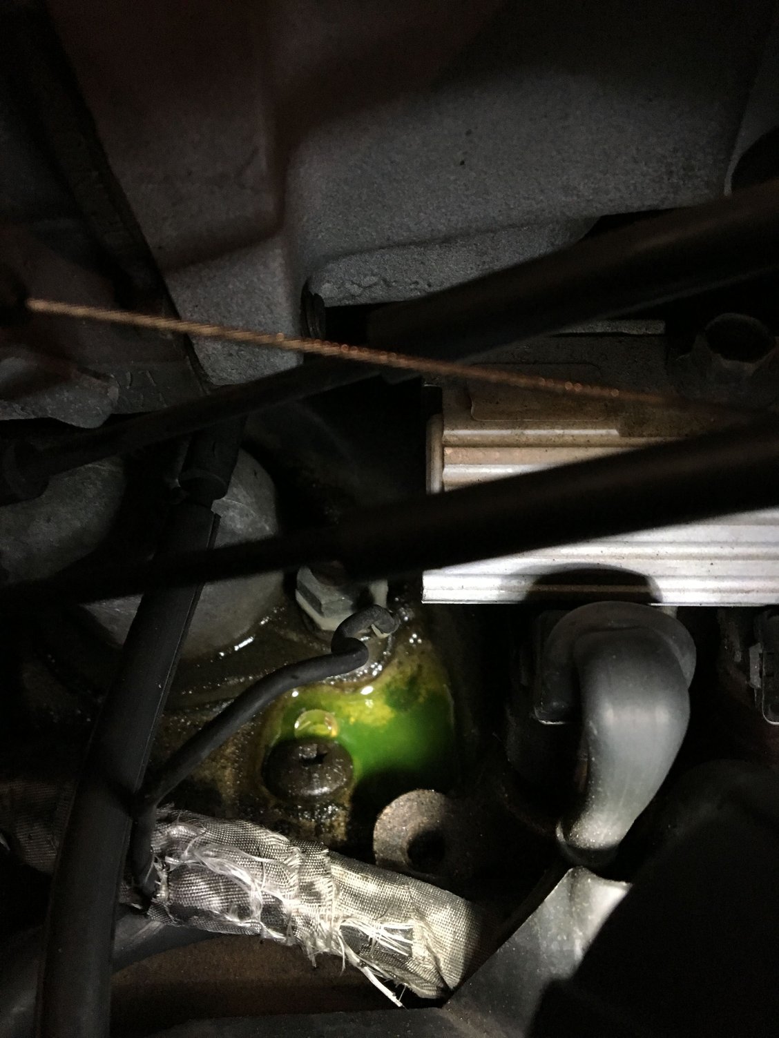

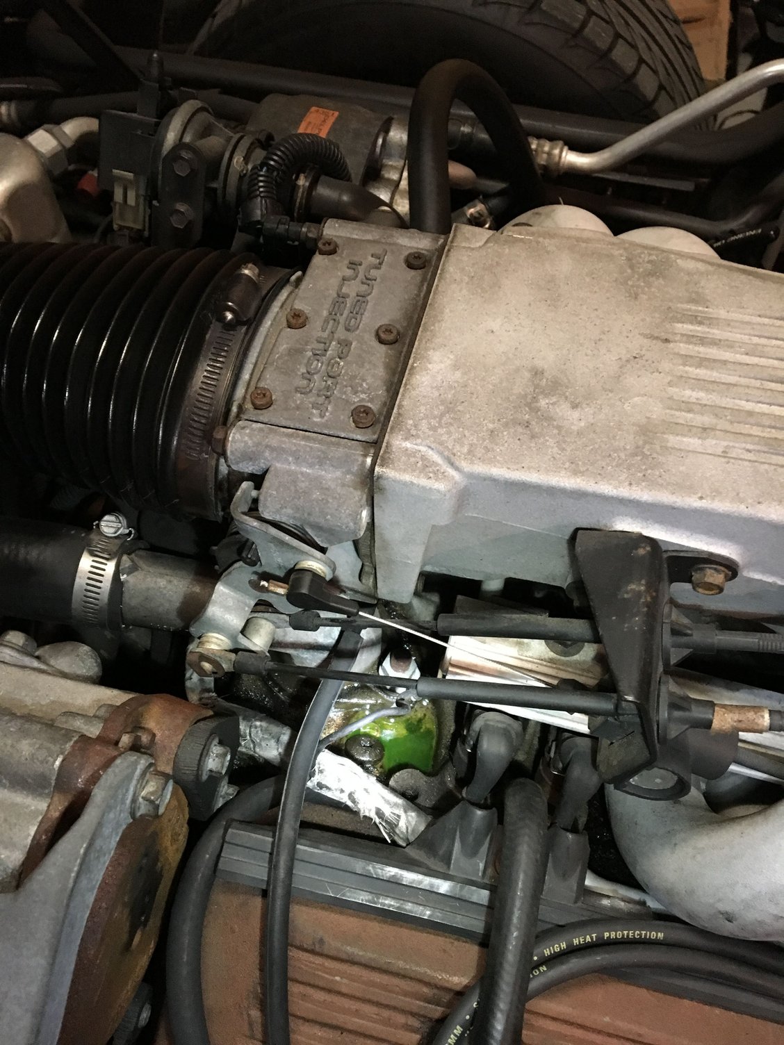

I look underneath on the floor and see a puddle of coolant right under where the C4 Vette logo is on the driver side valve cover. I grab a flashlight and see that the coolant has collected where a coolant hose connects to a metal flange right under throttle cable (bare with me I’ve got photos).Not sure how the coolant collected there and ended up closer to the firewall and dripped on the floor, but I’m sure you can all answer that.

My first thought is a stuck shut IACV. If you keep slight pressure on the accelerator does it keep running?
Coolant may be unrelated. Looks like there is a leak at the thermostat outlet hose and it's running down the bottom of the housing.

As for your Coolant leak I think you may Have a Pretty good Intake Leak, Clean up the coolant Check Hoses/Clamps & Thermostat Neck and Gasket Run or Pressurize. But I will bet you will see the Intake bolts getting wet or a line of coolant form on to edge of Intake

Your thermostat gasket is shot. Need to replace it as it shrunk in the cold.

On the coolant leak, hope that it is your thermostat gasket as that is a 20 minute fix. My bet is your intake manifold is shot as that area is prone to failure given the "wet" manifold of the L98 (mine did the same). Should be easy to tell if you clean that area and just watch. Lots of good threads on intake manifold replacement here... was a lengthy project for me (but I am slow).

Re: coolant leak - might be worthwhile to remove the air duct off the throttle body and inspect that "U" shaped hose the directs coolant from TB to the block. My '91 was leaking there - ever so slightly though in my case. Took me a while to find it too. I had to put a mirror under the hose to see it was wet. Based on the pooling seen in your pics, I doubt yours is just seeping though - but under pressure maybe its spraying coolant back toward the thermostat and pooling up there ? Just a thought. If it turns out that hose is at fault, its a good time for the TB bypass.
My 85 had the same symptoms and it was IAC related. You also have a thermostat housing leak; completely unrelated to your idle issue.
