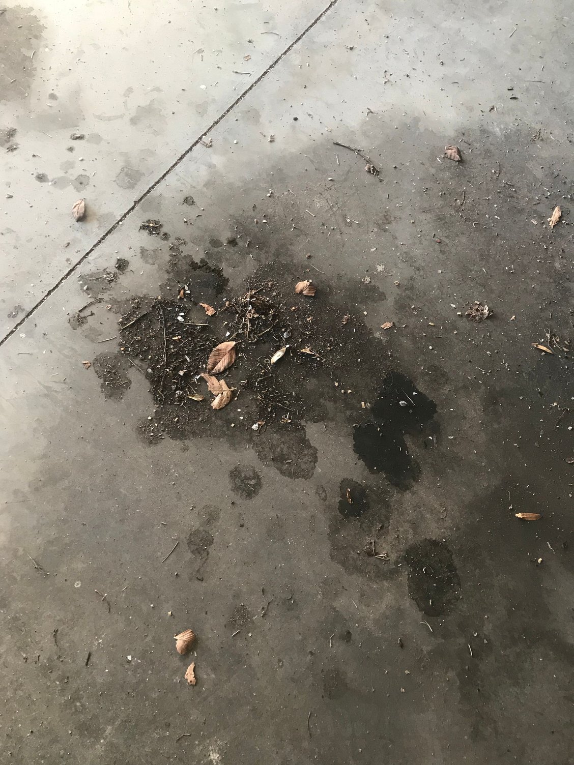

Well I found some of my missing oil anyway
