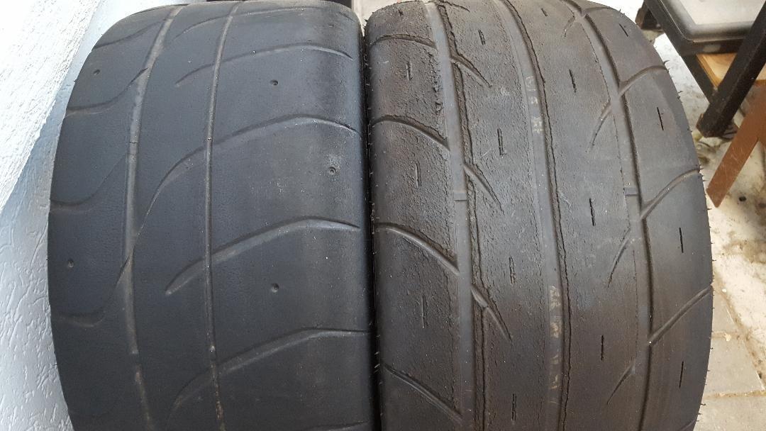

The fresher the tires - the better !
Keep in mind that the drag radials and similiar compounds dont like slip angles so keep that in mind when running them on the street, good in a straight line but dont like going around corners so much.
I have used the Mickey Thompson SS tires (that have the same compound as the drag radial) with some street use and hillclimb, here is a comparison pic against the Nitto 01 that was a direct replacement and used for the same thing, you can see how hard cornering can carve them up a bit. (and for info the Nitto 01's are quicker time wise)
