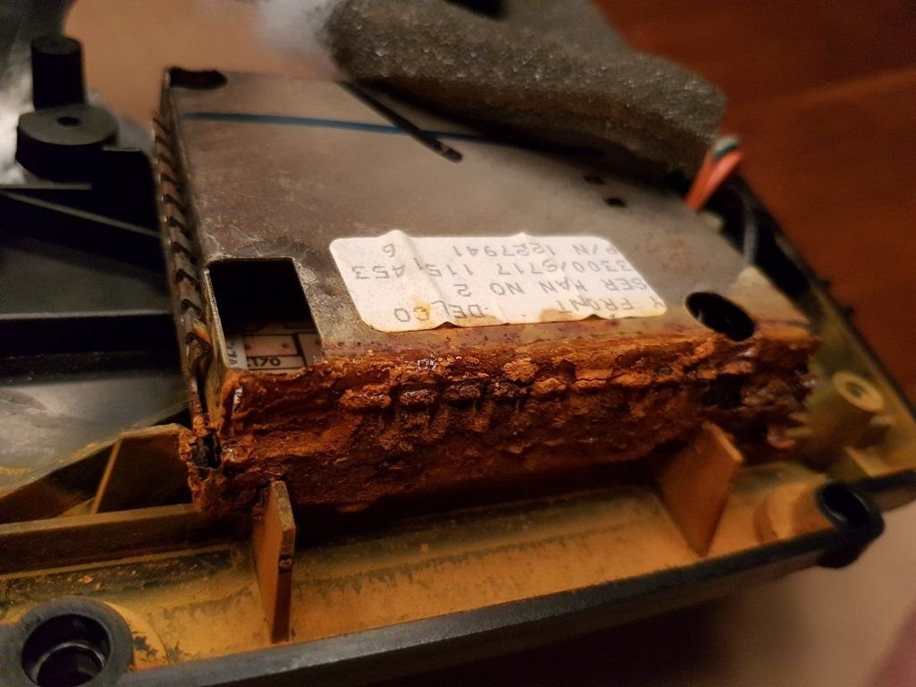

I had the same problem.... Speakers/amp. dead....
Installed new speakers/HU after that...
