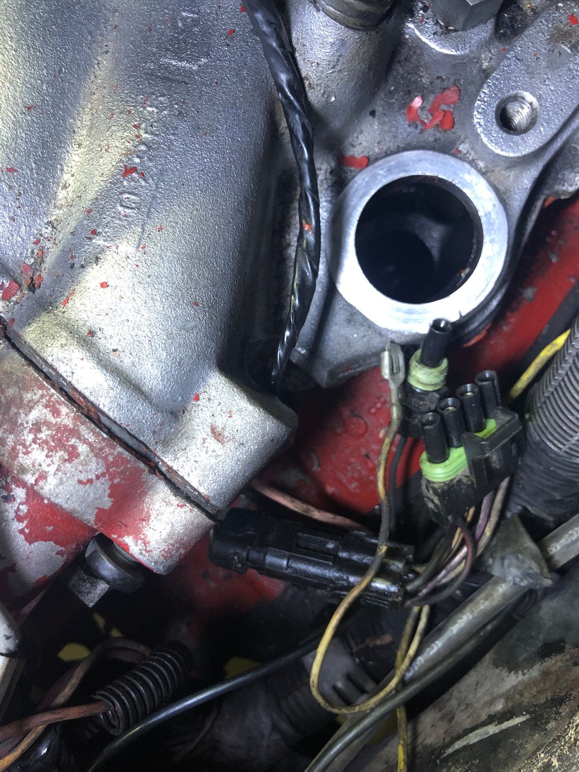

So I took the distributor out again. Looked back and found these stuffed down. I see nowhere for them to go. Can anyone identify them?

4 wire is to the distributor - wire colors are likely WHITE, PPL/WHT, TAN/BLK and BLK/RED.
Do you have the FSM for this car?
What color is the single Weather-Pack wire? What color is the loose wire with the female spade. I ain't an L98 guy.

I’m sorry. I definitely should have clarified... the two wires next to the dizzy 4 prong wire are the ones I need to know about.

The 4 wire is what I ID'd for you...........................OR I don't understand your clarification. There should be a 4 wire short harness coming from the distributor that mates to the 4 wire in your snapshot.

I think I see a larger pink wire burried down there. That might be the power wire to the dist. Won't run without that!! There should also be a white wire for the tach. Those two wires plug into the bottom of that lump on the side of your dist.
Do I see exposed threads on that manifold bolt? I hope not!

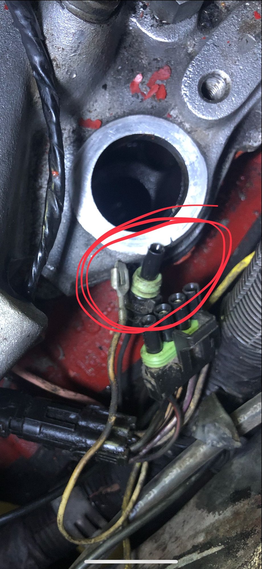

I’m sorry. Here’s what I’m asking about.

And I asked you a few posts ago what the wire colors are. What are they? I believe I understand them but you could certainly clarify. I believe the Weather-Pack is likely EGR Diagnostic Temp switch. Is wire maybe DK GREEN? If the other wire is actually WHITE it could be the tach filter wire to distributor but I would have expected a different female for the spade. The actual connector shell is missing also if that's what it is. Follow the wire and see if it takes you to a 'capacitor' appearing device rear of left cylinder head.

Yes the large wire is the power for the dist. I have it pushed out of the way for the time being. I was wondering about the other two wires in the picture that are next to the distributor hookup. And no threads showing here. Maybe just the angle of the pic haha. The white wire for the tech broke off (I have it laying on the work table) so I know that’s not sitting in there tucked away.

This is sort of off topic, but if the motor was just rebuilt and has no miles on it, why is there so much loose crap in the top of the intake. I hope the inside of the motor doesn't look like that. Also as Hotrod mentioned, you have a loose runner bolt.

Why have you decided to hide part of this picture? If that "too long" bolt, and the debris is any indication, you have a huge problem with putting this engine together. Sorry to be so direct, but it looks like you aren't being honest with us! Are you playing games, or are you just incompetent? I'm suspicious!
