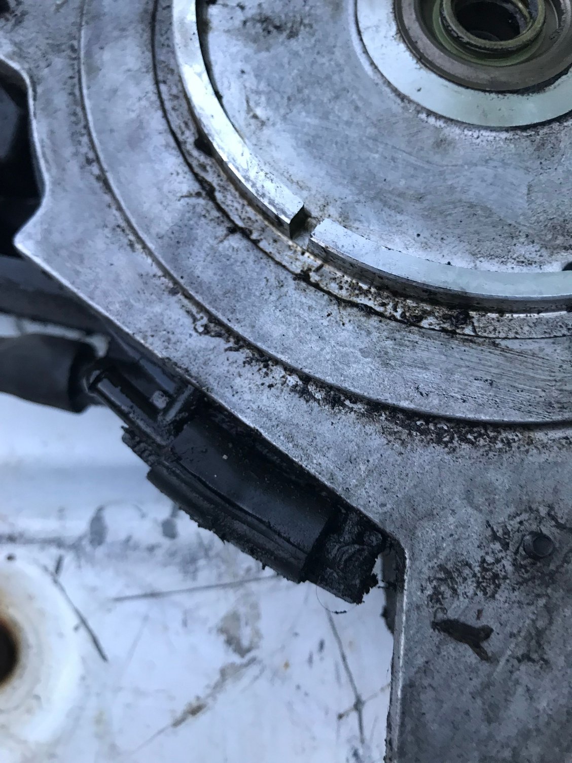

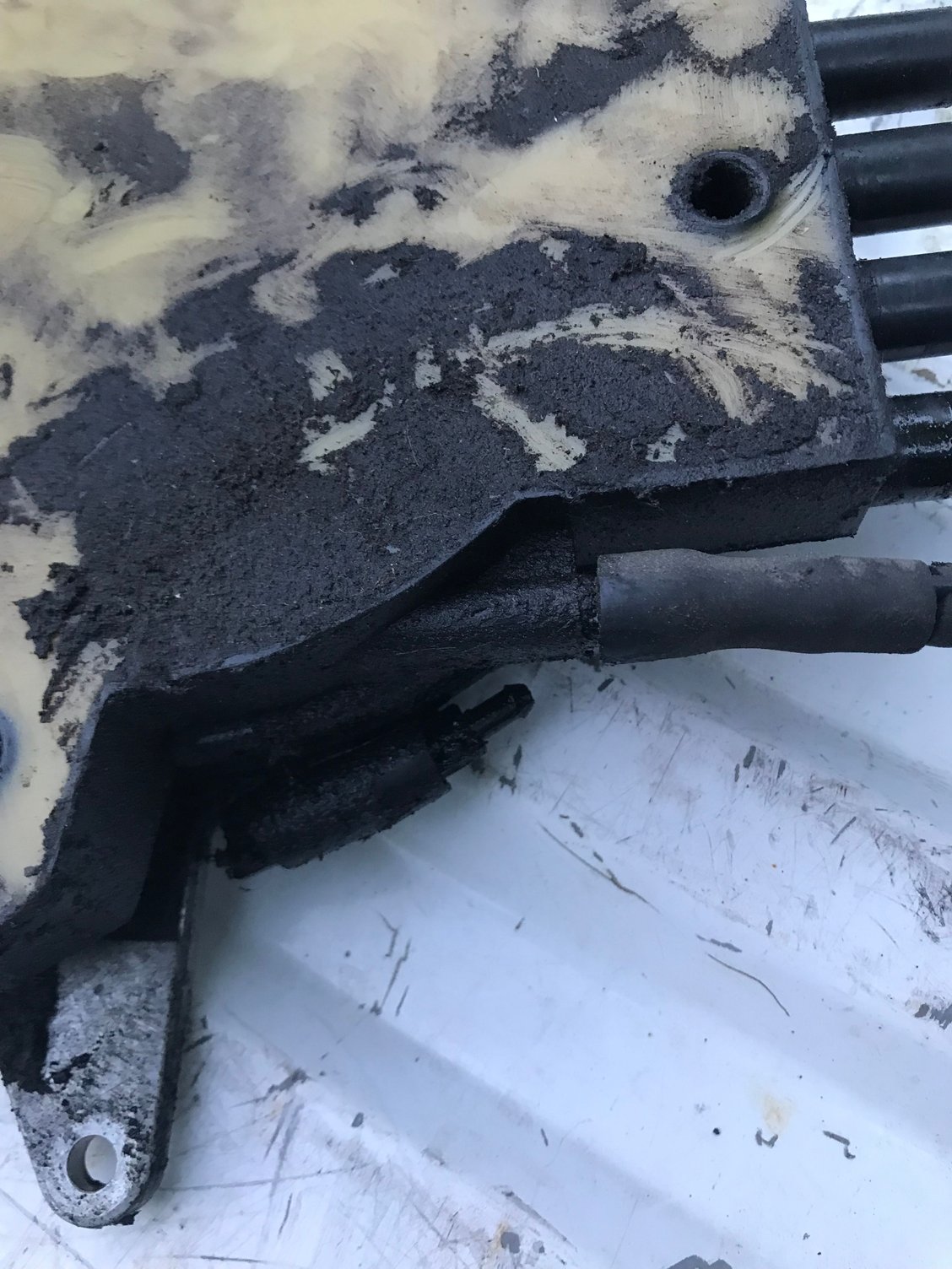

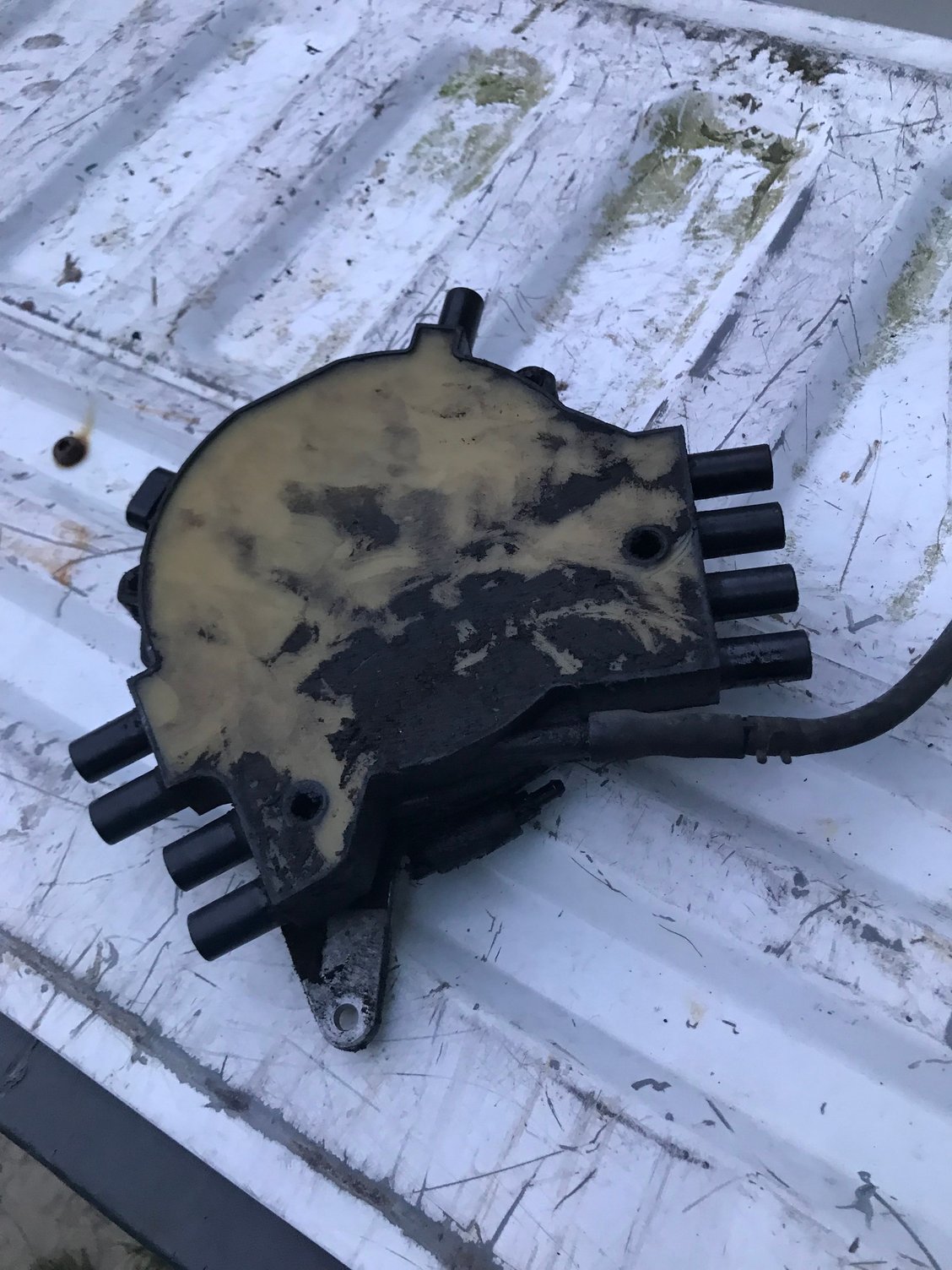

one thing, the Opti I removed did have the vent added to it, but it’s intake hose was cut off and only 2 inches long. Lots of grease, oil, and grime right there.

Did you find where the oil was coming from and fix?
I didn't see any fresh oil when I had it apart, and the car hasn't left any oil drops in any driveways. I'm thinking the oil on the opti was from an old leak that was previously fixed.
