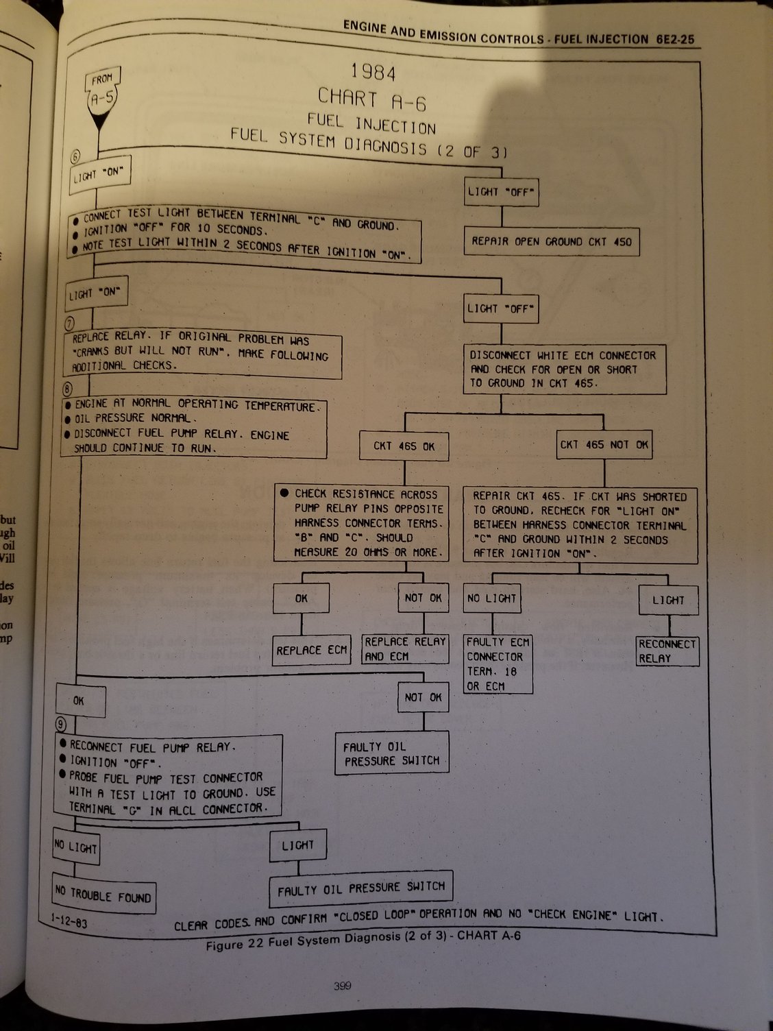

The fuel pump cycles on a time delay at key on, if you're getting no spray it either isn't getting a signal to turn on the pump or the injectors aren't pulsing fuel into the throttle bores. If you hold onto the injector pod you should feel it click while cranking it you're careful. If you have a test light you can ground it to the injector lead and it'll blink while pulsing. Let me dig up my service manual and snap a few pics for you from the trouble shooting section.
Old May 18, 2018 | 08:41 AM
84 4+3's Avatar
84 4+3
Joined: Aug 2017
Posts: 6,941
Likes: 1,490
From: New Jersey
These should help some.

Thanks for reply. If I can feel the injector pulse but no spray, then it could mean no gas to the injector? You mentioned: key on and a time delay and the pump shuts off.
The fuel line filter has never been changed in 50k plus miles. And it has been run on ethanol. Could it be as simple as a plugged fuel filter??
I thought since the pump shuts off it meant pressure to the throttle bodies. The key on time interval shut off is new to me. (I'm trying to help a neighbor)
Old May 18, 2018 | 07:00 PM
84 4+3's Avatar
84 4+3
Joined: Aug 2017
Posts: 6,941
Likes: 1,490
From: New Jersey
Nope that's how it works. If you follow through that flow chart it shows the no fuel diagnosis. Fuel filter wouldn't be bad. I'd check to see if you have fuel pressure while cranking too.
