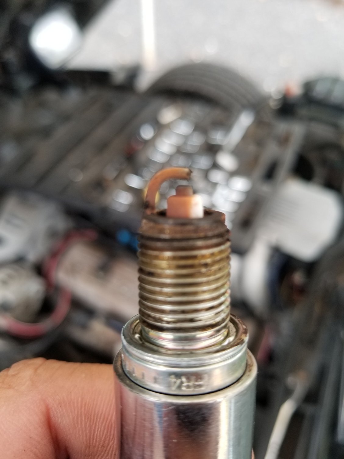

I am not sure if the flywheel stock or aftermarket as the prior owners had the transmission replaced with a new ZF and it is not clear if they changed it then or with the clutch change. I did find something though that leads me to think the engine needs work.
From Cylinder #7
From Cyl #5
Compression is about 150psi in all cylinders and most the plugs look like Cylinder 5 or a tad darker from being e little more rich. From what I can figure its time to start planning a head gasket.

IMHO... a head gasket may be pre mature.
150 pounds in all cylinders is ok. I'd be concerned with wild swings.
Id start with a good old fashion basic tune up and make sure you have good gasoline.
Drive it for a while and see what happens. Your vibration at higher RPMs coudl very well be due to mis firnings. Your number seven is rachet.
In random order....
I get why you are suspicious of the whitish appearance of that plug. I agree #7 has a "coolant" look to it AND (IIRC), #7 is the most likely point of failure.
Also...I'm thinking a pressure test of the coolant system can help identify if you have head gasket failure.
If it turns out to be a head gasket AND depending on your car's value, I'd be inclined to try a "block seal" product. I don't typically feel "additives" are worth much except radiator and head gasket sealers have a fairly high success rate. OK...power steering additives have worked for me too.
Check to see if you have an antifreeze smell at the tailpipe. Check cold AND warm. Also, make sure you don't have an injector issue...where that's actually LEAN. Measure ohms to make sure they are within 25% of each other (16ohms?). You might also run injector cleaner (if they ohm OK) at double strength.

Originally Posted by GREGGPENN
In random order....

That plug looks like oil burning to me. Check the viration in your driveway and on the road. If it is rpm dependant I would suspct that someone changed to an aftermarket flywheel and forgot to attach the weight. All 1986 and latter sbc are externally balanced and the flywheels come both ways with a weight to be added on. It is possible the weight is not installed.
