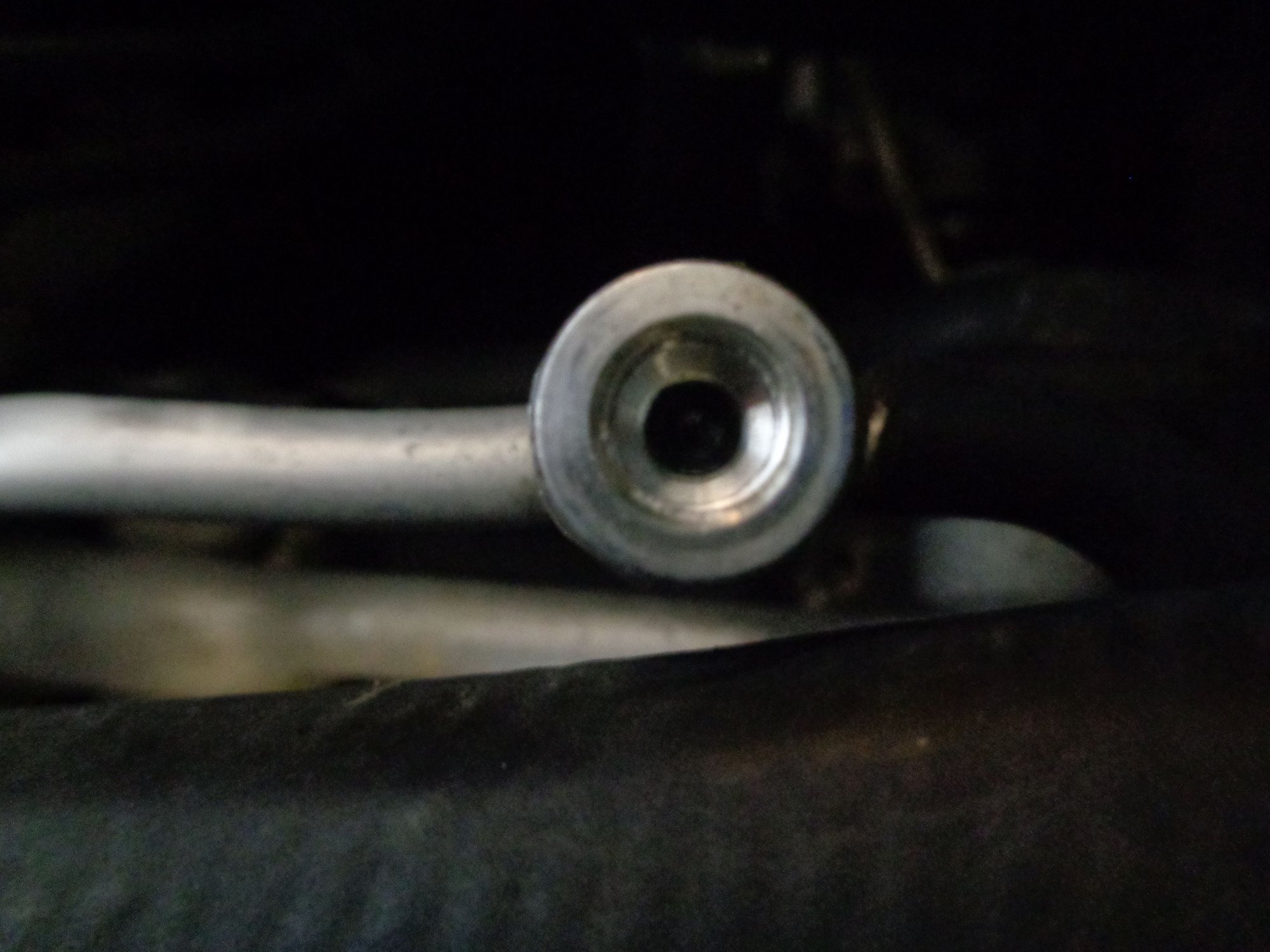

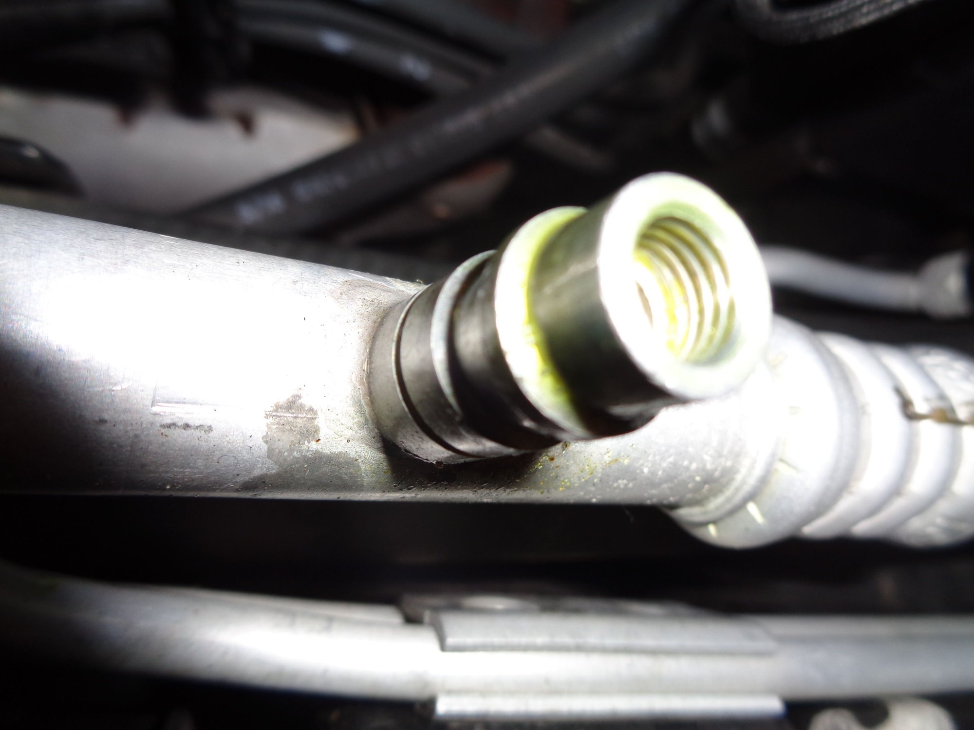

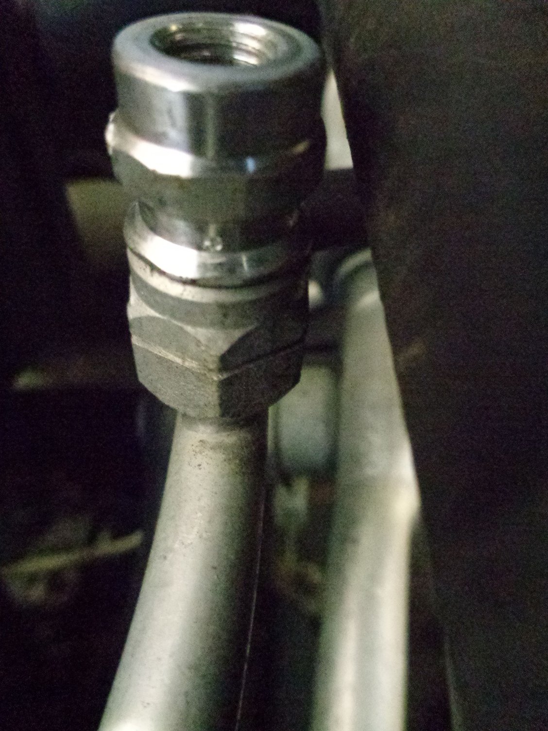

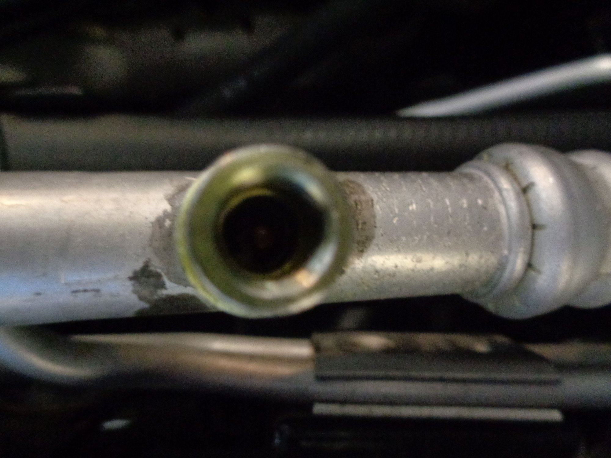

Mine is a 96 so came with r134a but the high side doesnt look like the core is serviceable.
High side
Low side
High side
Low side

Originally Posted by ihatebarkingdogs
There is no Schrader valve in the high side port. It is a flapper valve of some sort. It is not serviceable. I had to replace the entire liquid line on my 88, but the part was still available from GM at the time. I had no idea the R-134 ports were the same deal as the earlier ports. Now I do. Put a new o-ring in the seal cap, screw the cap on tight, and add refrigerant from time to time. Probably all you can do.
EDIT/ADD: Remove the liquid line from the car and have the leaking port TIG welded shut. In the future, use one of the high-side switch ports if you really need to connect to the high side for diagnostics. I never connect to the high side on my C4 because I don't want to disturb that jankey 30 year old port valve and cause a leak that I can't get parts to fix.
Its my low side that is leaking.. I was going to replace the high side proactively,.
