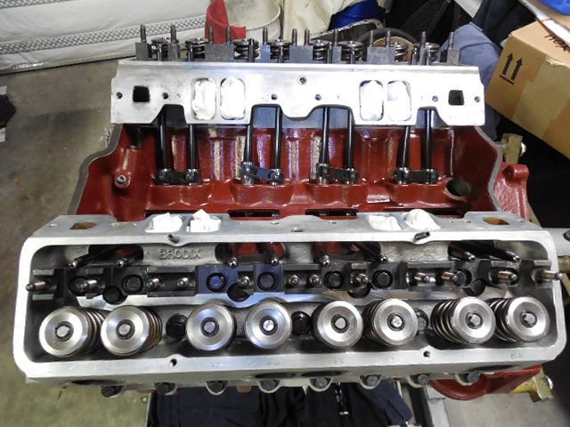

….. Got it all loaded up and installed the heads and valvetrain …..

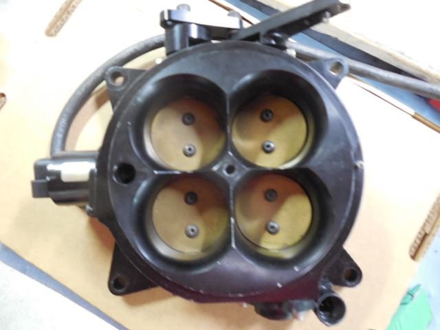

..... Intake installed …
