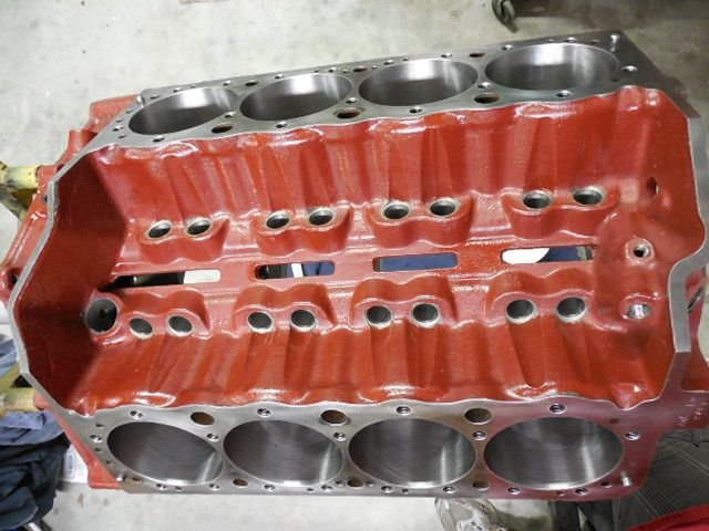

….. Getting ready to load 'em up ! …..

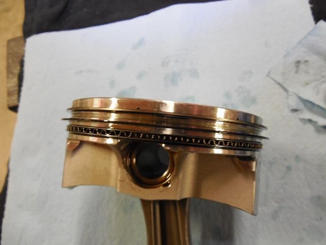

….. … Skinny rings 1mm 1mm 3mm … Thank God and ARP for the piston funnel ! …

lol.. I know! OMZ!
Anything that goes under my bench is GONE.. I dunno what dark force disappears things there, but it's hopeless. Like a bag of holding. I think my record for a snap ring is out the door and somewhere in the middle of the parking lot! lol.
Nice pistons. I have been looking at stroker parts.
I know you're a racer, but do you know how well stroker pistons hold up on the street with that gap in the oil ring land? Special rings there? Anything you have to do out of the ordinary?
