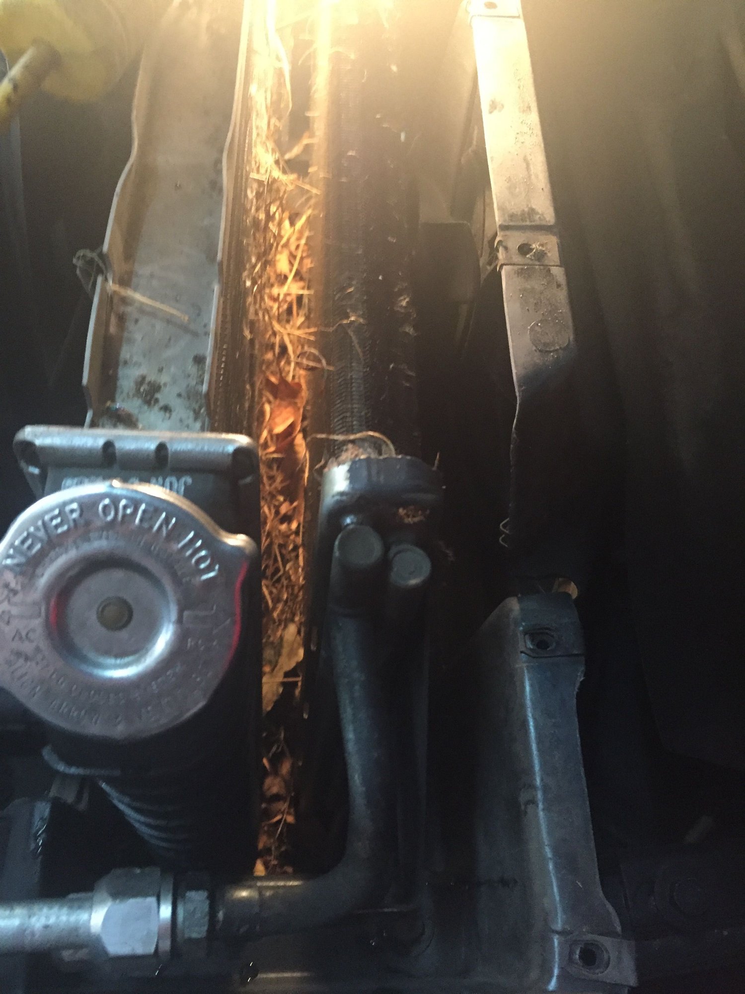

Originally Posted by jpipx
You'll rule out the fans and then need to move to to the debris test.
I agree--You will end up here anyway. Fans or not, the "inbetween" area from the radiator adn the AC condenser WILL fill with road debris after a few years clogging air flow. You will need to look in between the two and/or remove the shroud to clean out the accumulated leaves, bags and general crap. Here is what I found a few years ago after my (then new to me) 89 damn near over heated at idle. I clean out he debris and never had a problem since.
