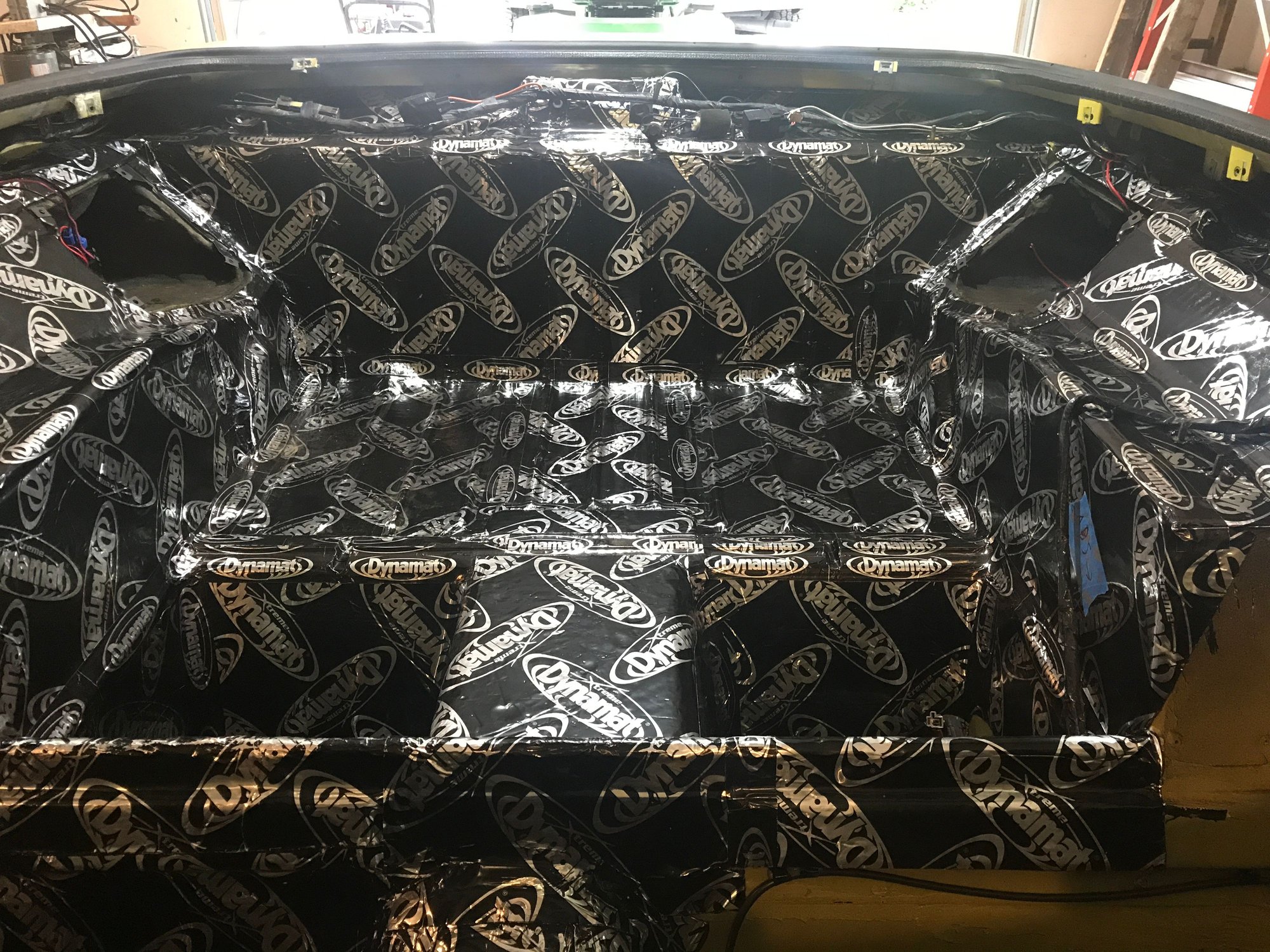

I'm hoping Dynamat xTreme on almost every square inch of my '87 C4 will help drone and general road noise. With a simple knuckle knock test the hollow fiberglass rattle is now more of a light thud. The rear storage area is probably the thinnest area and largest offender, which also happens to sit partially above the mufflers. Since these pictures were taken I've done most of the driver area though I'm leaving the bell housing and shifter area to do after a ZF6 swap since we'll have to cut the trans tunnel a little. I also need to do the doors. I'm also going to add Dyanaliner to the drivetrain/exhaust area to hopefully help limit some heat.
Based on my experience with this product this is a 'better' option but substantially more expensive than the other posted here.
I bought the mega pack from Amazon for ~$300. It came with nine 24"x48" sheets of Dynamat xTreme which works out to 72 sq. ft.. It looks like the one package is going to cover everything except the doors. Had I not done the storage passenger bin and the ABS pump/computer area it may have done the doors but it would be close. I've been doing my best to cut out sections to reduce waste as much as possible and then use small random cutoffs when I find small areas that need a little touching up. I've also gone through two rolls of Dynamat tape but it isn't really necessary if you want to skip using it. I'll probably go through 1-2 more from the looks of it, they go for ~$19 for two rolls. I haven't yet measured how much Dynaliner I want to buy.
