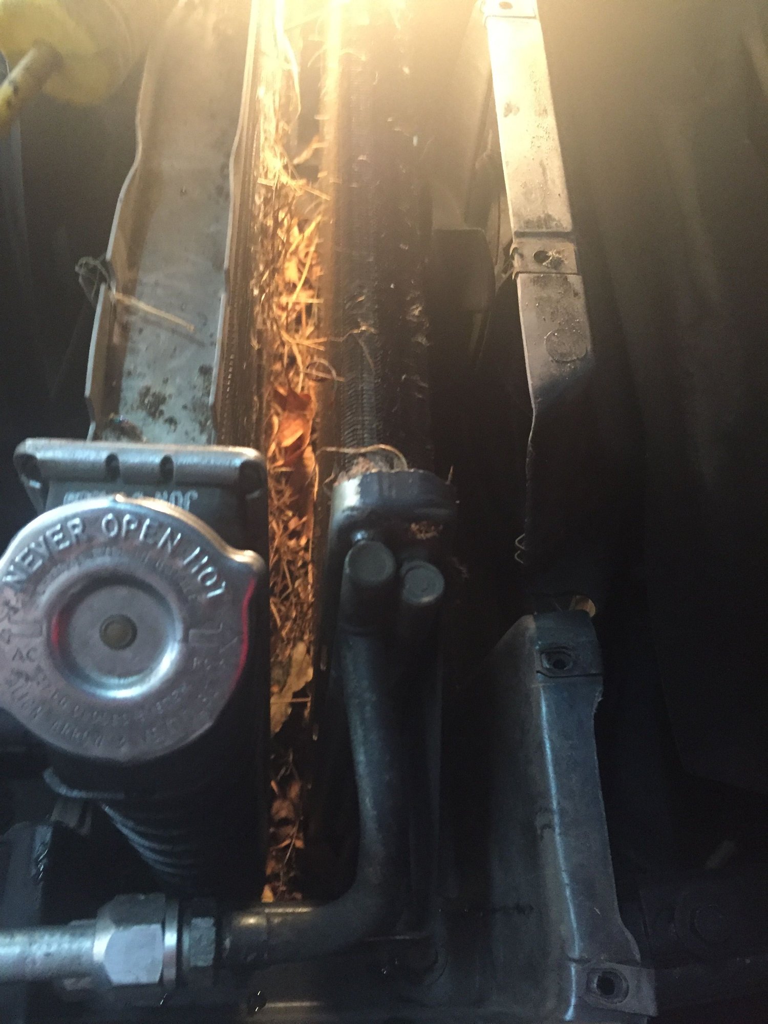

And please, for the love of God, clean out in front of your AC Condenser and between the AC Condenser and the radiator. I'll bet good money you've got lots of leaf debris and possibly some rodents living in those spaces and blocking air flow through your radiator.
YES! Here is what I found when I looked at my 89
WOW, great info on the automatic switching... I may look into that for sure. When I pulled the air filter box and air intake to change the thermostat, I did clean out a handful of pine needles in front of the air intake, which may have been causing a small issue, but not really sure if that area matters for cooling. Today I took the car to church, about 20 miles each direction and the car ran great. It's only about 85 degrees today, but on the way there the car hit 190 and stayed there for about 5 miles before creeping up to 198, then it went back and forth between 193 and 200 and the same on the ride home. This is the first time I actually saw the temperature correct itself in a negative way by going back down, before it always just creeped up and up and up but never seemed to go back down. I will take a look at the space between the condenser and radiator when I have it up on the rack next week to change the engine mounts. When I bought the car it had been sitting outside for a couple of years and had spiders living in the car. When vacuuming the car out for the first time after getting it, I actually sucked up a daddy long legs trying to escape. I have eliminated all of the cob webs now and haven't seen anything new, so I think I have her bug free now. It's a little frustrating being a perfectionist, also trying to compare this car now 24 years later to the same car I had back in 1994 brand new. I know what this car can be, so at least I have first hand knowledge as to where it needs to go to become virtually new once again. I have pretty much eliminated all rattles and squeaks and have replaced most worn components. Other than a few more minor issues like needing new carpet for the cargo floor area and new sun visors, the only thing that won't be perfect is the paint, but it is an 8 out of 10 and after a clay job, polish and wax, the car should be a 9 out of 10 condition wise. Runs like a new car now after going through the entire motor, my only regret is forgetting to install new engine mounts, and obviously the thermostat when I had the engine out last month... The support on this forum is the best... This is my 5th Vette and in 1987 my first brand new car at the age of 23 was a Corvette, I will never forget the feeling I had driving her home for the first time, it was exhilarating. of the 4 previous Corvettes That I owned, a 85, 87, 94 and 2005 C6, the 94 is actually my all time favorite, which is why I bought this one. Just a great car... Love it.
