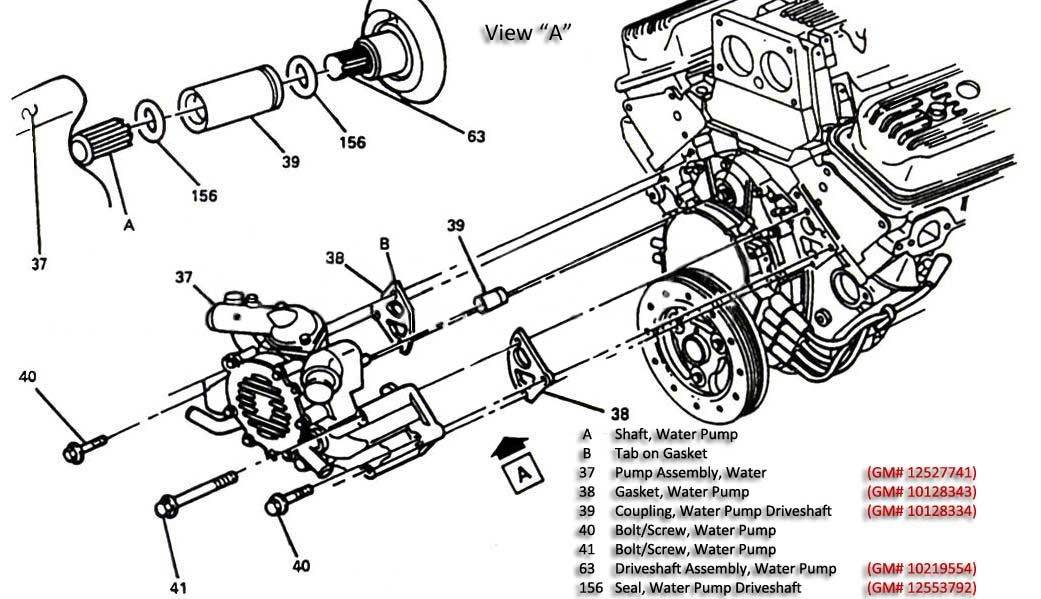

Every pic I see of the back of the pump shows a ball bearing in sight but no seal. There obviously is a seal somewhere in there to keep the coolant from leaking, but it doesn't appear to be serviceable from the outside. And it won't have oil circulating in the pump at all - that is supposed to stay behind the timing cover.
Here's a pic showing the two O-rings on each end of the coupler:
Since there is no fluid (oil or coolant) to seal there, I assume these are there to give a soft surface for the coupler ends to butt up against and damp any rattling that might otherwise occur without crushing the bearings in the pump or block.
