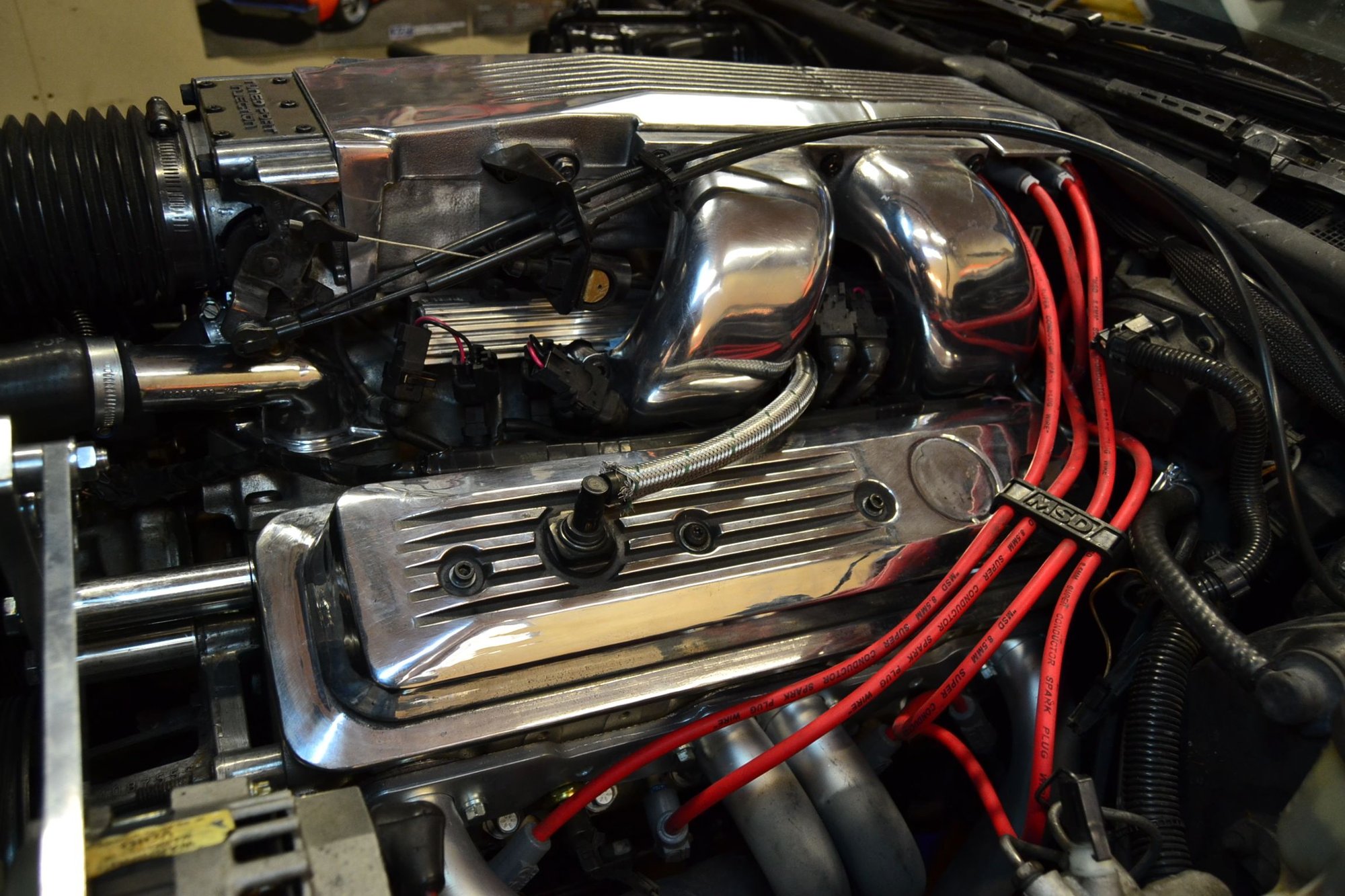

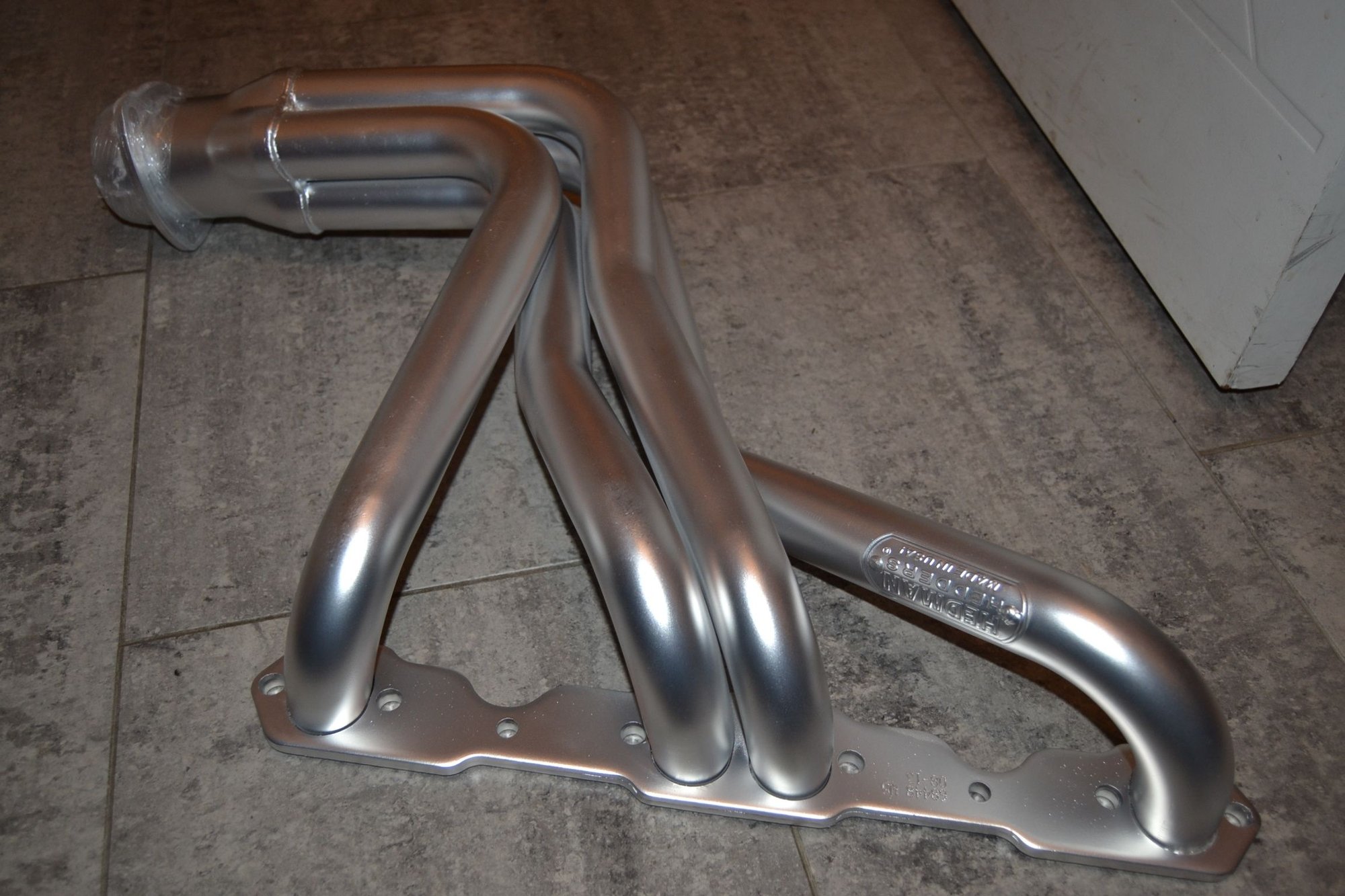

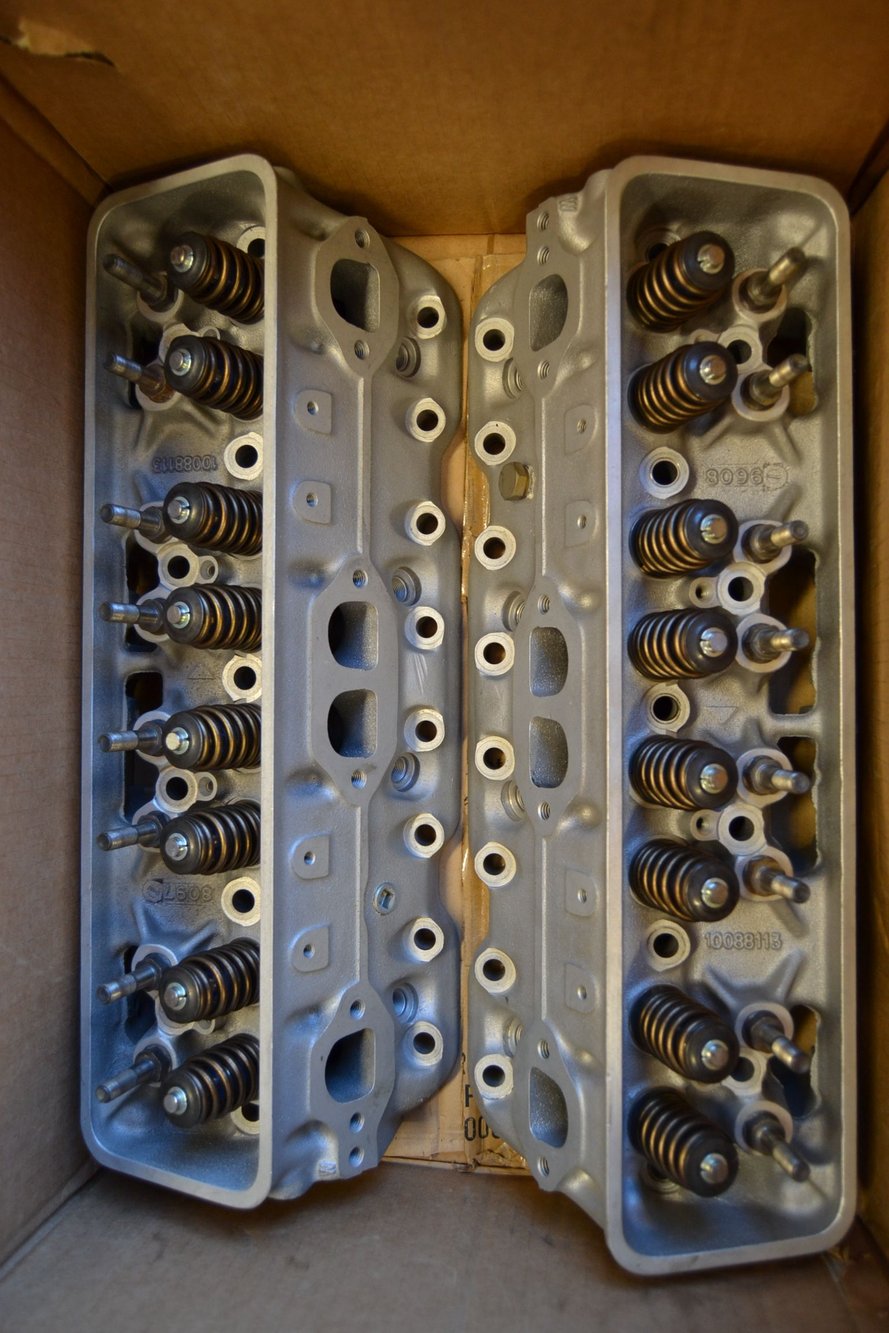

Here is my project, -86 L98 TPI Automatic.
I've done all the installations myself. The budget was about 4k.
Here's what I have changed, other parts are original.
-2.5" exhaust with X-pipe
-Hedman headers
-New harmonic damper
-Mild Comp Cam cam
-113" Corvette heads - not ported
-1.6 ratio Scorpion roller rockers
-Boshc 4 EV14 30lb injectors with adapters
-Ported intake
-Ported SLP runners
-Ported Plenium
-New MSD wirings
-AC delete kit
-Air pump delete kit
-Airfoil
-K&N filter with opened housing
-PLX wideband
-Tuned original ECM
Dyno tested 330hp and 570Nm.
Next coming Procharger P600B with Aquamist methanol / water injection.
