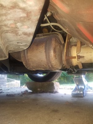

My son was driving my 96 Lt4 6spd. He said when he shut the car off, it was fine. After school upon restarting there was a terrible rattle.
I have isolated to the "drum" looking device on the exhaust right behind the driver side exhaust manifold. Sounds like there is something loose in there.
What are your thoughts?

That is a catalytic converter. There are 2 on your 94, one on each bank. Per your description, seems the catalyst has broken free and is rattling around. Solutions are replace with a new/used unit or replace with a segment of pipe and eliminate the converter (illegal).
edit: when the car is cold, rap the converter with your fist, you should hear it rattle and confirm that it is the source. Double edit - I said 94 above, but your 96 is the same. 2 converters.

Verify first at least one of your cats is actually rattling internally and defective. If you live in a state that doesn't require catalytic converters, just replace both cats with straight pipe same as what it's connected to. I'd have a shop weld it in. If you must replace the cats, you can investigate high performance cats too.

Before you chuck the cats, make sure that the heat shield is not loose. I had a shild come loose on my 91 and it rattled like hell. I tighten it up with a little effort and it quieted down. Worth a look.

It's not the shield. It's inside it. Amazing how bad it sounds!

We done check anything in my state. $140 later, problem solved.
I have also noticed the "hiccup" it had under heavy and sudden acceleration is now gone as well.
