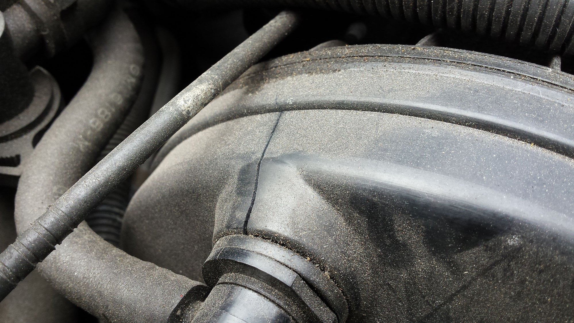

Like stated before What's failing, Is it an Internal failure or is it doing the crack/split from the Booster Vacuum Port. If it is the Split, that is caused by the Holes on the Master not lining up with the studs on the Booster and the installer dragging them together with the bolts. They should slide together to Flush by hand if they don't you just take a rat tail or dremle and remove a little bit from Master and tightened Equally to about 15ftlb
cracked booster
