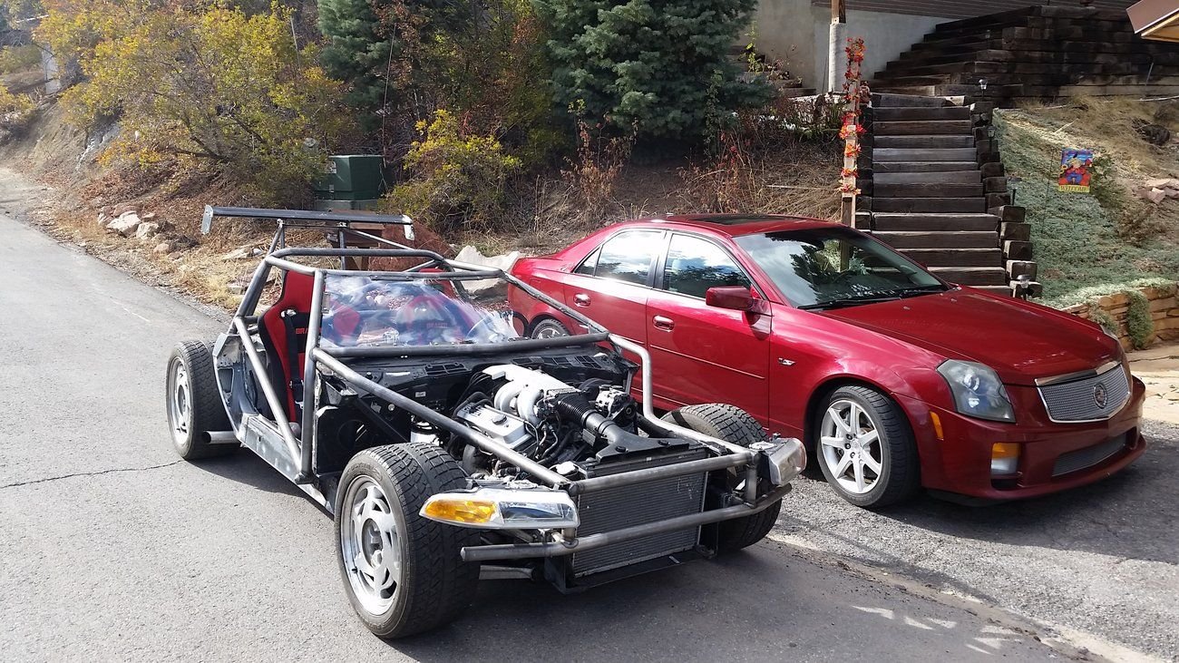

Originally Posted by wsherrard
What is a vettekart?
This is a 'Vette Kart:
Originally Posted by rbates74
Here is the broken part of my Dana44 i traded my D36 and a few random parts for it. Ive been quoted $50 for the weld and then we are going to epoxy in some sleves for the bolts and fill the rest of the spaces where it mounts. Should be stronger than stock.
The one in my 'Vette Kart was broken much the same way. I just TIG welded it and it's been fine so far.
