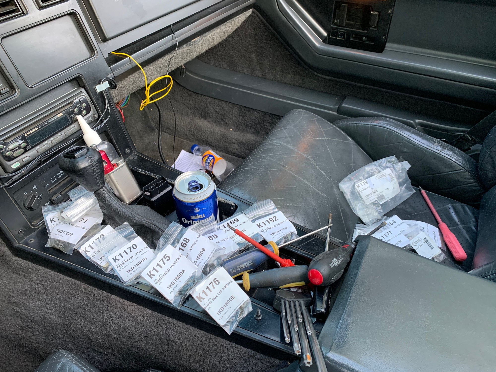

Nice screw set, even really idiot can use wrong screws 😄

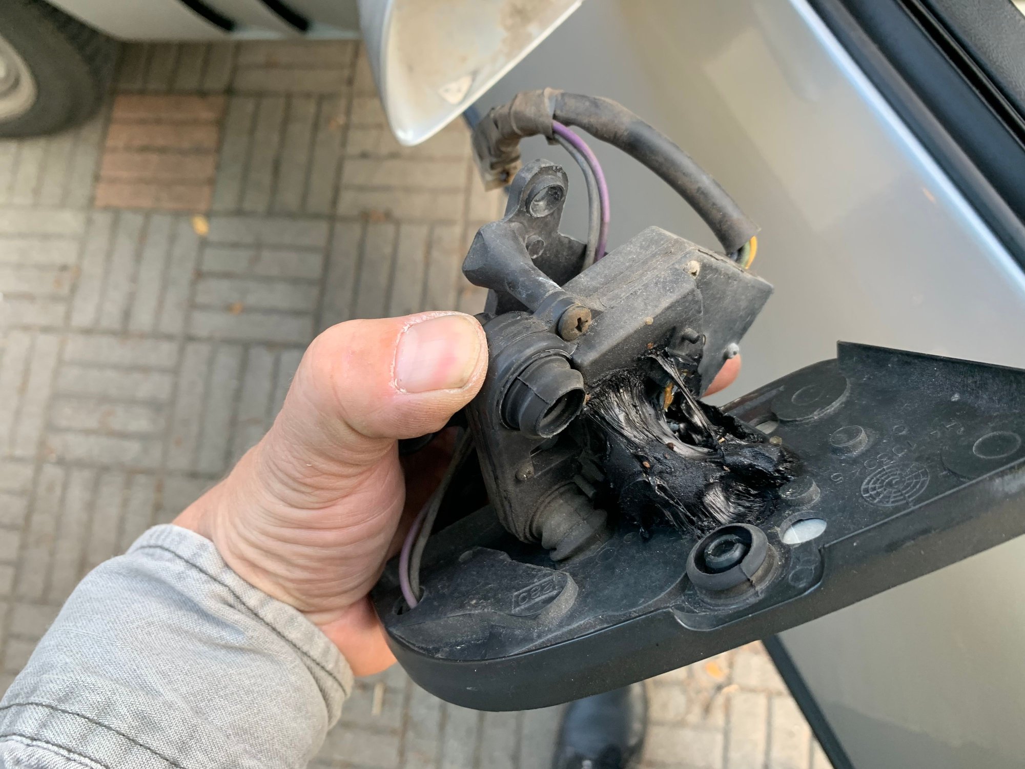

Somebody has fixed mirror by somekind chassis ’glue’

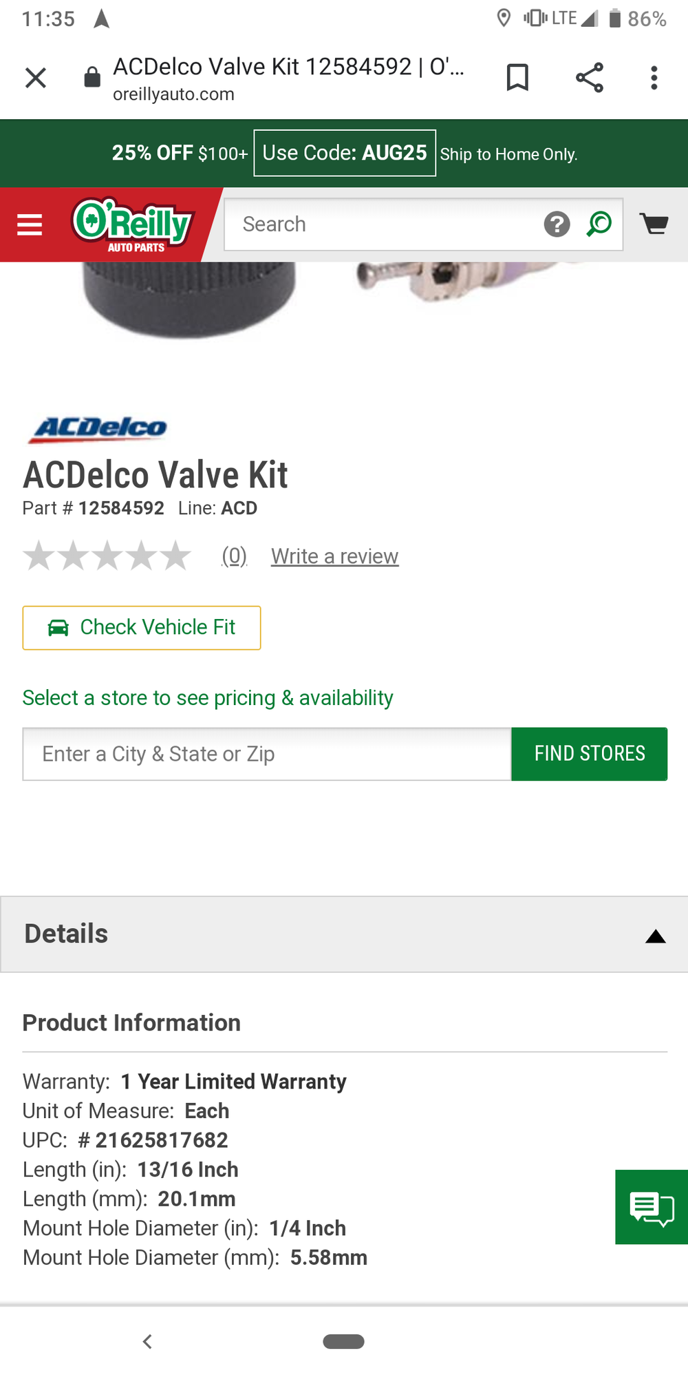

does this look like what you need?
Old Aug 17, 2019 | 12:37 PM
  #499
Pwnage1337's Avatar
Pwnage1337
Joined: Oct 2008
Posts: 3,729
Likes: 190
From: Custer, WI
This is the one I need according to the dealer
Old Aug 17, 2019 | 01:00 PM
  #500
93 ragtop's Avatar
93 ragtop
Joined: Apr 2000
Posts: 5,713
Likes: 105
From: Manassas VA
The one I posted is what I used in my LT4 fuel rail...... I"ll bet its the same.
