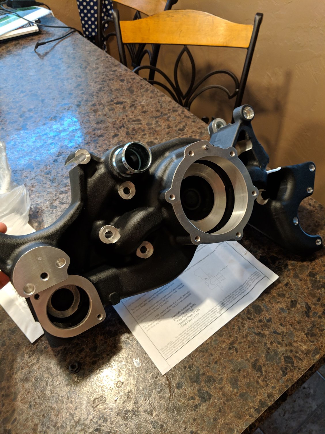

Went down to West Bend Dyno to get this big ol box. Inside is the Holley Mid-mount accessory drive!

Old Apr 16, 2019 | 08:20 PM

This is a pretty nice piece. It looks just as good as it did on the interwebs lol
Old Apr 16, 2019 | 08:48 PM

Nice looking water pump housing, I like the black powder coating. I see that you pick-up a MSD LS set-up? You still going with fast?
I can't wait to see what your engine will looking like in the car.

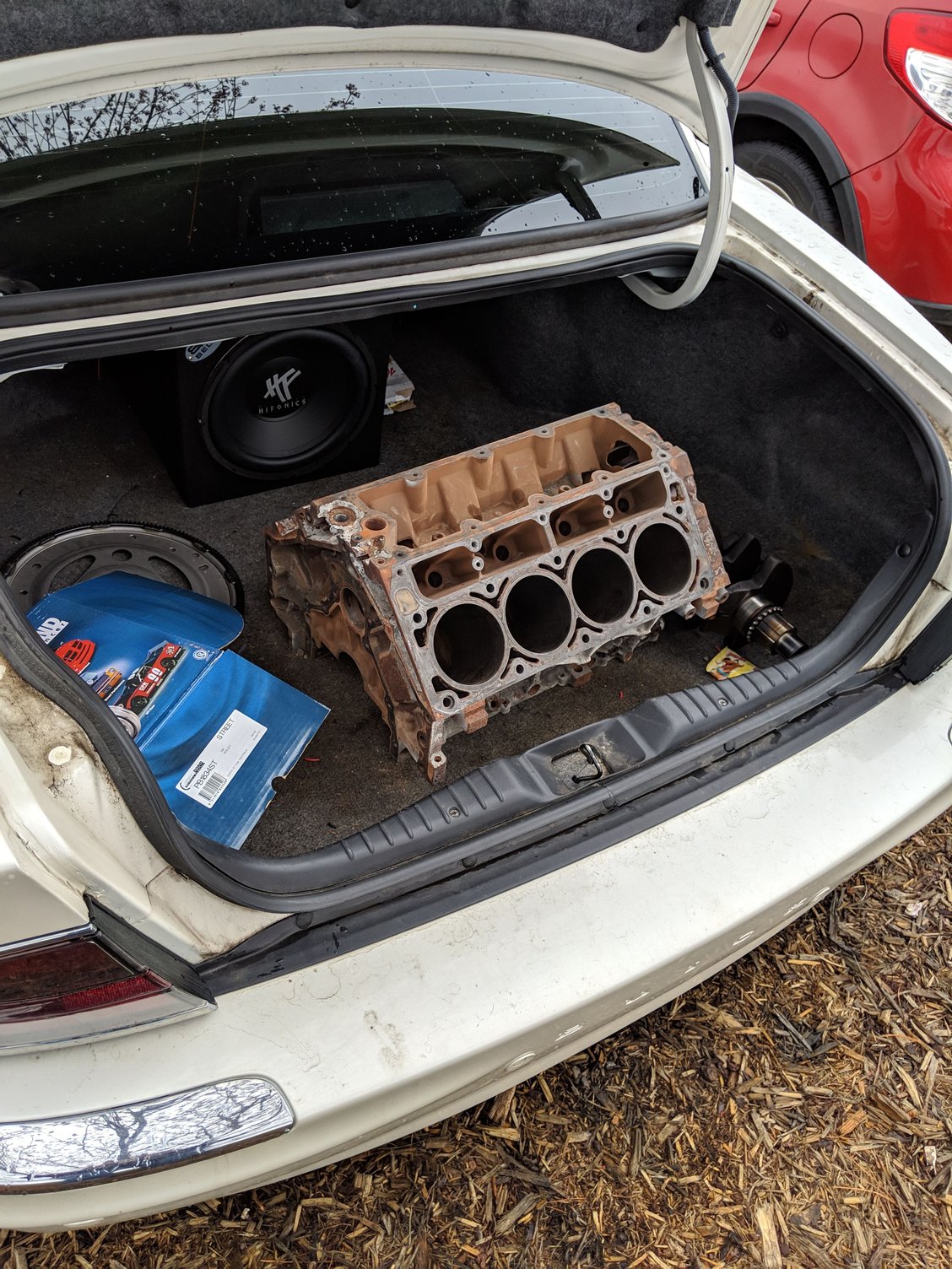

My project has been delayed. I picked up my parts and my block from the machinist because he hasn't been able to get to them and won't be able to for some time. Going to a different place tomorrow.
on a side note this v8 engine block looks like a toy in the back of my Park Ave. Easily a 6 body trunk!

Love the commentary you put in the pics
