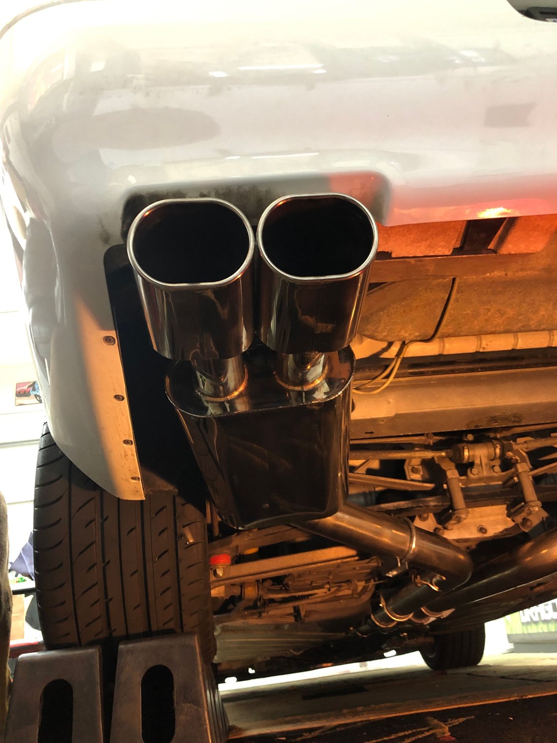

Heyya - I have the 3” Magnaflow Tru-X pipe (3” inlet/outlet) along with a 3 inch B&B 1st gen exhaust and it fits without issue. I did have to tweak the location of the pipes before the X-pipe so I didn’t cut the B&B piping - This is all mated to EM headers. Anyways the part number for the pipe is 10792 or MPE-10792. It’s a tight for but works great. I did the install in the garage but didn’t get good pics of the pipe as it hadn't crossed my mind but you can kinda see it downstream in the pic (wish it showed better but it's all I got):

I'm hard of hearing lol jk still in my 30s but this will get me there sooner - Just installed several weeks ago but its pretty loud throughout the frequency range, more of a Bass/Baritone sound than a Soprano but I love the sound. My old setup had more of a high pitched/"exotic" sound at high RPMs but wasn't for me....Anyways, this is a tad louder than my Z06 with B&B PRTs.
