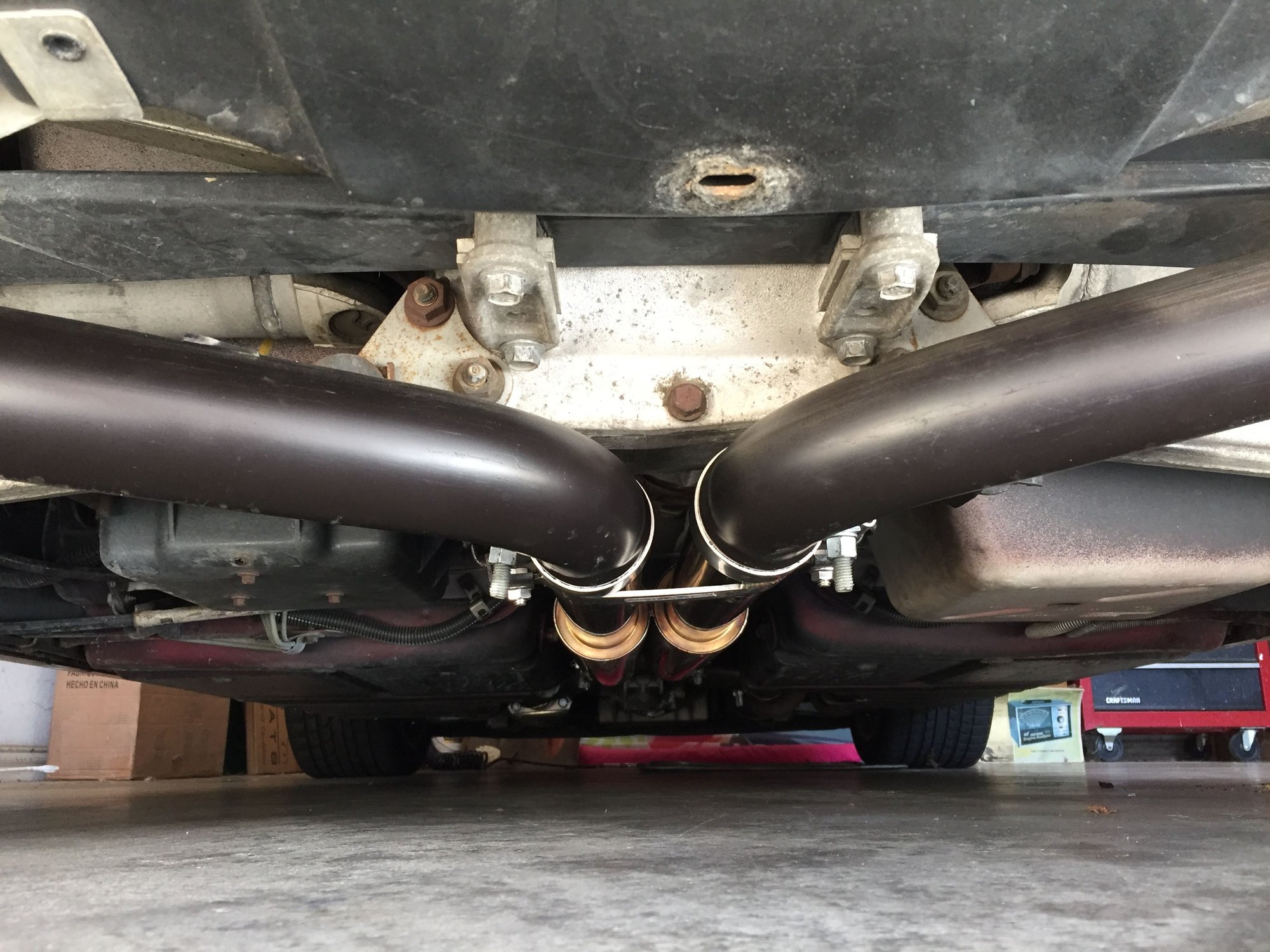

The X pipe will certainly reduce the drone but not eliminate it completely. To reduce drone you will need a set of mufflers that work on "pressure wave cancellation" rather than sound absorption.
IMHO stick with 2.5 pipes out the back rather than the 3 inch. With headers you will have already pulled most of the exhaust advantage out of the engine. The X pipe will give an ever so small "scavenging effect" and the pipe size will have very little (very little) effect on you engine unless you are running super high HP and at the upper RPM (5.5k and above). And the gain will be minimal (5hp-ish)
The biggest down side of the 3 in pipes will be fighting clearance issues under your K frame. Yes, many have successfully done this with no issues, but an equal amount will have the pipe tap-tap-tapping on acceleration and driving. If you think drone is bad couple a healthy drone with a metallic tapping noise. That will drive you bat **** crazy.
This is my clearance with a 2.5 Corsa system. Imagine another half inch?
I currently have the 3" but if that's not needed for HP then I agree the 2.5" would be easier to fit. Does your system include an x pipe?
