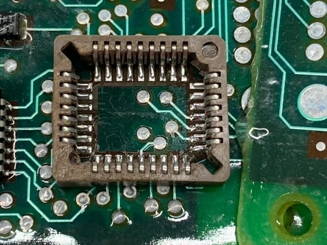

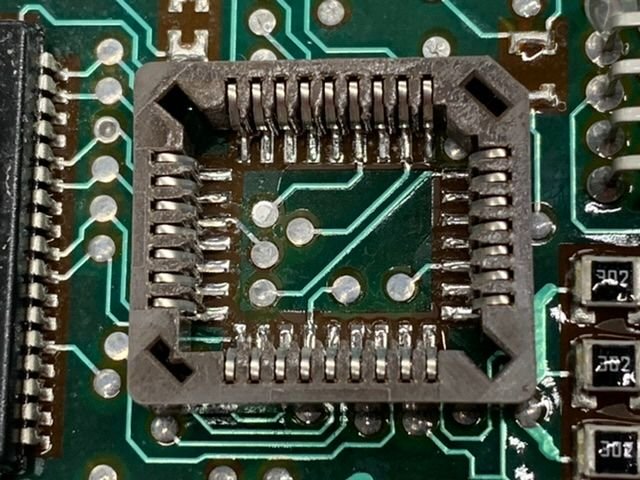

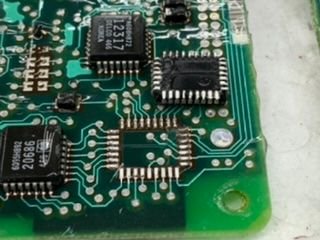

Well fellers, I’m in the PROM burning stages right now. I added sockets to the boards (wasn’t going to originally, but I found some) and if an upload fails I’ll just pull the chips and try again. Getting a proper device ID on the blue/grey EEPROM has been a little bit of an issue but I think I have it figured out. Will keep y’all updated with my progress.
Check out this soldering, tiny USB-powered iron and no visual aids 😉

Looks much better than mine.. did. Some look a little light on solder from the photo though. Maybe just the angle.
Yep the chips are slightly different due to size (not physical) if I remember right.
Burn should take like 5 -10 seconds if remember right as well.
Yeah good call to solder in sockets. I never even considered not doing sockets. Kinda wish I had dribbled a little silicone on each one to hold in place just to be sure. But have had no issue thus far.
another thing I wish I had done is burned several sets just in case. All the time is in the setup and remembering the settings needed.
But I did build a spare so there is that. I just hate being helpless when things go wrong. Now you wont be as nervous on each JET write.
Did you not pull a copy of your config first before writing? Dont understand why you needed LT4 configs.
You should be on your way soon... big job when all is said and done including getting the damn pcm out and back in. Though I only have 1.5 arms so it is a little tougher for me (partially paralyzed rt arm).
I did pull a copy over a year ago. But my calibration configuration wasn’t stock. This LT4 has a bunch of mods and it was running rich, clearly. So not knowing what the factory baseline values were I needed to find them to see what would happen.
by the way, burning went peachy, no errors. I was concerned that I may have overheated the chips on removal and harvested a small handful from various scrap PCBs I’ve collected over the years. I never paid any mind to the little 32 pin flash chips until yesterday. Now I’m harvesting them like there’s no tomorrow!

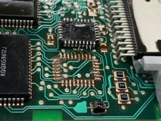

Correct solder application means the outline of the leads can be clearly seen. A blob covering the joint prevents proper inspection of the bond. Trust me on that. I’ve done a little MIL SPEC assembly work back in the mid ‘70s.
My heat gun is not an official SMD heat source but with a small mod to the outlet I’m able to raise the temperature a little and focus it better on the joints needing desoldering. I didn’t have this mod when I pulled the two EEPROMs off the boards. That’s why I was concerned that I overheated them.

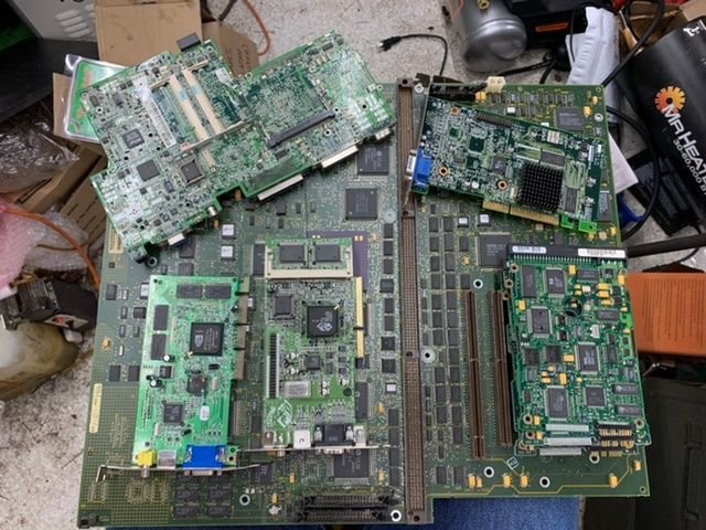

Here’s what I harvested from the big pile of boards:
...and here’s the pile. Note the two sockets in there somewhere...

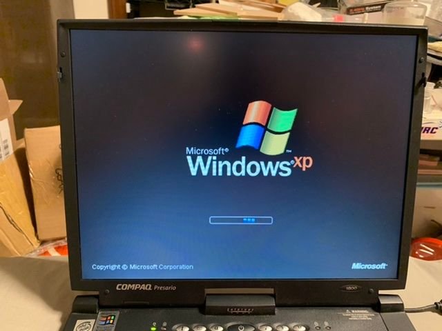

My XP laptop is up and running. I was shocked to see a desktop picture of my LT4 and Jet installed. That was done well over a year ago but my inability to fix or find it a new battery pack caused me to put the old Compaq away. I’m ready to risk running it on AC power as that’s the next step here. The search for success continues...

what make and model laptop, there are lots of batteries on eBay
That’s an old Compaq Presario 1800 series. Says Series CM2050 on the bottom. Usually a search on Amazon will net decent results with blindingly fast shipping. eBay is generally slower and I had a time crunch to deal with.
But, check this out! —————->
SUCCESS!!! 💪🏻💪🏻💪🏻💪🏻
Because I knew my as-purchased calibration file ran (although rich), I uploaded it first and got that nice, loud exhaust note back again. Oh Baby how I missed you
The Compaq laptop did the job but not having the internal battery to act as a UPS had me a little anxious. Now with that success under my belt it’s time to try some alternate tunes, as was my original intent last Sunday night.
