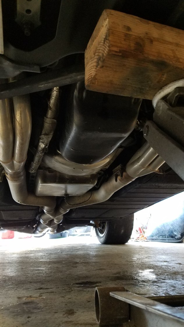

Originally Posted by Gibbles
It's been a while, but if i remember correctly i bought the center support from a later lt1 c4 vette.
It bolted right up to my 700r4
Has springs with metal tabs on the end to bolt to the exhaust.
Then i went ome step further and bought the rear support from a C5 that bolts to the rear diff.
Surprisingly it bolted right up with no mods.
Ok, is this the lt1 exhaust hanger you meant?
https://www.ebay.com/i/192889282408?...5607c2fffecd81
If so where exactly does it bolt on and do you have pictures of it on yours so I can see if it would work with the dual pipes I have? Thanks
i totally missed this, sorry!
yes, that's the center support i have, it was a perfect match for the bolts on the tail shaft on my 700r4.
best picture i have on my phone, however the hanger is on the first set of band clamps right before the first x-pipe
thats ok, thanks anyway for replying now. I took it to the exhaust shop for them to weld the right length extensions and hook it up to the headers and I asked them to put a hanger on there. They took a regular exhaust hanger and welded it to the stock hanger at the transmission mount so that will hold it up fine.
