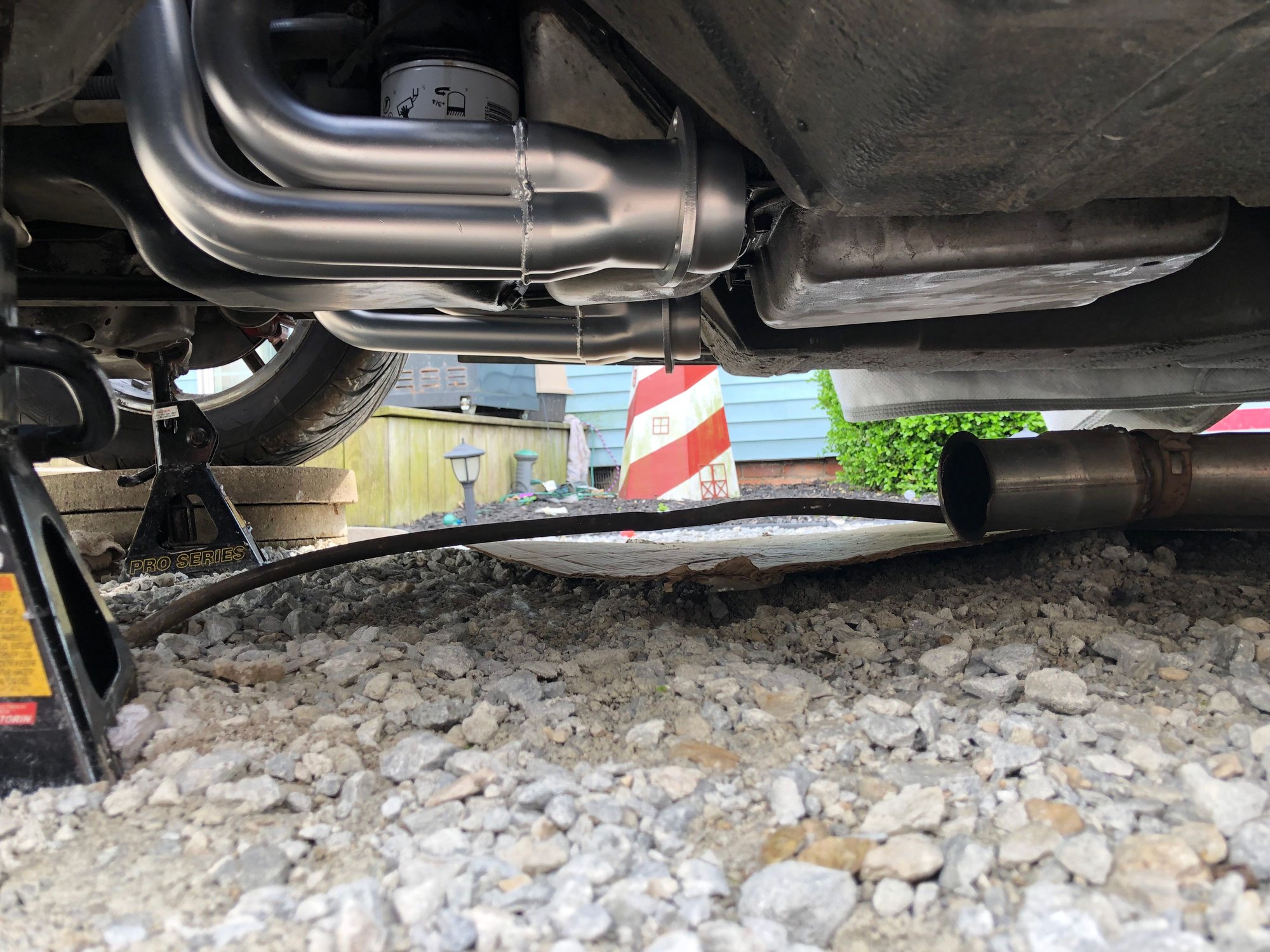

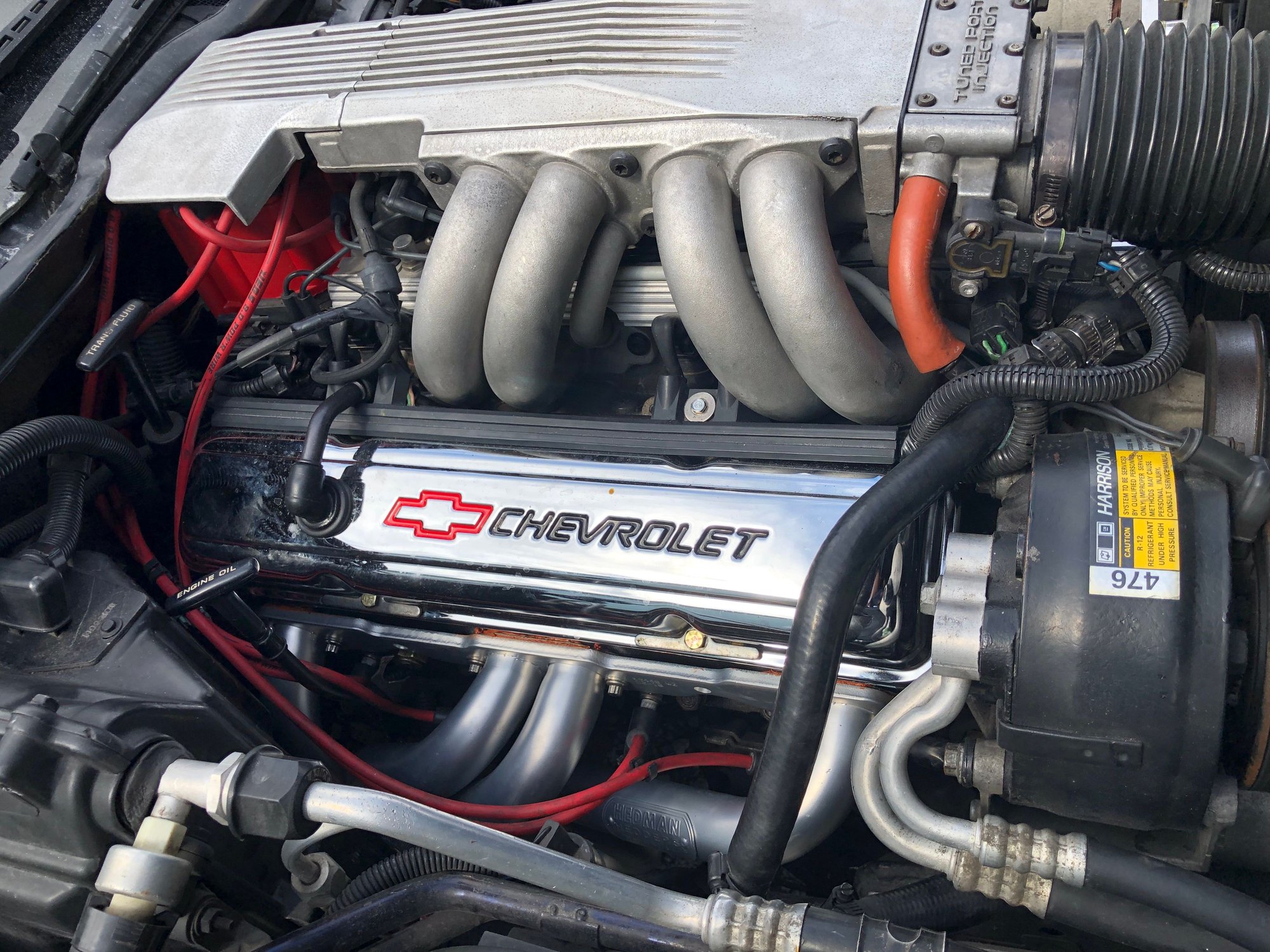

I got the rest of it all put together today except for the other exhaust pipes of course, and I bypassed the throttle body coolant as I had it apart too. These headers have plenty of clearance from the floorboard and oil filter and they are pretty much even with the oil pan so I can’t see them scraping ever. The air pump delete I found seems to be made good too and it was easy to install as they had instructions on which spacers go to which spot online plus you don’t even need to change your belt to a shorter one.

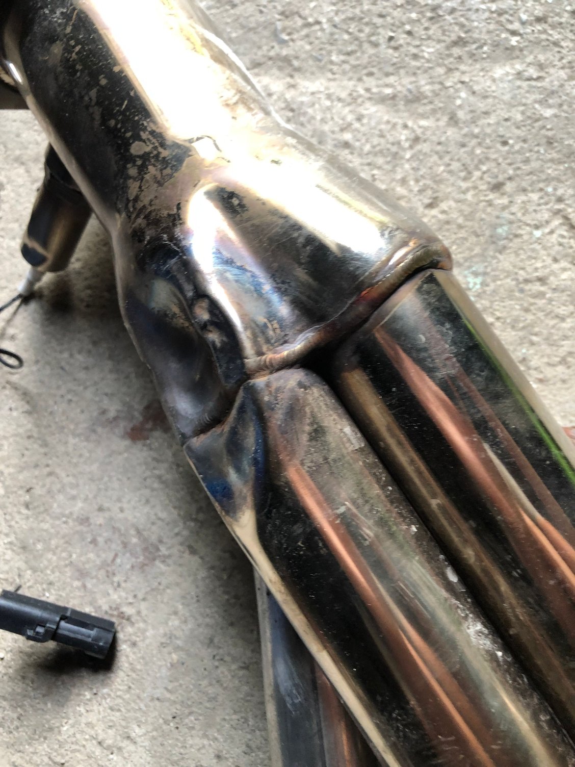

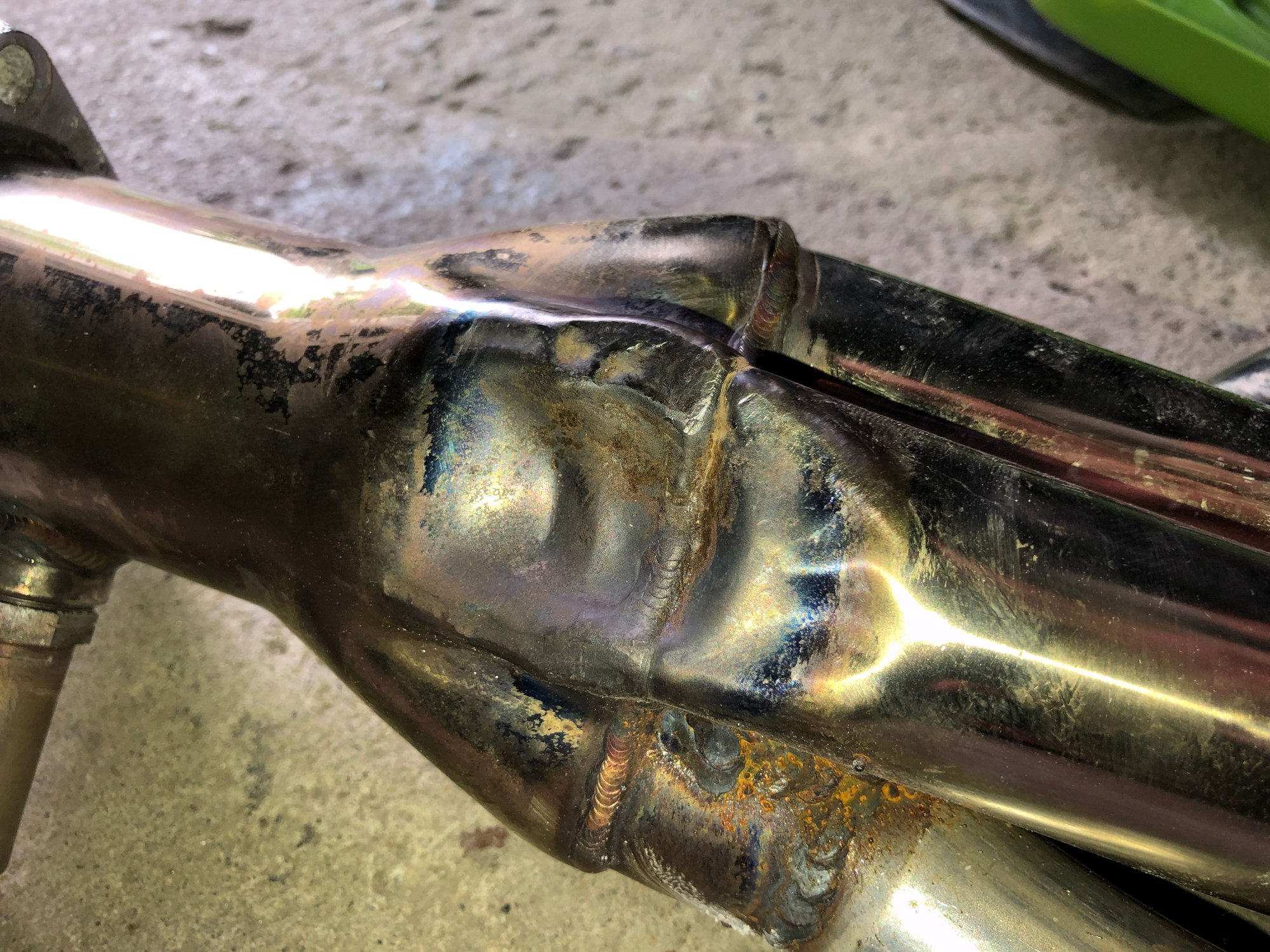

Originally Posted by anesthes
The OBX just dropped in and fit everything in the chassis. I'm not sure why his muffler shop cut the headers, but I'm willing to bet incompetence. I can't even begin to guess what that primary would have hit..
Looking at the pictures of an un-modified header and the headers on his car, it looks like they relocated the #7 primary.
Again, I ask, what did it hit??
-- Joe
I got some pictures that show exactly what the header looked like where it was rattling against the floor and almost melted through it.
This is how far they dented the header in and it still was right against the floor. And that’s the tube that they didn’t even mess with redoing. The other side they said was hitting the oil filter or right against it so it was too wide to fit on the outer side at the floor or body of the car and on the inside.
To Long tube headers
Thats a hack job if I ever seen one. Thats not acceptable in my opinion. Someone should have said something before ruining the header like that.
Ya think? IDK about you and how you work but if this were my job, I'd refuse it from the time I discovered it and tell you "I can't do this". But the store needed to find a sucker to take money from so they went ahead, knowing full well that they'd never be able to do it. At least, not make it reasonably presentable and useful for it's purpose.
