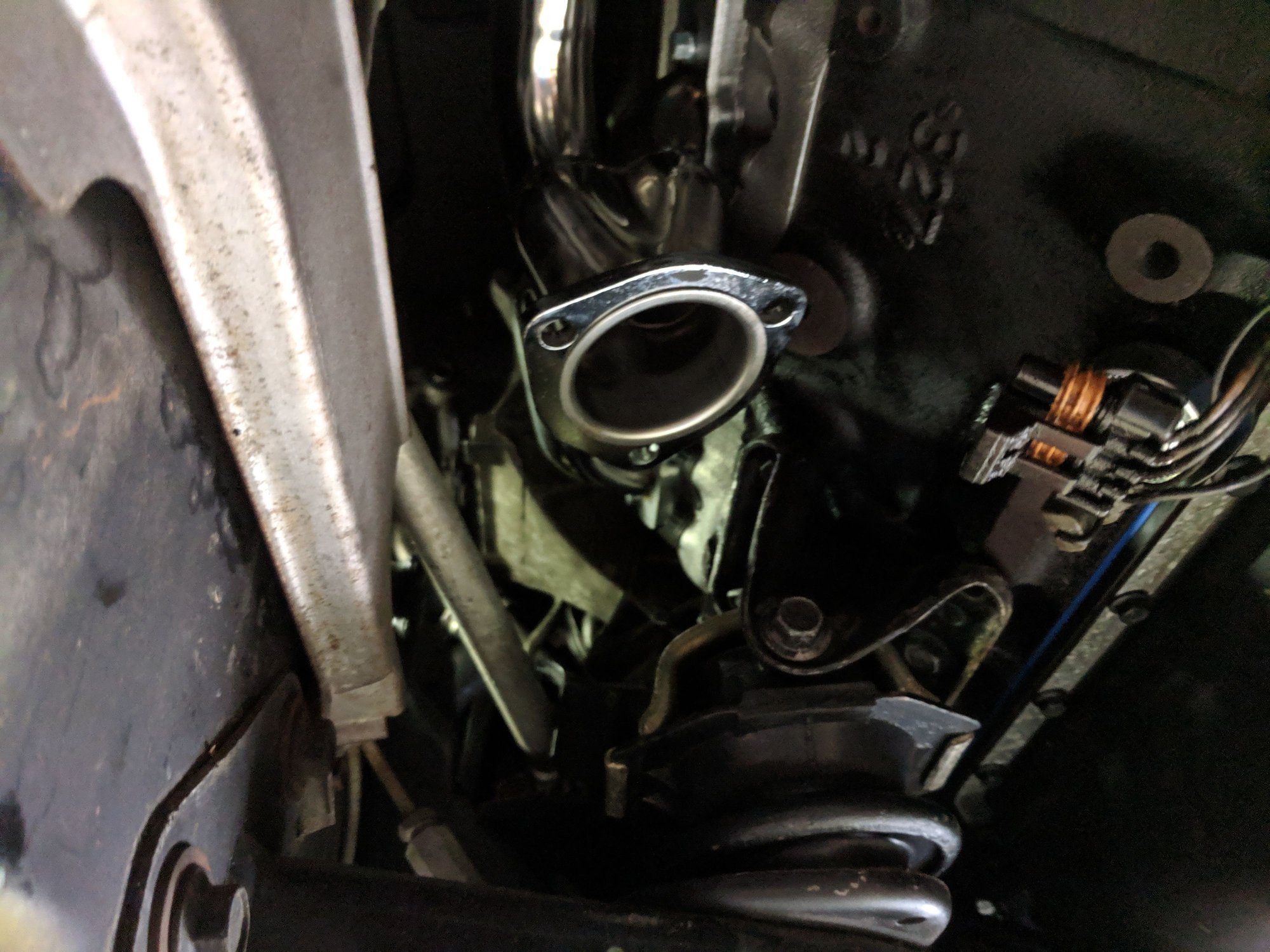

Can you get a picture from the bottom with the car jacked up?
Kinda like this:
I'm assuming the problem was the #7 primary was hitting the motor mount clamshell.

Ill try to remember to get a picture sometime. I haven’t been able to do much at all with the car lately because I broke my arm. It looks like they were telling the truth though because even after they bent that tube around to the other side it’s really close to the outer side of the car. In your picture it would be the metal piece that runs along the left side of the picture is what I’m talking about. I remember seeing that thread on your shorty headers you bought. Those look like they fit good but I want long tubes because they perform better even without a bunch of power. The exhaust shop was trying to say that all long tubes will have problems and I should just get short ones but I told them it’s just that brand must not have made them right and I will get some that actually fit at some point because I know of lots of people on here of course that have long tubes and they don’t even hang down any further than the regular exhaust.
You can't expect them to make lemonade out of the rotten lemon they got. They want you to get shorty headers because they can charge money for the install, have it simple and you are happy. IF all LT headers are problems, I think I got the magic ones from TPIS for my C4 and Accel supplied my magic ones for my F-body (although they were Tri-Y). Whatever they are smoking, they should at least have given you a few hits of it.

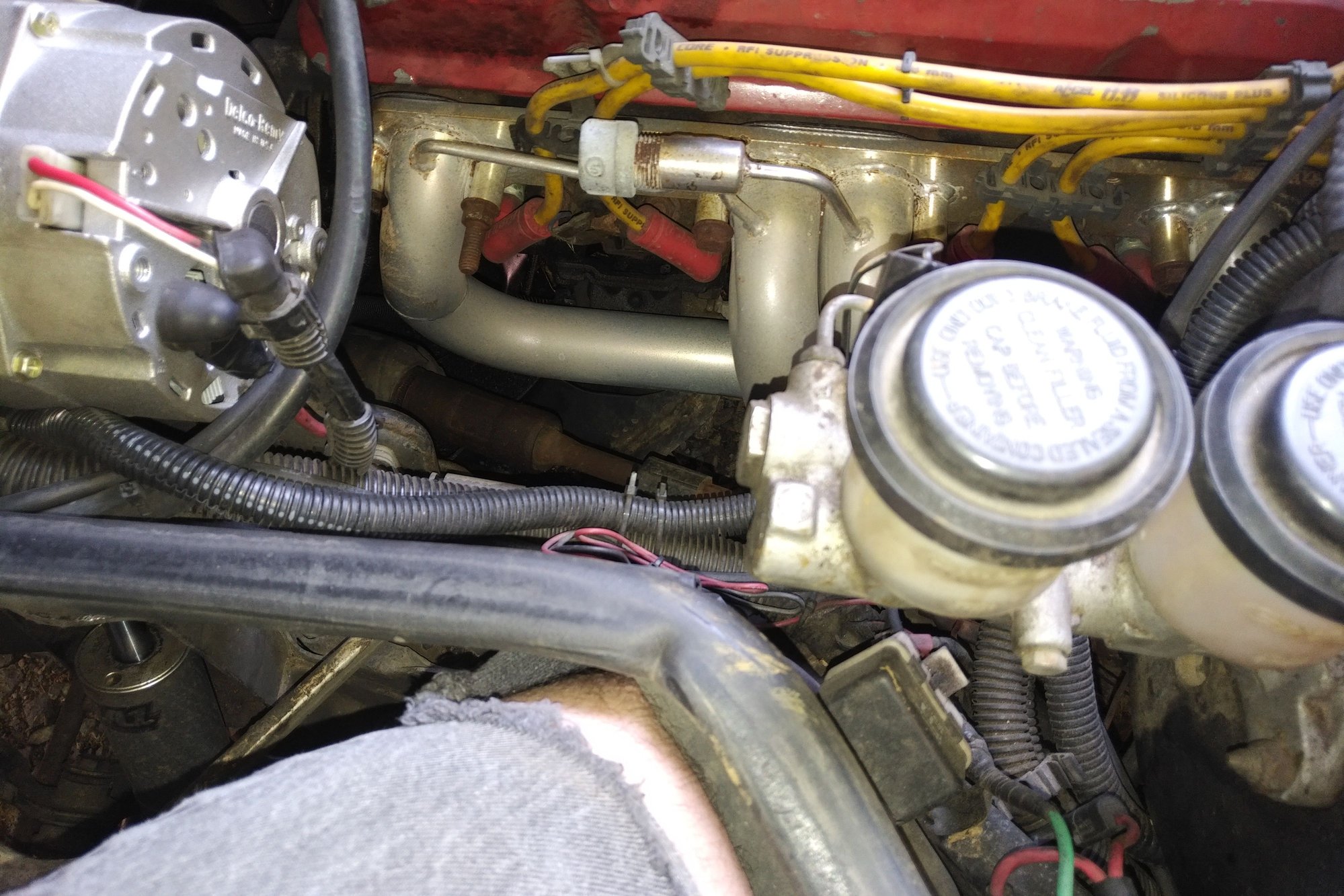

on a side note, regarding cheap header hiting engine mount... its not uncomment to have to lift the enginer (undo the mount) to make room to slide the header in. But once installed, no longer hits the mount. But I guess the problem with the aftermarket ebay stuff is quality control. plenty of people have installed them successfuly. But sometimes get a bad one. also got to have an installer commited to dealing with the extra hassle, and who has the skill set. typically an hourly rate not flat rate. So many shops are just basic parts replacers, sorry the situation happened. but good decission to stick with long tube for your replacement. as there is barely any gain without long. although im concerned your repeating the problem. I found that my car with the hedman header, im able to get all the plugs out after learning which exact tool I needed for each cylinder. so they work. but it still takes me twice as long to swap the plugs than on my car with the tips. headers. and then there is the issue of getting other gauges on the spark plug holes, like doing compression tests or leakdown tests, where the hole wont make the bend radius. its just an ongoing head ache maintaining my car with the headman. I heard the stainlesswork headers also worked ok, except for needing to remove the starter. the hedman long tube are inexpensive, probly under 600 for the ceramic coated ones. But If I ever have to do it again, I'll be doing with the tpis or arh. if I can afford it, I wont do it at all. to me one of the biggest factors is ease of maintenance after the headers are on.
Old May 26, 2019 | 04:10 PM
  #120
tdereggi's Avatar
tdereggi
Joined: Aug 2013
Posts: 153
Likes: 17
From: Boyds MD
tpis
look how tube under plugs to leave clearance
