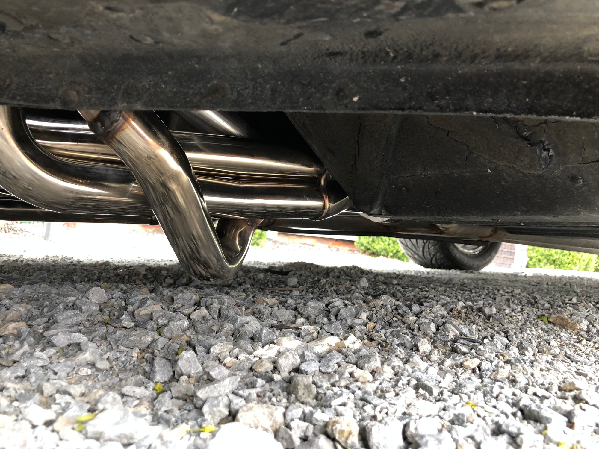

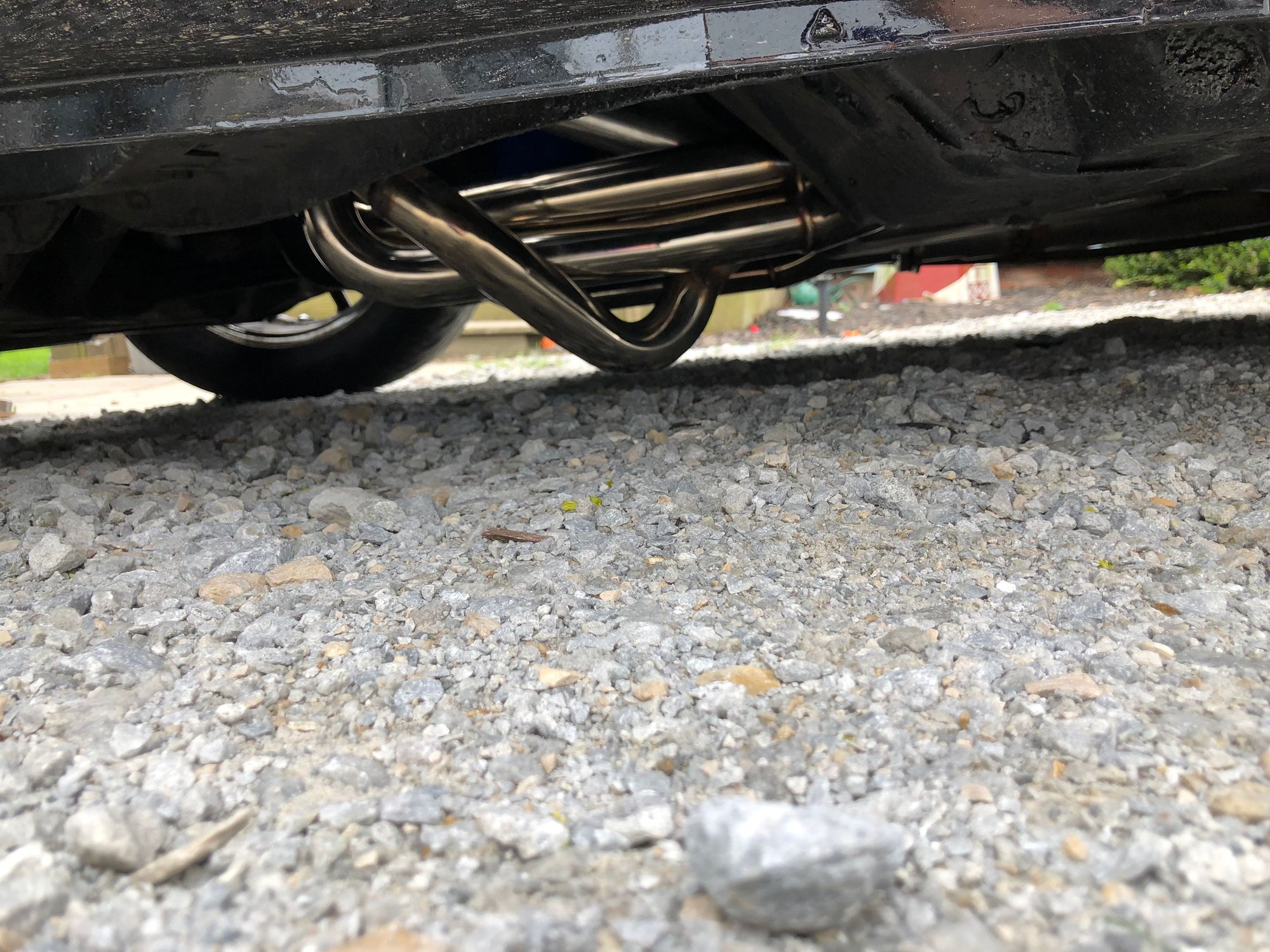

Well some of you were right and I wouldn’t recommend the eBay phab headers to anyone. They didn’t fit at all and I didn’t think I could return them so I told the exhaust shop to see if there was any way they could make them fit even if they had to cut them. So they had to pretty much replace two whole primary tubes on the driver side. It didn’t fit between the frame while lining up to the cylinder head. Now one pipe hangs down really low and I’m going to have to get new ones soon. The passenger wide wasn’t horrible, just the number 8 tube needed dented pretty far to clear the condenser I think it’s called. But the seller did at least make it right when i complained to them and they gave a full refund back. So I can’t complain that much about them.

That looks really bad. One mini speed bump and your #4 exhaust will be closed. Cut your losses (what you paid the shop) and get a set of ARH headers. Is that primary the one the shop spliced?

Yeah, it didn’t fit the way it was before so they bent it around them and added some more tubing. I’m hoping they last just a while til maybe next year sometime because I’m saving up for a FIRST intake, edelbrock e street or afr 190 heads, and a cam and I will just get some hedmans then to put on. I will delete the air pump then too.

From the pic, all it will take is some unevenness in the road. I guess the old joke of "How's it hanging there?" applies? Answer would be "About an inch above the ground.".

Why didn't they fit?
Do you have pictures of what "didn't fit" ??

The OBX just dropped in and fit everything in the chassis. I'm not sure why his muffler shop cut the headers, but I'm willing to bet incompetence. I can't even begin to guess what that primary would have hit..
Looking at the pictures of an un-modified header and the headers on his car, it looks like they relocated the #7 primary.
Again, I ask, what did it hit??

Well they called me and they just said they aren’t going to work at first. They said they went to put them in from the bottom and where they come all together around the collector it’s too far outward and hits the frame. I told them I think it’s past the time of retuning them so if they could make them work any way, even if they could cut them and make it longer or something to just go ahead and do that. So then they cut them and ended up bending that pipe around so it wouldn’t hit the body under there and now it hangs real low.
