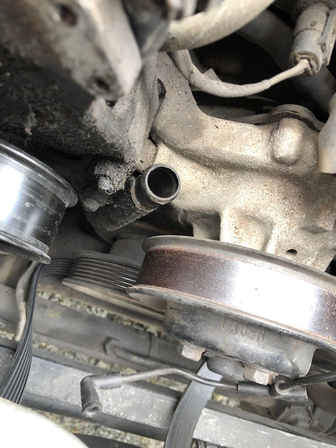

I removed all the air pumps pipes and divereter valves, one thing I wondered is what anyone does with this pipe that was attached to one of them here.
It’s right by the water pump and I don’t think it can be removed. Is it fine to just leave it there or should I block it off with something or what? I will plug those vaccum lines that attached to the air pump diverter valves with something but I don’t know what I should do with that pipe. Thanks for any help.
Iirc that's the one that goes down to the cat. I'd just cap it.

No the one that goes to the car runs by the passenger exhaust manifold and I already removed that one. Do you think I should just put a rubber hose over it and screw a bolt into that to cap it?

Can you track it and see what it goes to? It seems a little bit thick for the AIR tube to the cat but mine fell off eons ago.

I’ll look at it more tomorrow but I think it’s the valve corvette_bob was saying to connect the hose to if you were to keep the air pump. I think it’s the one that the air pump pushes air to when it’s not calling for it to be pumped through the manifolds and cat so it just pumps the air down and away from everything.

That looks like the pipe that goes from each header to the pump. You either have to remove some stuff or cut it to get it off.

I recently removed the air pump stuff from my 85. That looks like the intake pipe for the pump. It had some filter looking thing on the bottom. I managed to remove mine.
Do you know how you removed it? I thought it might be just those two nuts holding it on but then I thought I remembered others saying to just leave that one their because it can’t be removed so I didn’t mess with it. I’ll be looking at it more tomorrow, and the headers should be here tomorrow too. Then the air pump delete will be here Thursday.

I thought it just had a tab or 2 with bolts in it. There's no harm leaving it there though.

That is the one I was talking about for venting the air from the pump. I’m pretty sure you can take it off with no consequences.

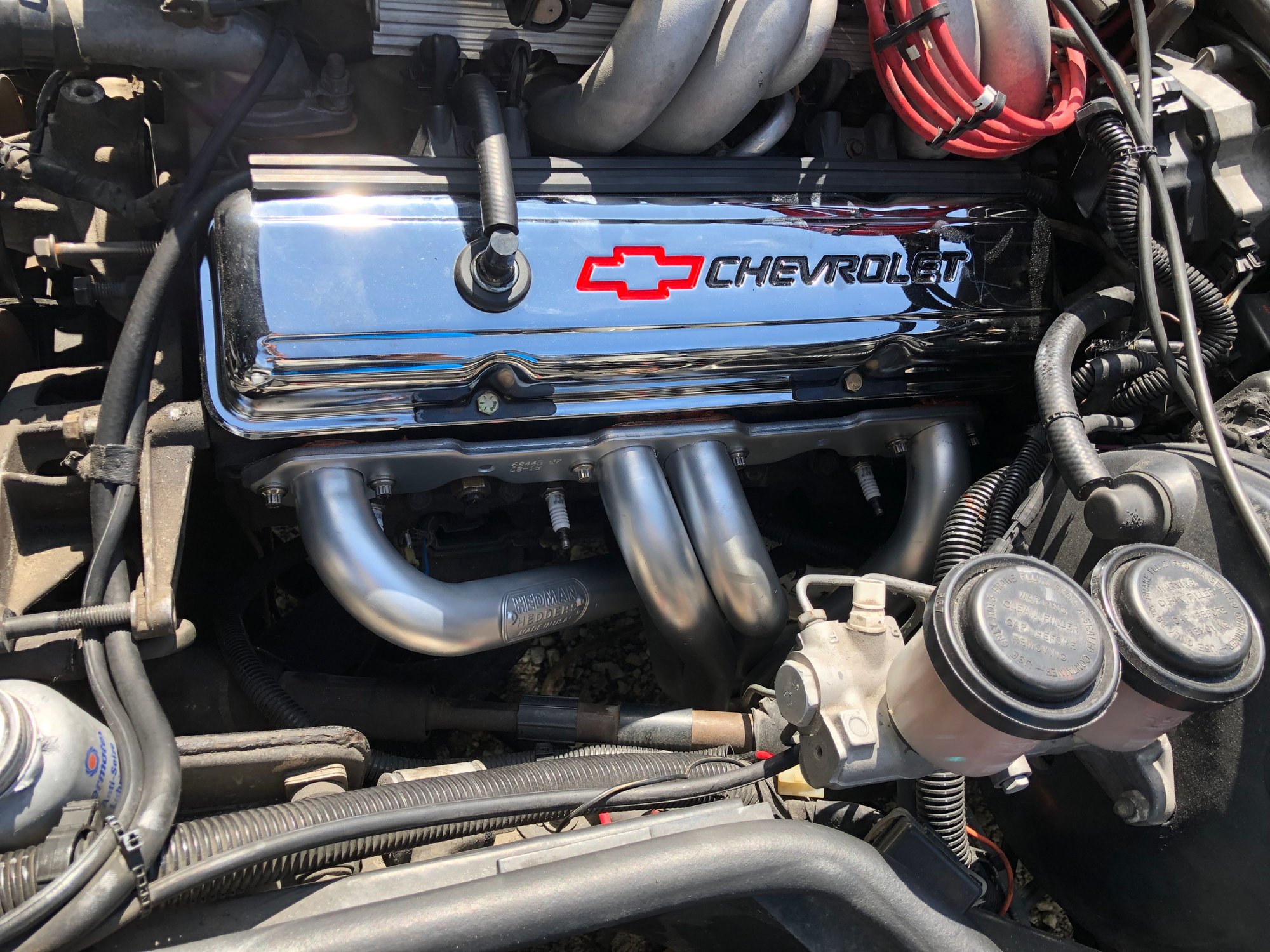

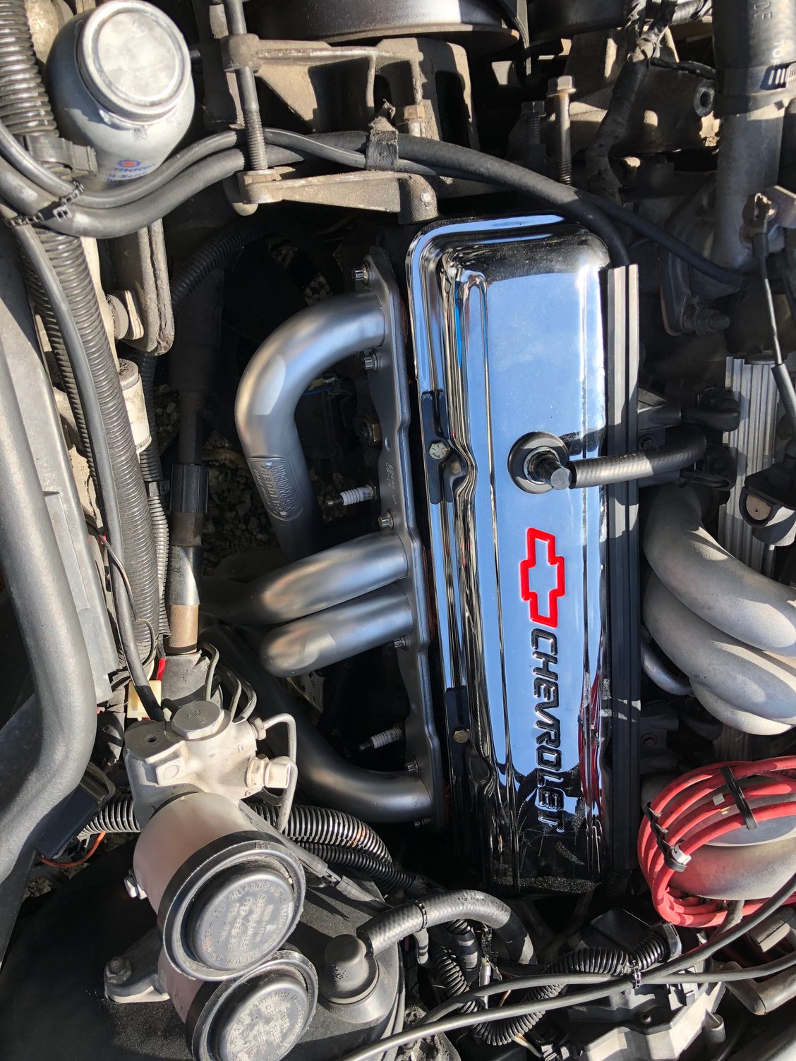

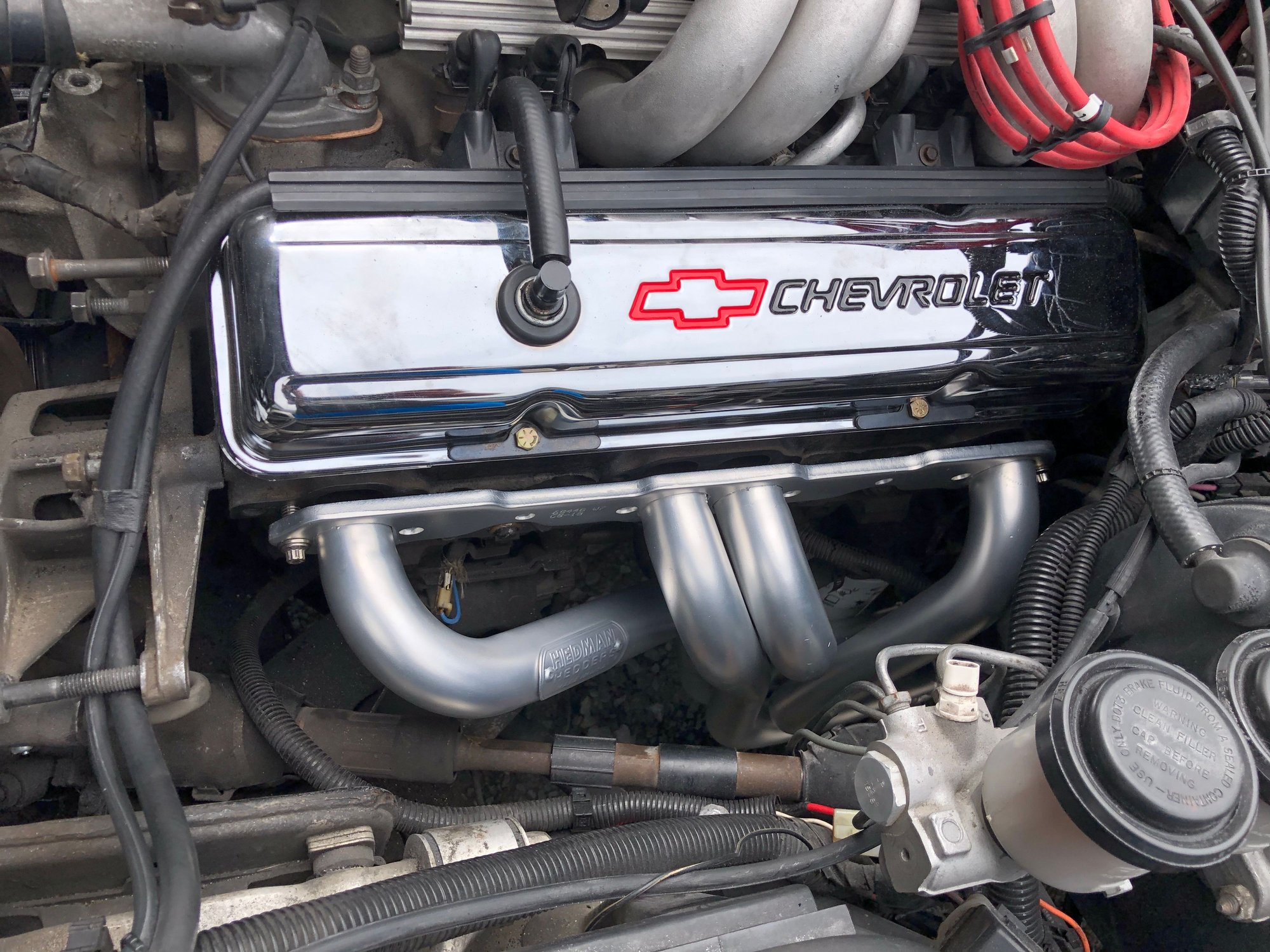

Thanks I took that other air pump pipe off, it was just the two nuts holding it on and it was that filter looking thing at the bottom of it. I also got the headers on today. They fit good, it’s kind of hard to get to spark plugs like you guys said but there’s plenty of clearance for everything else unlike the other headers that are hitting the floor board. I had to start it just a second to hear it with open headers. I took a small video of the sound but it won’t upload for some reason. I didn’t get a picture of the passenger side but even that side was pretty easy to put on, I didn’t even have to remove the starter. I just took the two main bolts out and left the bracket holding it up there so that it could move a little. The drivers side just slid right in from the top and didn’t even need pushed in or anything because it fit good.
Did you plug up the cat when you took off the AIR pipe going to it?
I thought you said the headers had plenty of clearance so how is it hard to get to the spark plugs? I thought the issue was that the headers phabulous headers was that it was a little close to the ground?

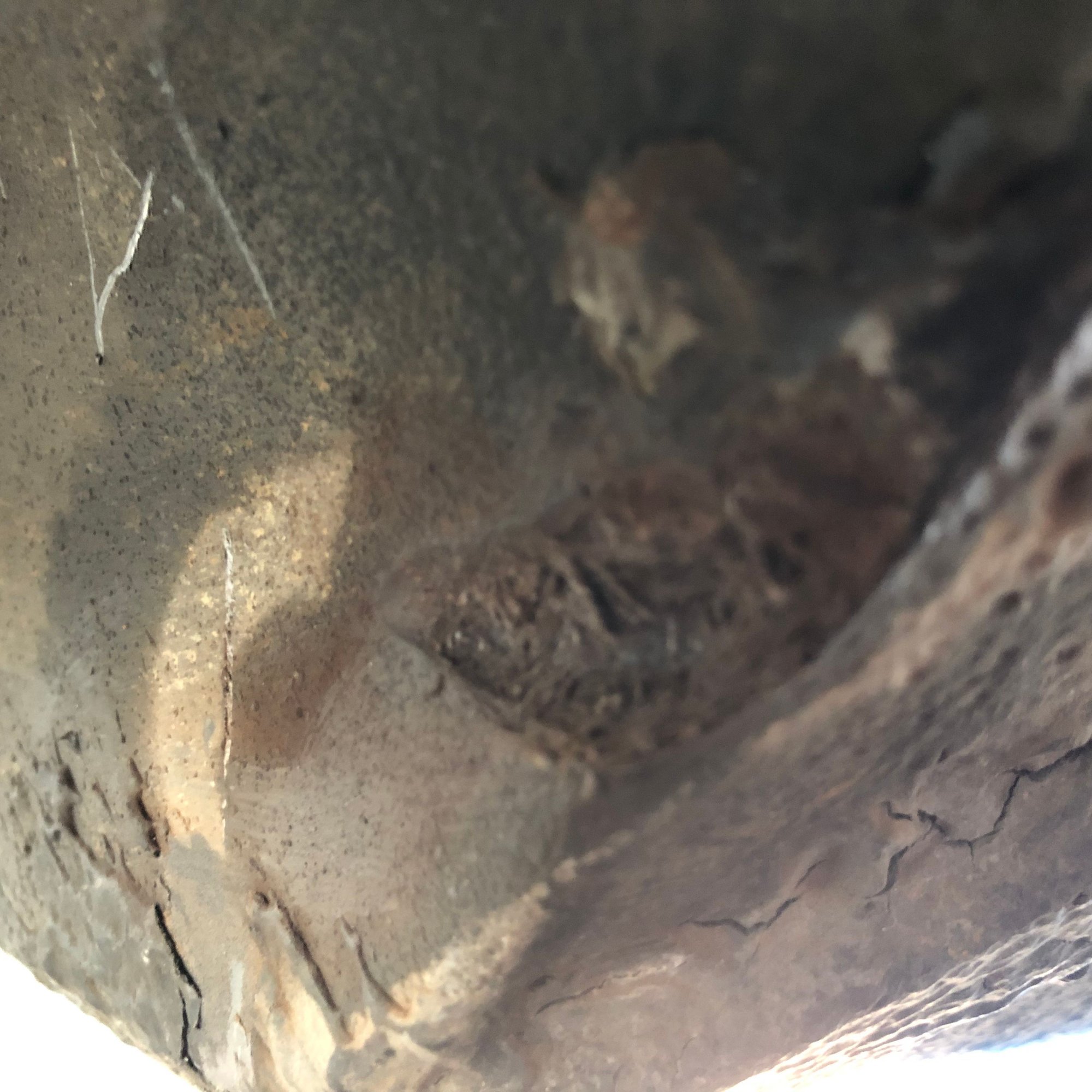

Old May 29, 2019 | 10:47 PM
  #140
85 CRVET's Avatar
85 CRVET
Joined: May 2018
Posts: 506
Likes: 52

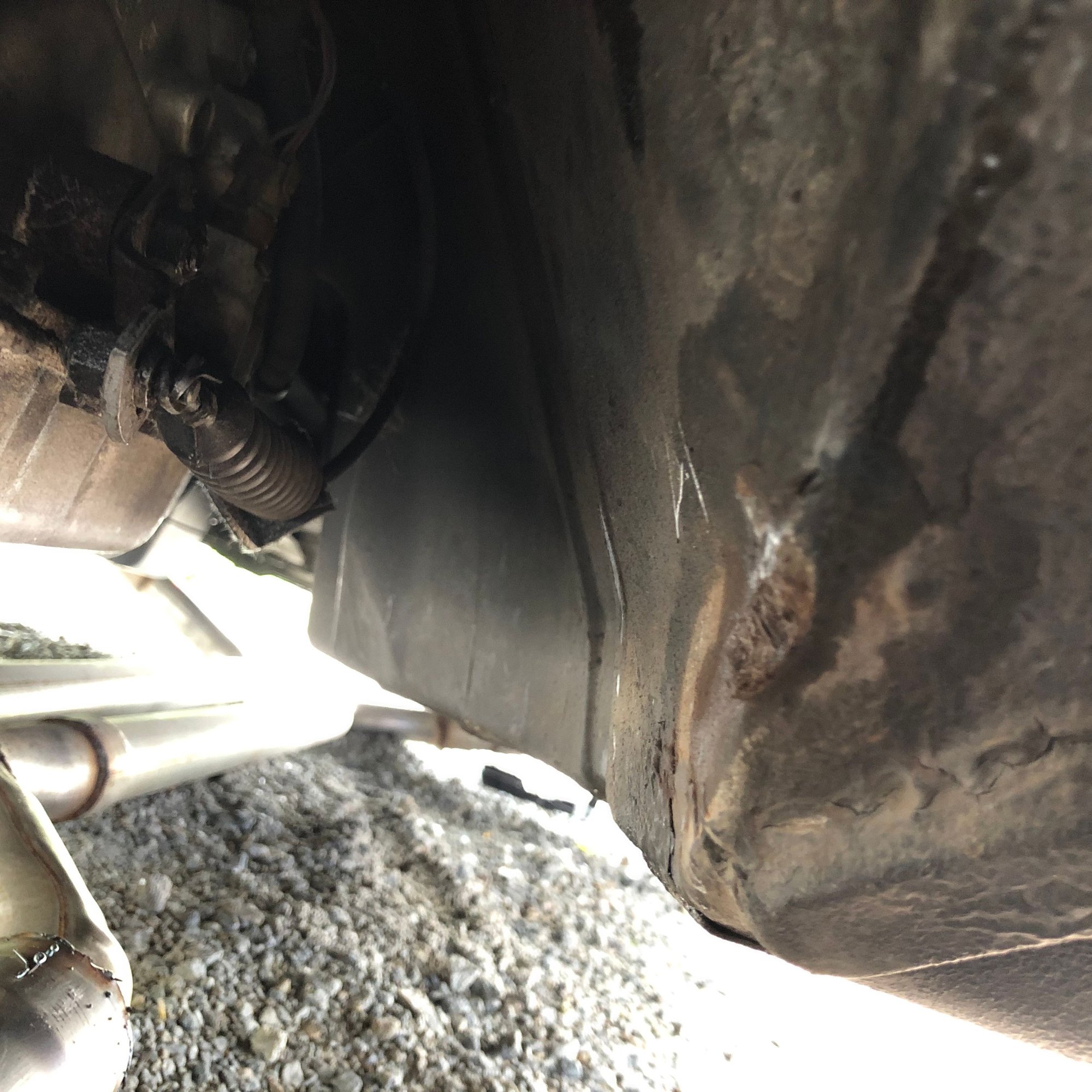

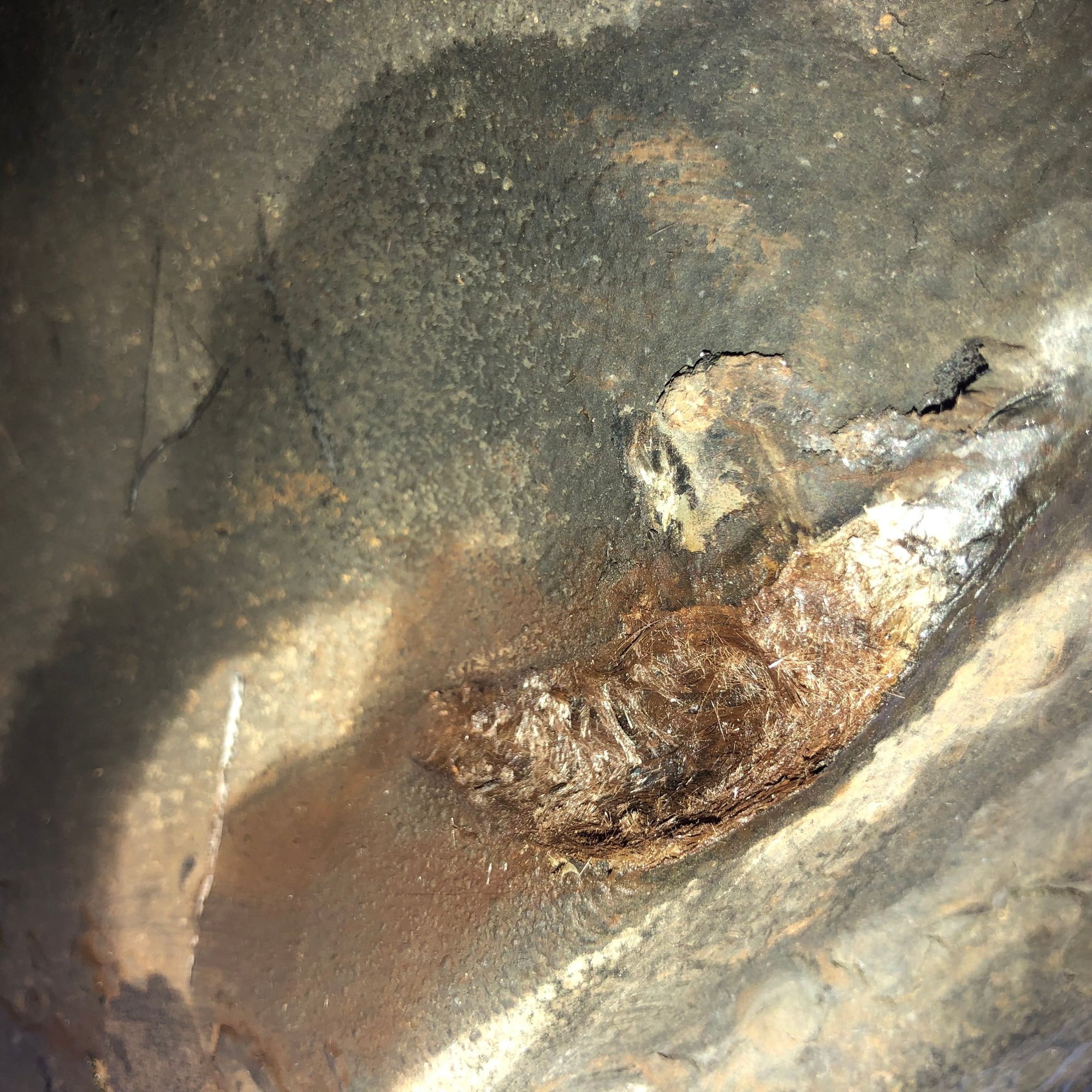

Originally Posted by anesthes
Can you get a picture from the bottom with the car jacked up?
I'm assuming the problem was the #7 primary was hitting the motor mount clamshell.
-- Joe
Here’s some pictures I took. I couldn’t really get any good with the headers installed still. I’ll get a picture of how they dented the header to try to make it work and still wasn’t far enough away too. The header was against the floor and almost melted a hole through it. And those were the pipes they didn’t even mess with so I wouldn’t recommend you to try some of these. One thing I wanted to ask is what any of you do when you have dual pipes and headers. When I took the exhaust off the only thing holding up the pipes was the hangers on the tailpipes and the connection at the headers. I don’t have any cats so that keeps it lighter but is this ok because the hedman headers said they could crack with weight on the headers like that?
