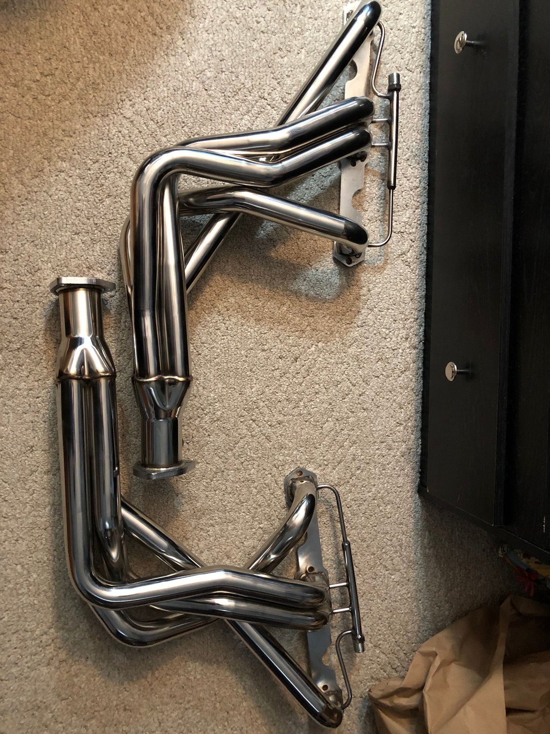

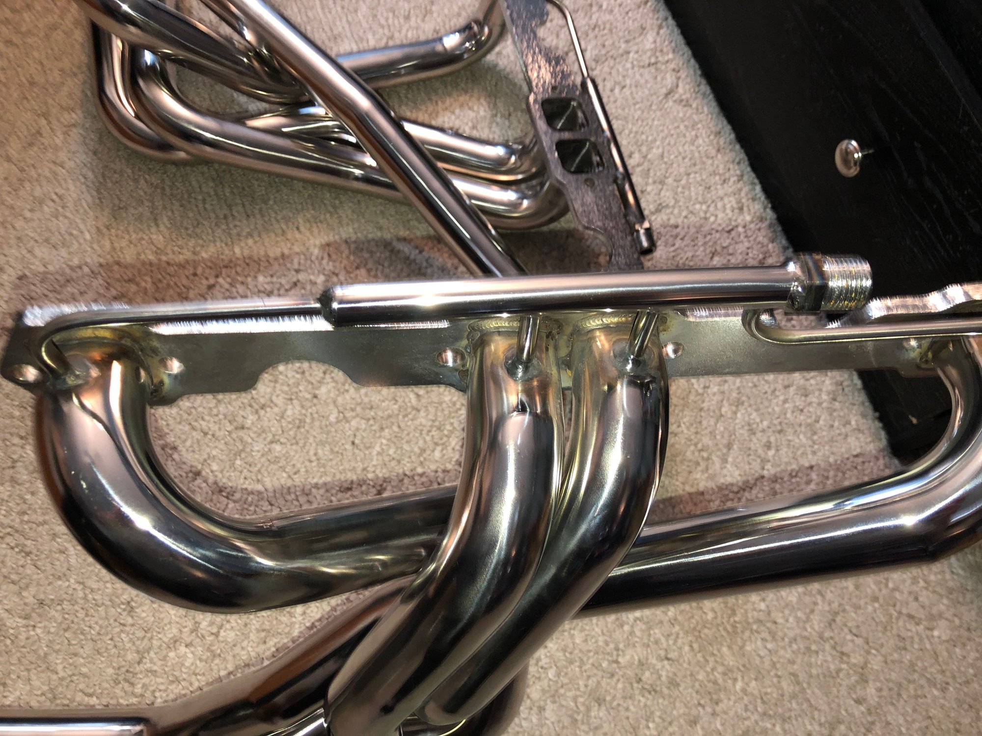

Here’s the pictures of the headers, I think they look good and they are 304 stainless like they said because I checked with a magnet and they aren’t magnetic except for bends where heat gets to them. They have 3/8” flange too by the way.
Wow. You are going to hate life when it comes time to change plugs I think.
my old vs new. Them Primary location looks like it will be tough to get to plugs. But if they fit good and you like them all good.
Yes but that's tomorrow's problem. People will enjoy the low price today and not be concerned about tomorrow's headache.

I never thought about that, they do look like they could be close, but I’ll see about that after they’re installed. But I looked at some obx headers and the bends look identical to those, I think these phab headers are exact copies of obx. I don’t know how people’s spark plug clearance with the obx is though.
