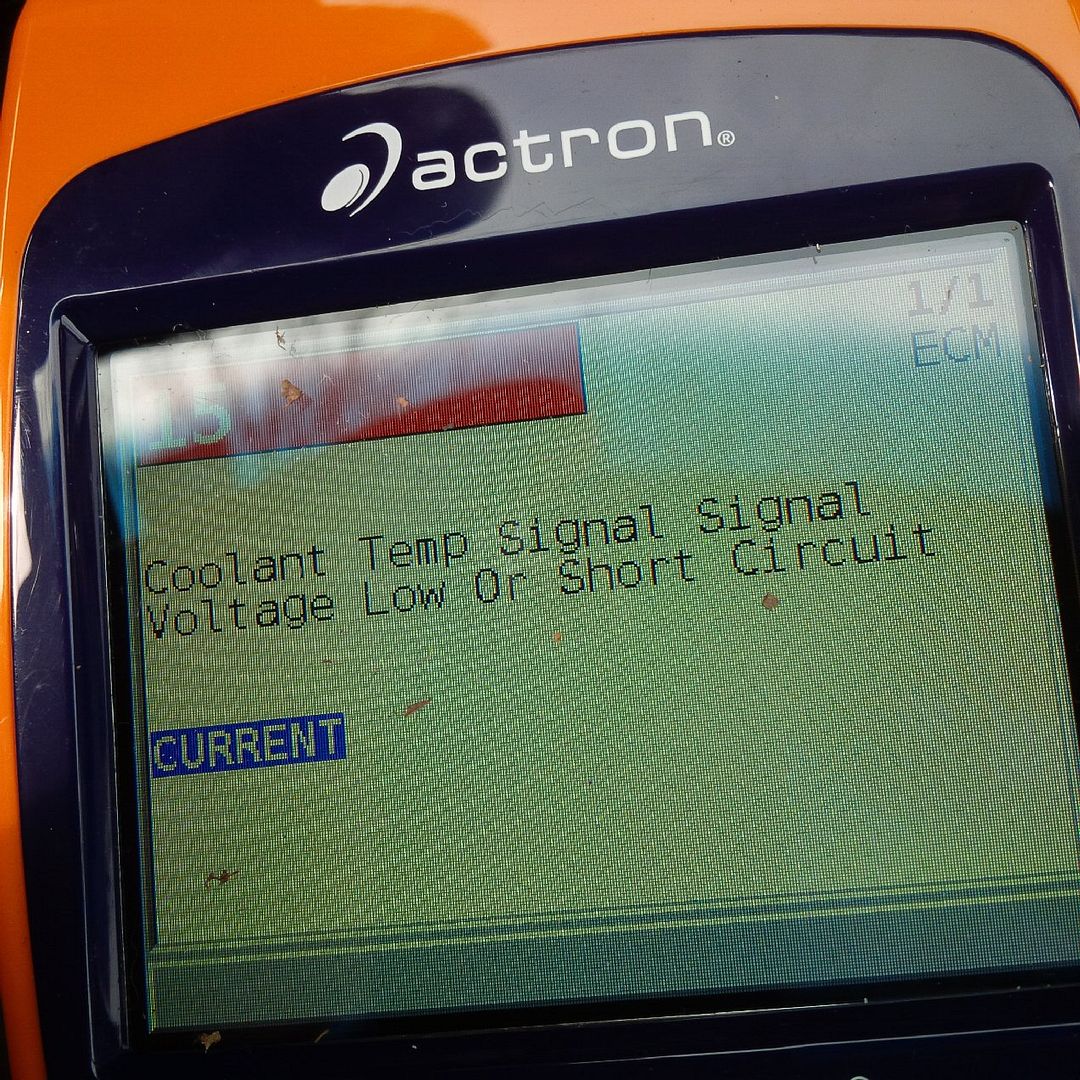

I previously had a thread regarding my scanner not connecting to my 91. Finally got it to read and got code 15. Would this mean an electrical issue or that the CTS is bad?

I do have the 9690, but based on the code 15 showing voltage low or short of the CTS I tried unplugging the CTS https://www.corvetteforum.com/forums...i-resoved.html and found that did resolve the issue I was having. Now that I know the answer to that problem I can concentrate on the electrical wiring issue with the power seats and locks that is causing the accessory breaker to trip and get hot.
