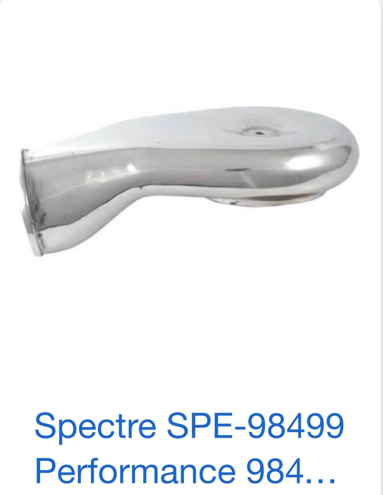

It has a edelbrock 1002 it’s pretty low and smashed in on top but still hits
but I am thinking of trying a spectre
Im not sure the high difference tho, the wiring is ok it runs and has no problems driving just being particular about setup

What intake was used in the conversion? I have a carbed 84 with a zz4 intake and a a 2" filter works okay. I later installed a hood scoop due to me using a 1/2 " carb spacer and to let some fresh air in to combat fuel percolation. I use a 3" filter now. I had a similar spectre air cleaner like the one shown and it was way too restrictive. I suspect your intake and or any carb spacer used may be causing your clearance problem. Try to use a plastic or wood spacer.....you will need one!
