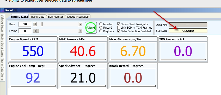

Does anyone know where DataCat shows if the car is in OPEN LOOP or CLOSED LOOP? Most programs I have seen its in the top banner, but I can't seem to find it. I was having high idle even after warmed up, realized someone had just adjusted the throttle stop way up to keep it idling at 1100. Now that is turned down, It doesn't fast idle when cold, so want to see if its readying the temp sensor and acting accordingly or not.
92 LT1 with built 383, so idel is set in the 750-800 range as a baseline.

Is this CLOSED mean closed loop? and when its "synchronized" its in open loop?

Within the Engine Data Items tab, select bitwise items to search/display by checking the Bit box. You should find a Closed Loop Active flag that you can select.
