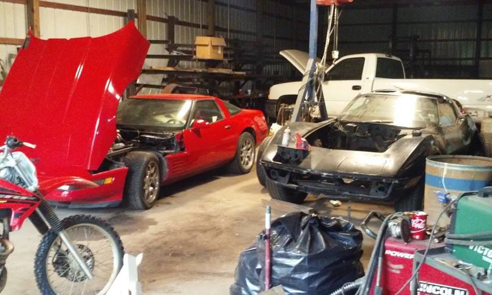

This is my 91, that is my dads 73 were building, my brother has 75.
