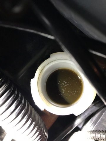

On the way to work yesterday, the car did a few things that it hasn’t done before.
1. A couple times, while I was rolling up to a stop sign with the clutch engaged, I heard a short squeal, almost like a belt slipping. Only happened twice for a split second.
2. I noticed that the clutch pedal felt softer than normal, maybe even a little spongy. Don’t know if it just started or if its been that way and I just noticed since I’m hyper focused on the clutch now.
3. Goes into gear fine, but a few times after I put it in gear (2nd and 3rd) and released the clutch, I felt a slight vibration through the shifter.
On a hunch, I checked the clutch fluid and it looks like it may not have ever been changed. The clutch on the car only has 3K miles on it, so I’m hoping it’s something less troublesome to fix. Do these symptoms seem more in line with clutch fluid issues or something more in depth?

That fluid looks quite old! I would pull some out and place on white cloth to see if it is contaminated I do not trust any one working on my car unless i am standing there watching them.

I made some progress today. I changed the clutch fluid and the clutch feel is worlds different. The clutch is much more firm, no more vibration when the clutch is released and I can actually tell a difference between the clutch being engaged and disengaged when I'm sitting still. I couldn't tell before.
Now, what hasn;t gotten better is the random grind/vibration going into 2,3,4. It goes into gear fine, but I get the grind/vibration as soon as it sets in gear. That makes me lean towards the clutch. Looking at the records on the car, a Rhino-Pac clutch was installed 2500 miles ago.

Sounds like either a clutch hydraulic issue or zf trans synchro issue at this point
start by replacing the zf fluid to syncromesh (amsoil or gm).
when i tried this bmw castrol crap that people said was great, i would get grinds on gear shift esp at wot.
If you try the change and that doesnt fix it, look at your hydraulics . Is it oem (particularly the slave) or the cast chinese garbage slave?

I hate digging up old threads, but I realized I never updated on the final repair. Turns out it was hydraulic related. I did a couple more flushes on the clutch fluid and saw improvements each time. I figure the fluid was so old, It was just a matter of getting all the clutch dust removed etc. Shifting has been flawless and spot-on since last April when the third fluid flush was completed. .
