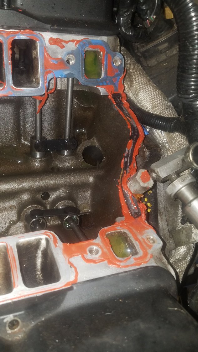

Okay okay before all of you get up in arms about this. I HAVE READ many of the post on Accel Superrams and all the airflow numbers for running on the track. Yet not many or any articles on using a superram on a daily driver.
As some of you know im putting a T56 in an 1990, picked up a two piece rear main engine with edelbrock heads, 1.6 roller rocker and a hot cam to put in it. I also by the stroke of luck stumbled across a Superram with the Accel intake, combined with 21lb injectors i figured it would be a great daily driver on the island.
While putting in oil, antifreeze in the new aluminum 4 core radiator,I heard the pitter patter of a leak....oh great...on further inspection. The leak is on the rear of the engine near the oil pressure sensor and distribitor. Radiator fluid dripped out. Great now I have to rip this superram back off, order gaskets and redo it all carefully again.
This intake is a pain to put on, so im wondering is it worth it for a daily driver or should i trade for something like a stealthram? She will drive about 40 island miles a day M-F once done and im not into racing her. Thanks for any inputs

Thanks everyone for your inputs. I took the intake off, down to the heads again, cleaning all the surfaces for new 1204 intake gaskets ordered and looking for SR gaskets. I may order a 30 x 30 piece of gasket material from grainger as I cant locate gaskets.
As for why i went with 21bs. It was recommended to upgrade from the original 19lbs to 21lbs Bosch ones with a new diaphragm in the fuel rail when the original went out (I didn't have the SR at that time)
For a tune, from my understanding there was a guy in island but he is out of business. I am looking into pcm tuning via a forum member and mail. I am always on the lookout for a new island contact, yet the aldl is older and was suggested a few time on island to drop the efi and go carb. For a drive by wire scenario.

Thanks to all. I know ill make alot of mistakes not being a complete gear head, yet thats how we learn on our toys. Lol
The reason im not doing a Dyno is I live in Hawaii and haven't found anyone who will dyno this old vette. I was told its too old from one shop and the one guy I knew who did moved to the big island.
Not sure why the intake leaked? Maybe I had a spot of oil or something under the rtv?
