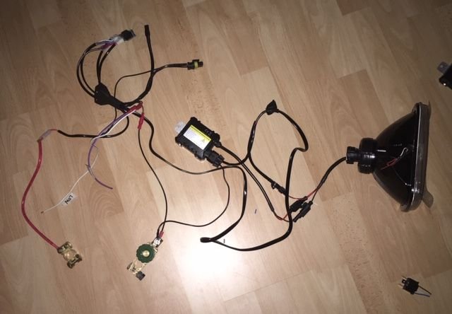

Well, now I have cut open the controller box and some cable isolation to make me some sense out of it. I will do some trial&error with a separate battery tomorrow. I will tell then if there will be light, if it exploded or whatever

... and there was light
It worked the way I figured it out, and looks not too bad.
In case one day somebody else wants to know how to connect this kit I will describe it here:
- there is one Red cable (with extra fuse) comming out of the controller box -> battery +
- there are two black cables comming out of the two HID ballast boxes -> ground
- and one three-wire connector with a brown / white / blue cable:
brown = ground
white = Low beam
blue = high beam
The three-wire connector is for the connectors on the headlights. Although it does not fit to my '88 C4, as she has connectors with round endings and the connector from the kit has flat endings. So I need to cut this off.
Another thing is that the car has one connector for each headlight. The Kit only has one connector for both headlights.
So I need to do one out of two or two out of one. That's a bit strange I think.
Now I just need to install the whole Kit to the car.
