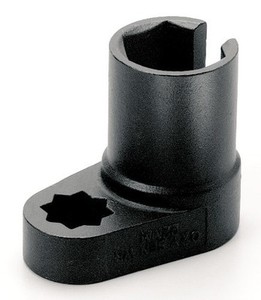

You will need either a 7/8" crowsfoot or a O2 sensor socket. You may need a long breaker bar to break it loose.

one of these thing?

Yes. That is 1 variation it should do the job.

This is another version:
O2 Socket @ Harbor Freight

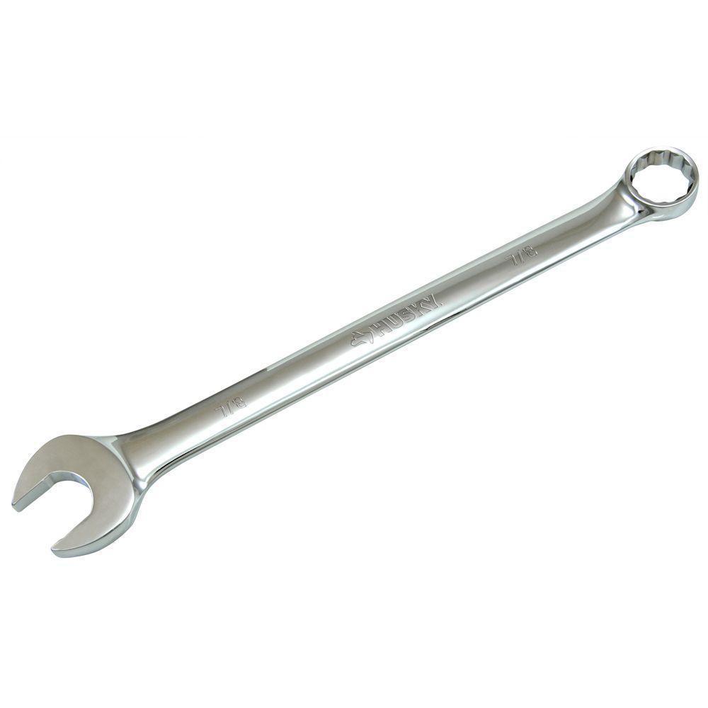

Simpler, most of us have one of these in the toolbox. Use the box end (box end only works on non heated sensors).
not sure how I can use them for the passenger side upstream one. I just don’t see how I can get it in there
